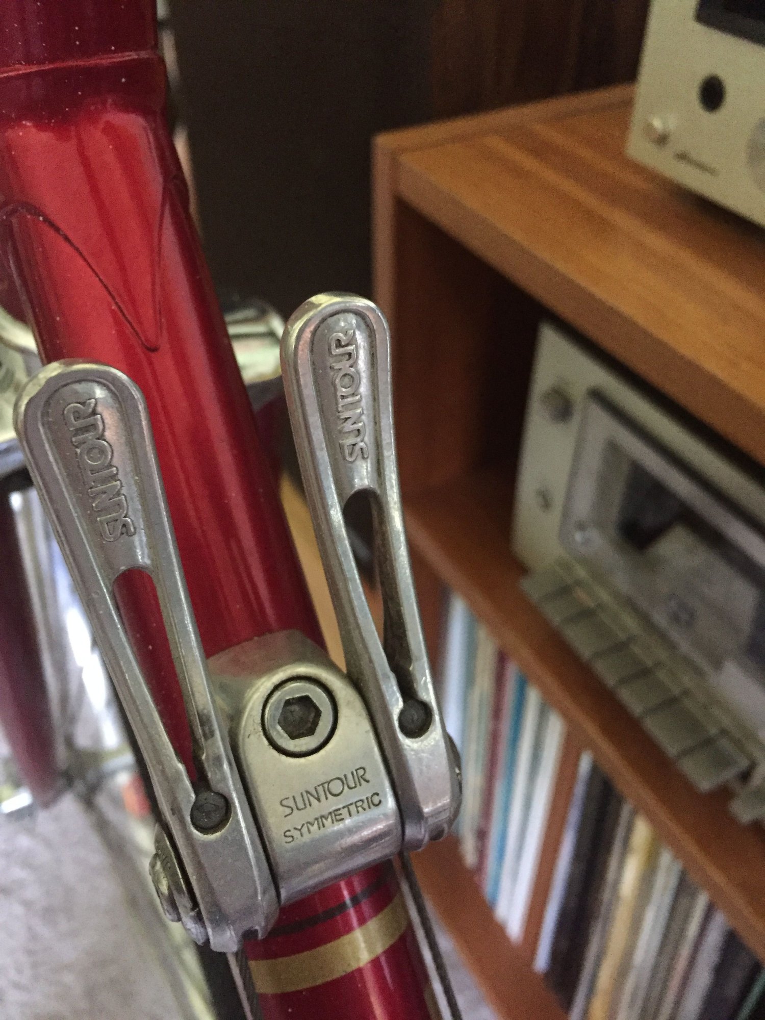

ABSOLUTELY!!! The lever is is the "OPEN" position which can only mean the the lever was used like a wrench to tighten the nut rather than the cam action as designed. Can't imagine mounting the wheel this way!!! Additionally, (and it might be just me but) I ALWAYS have the cam levers on the left hand side of the bike. I'm pretty sure that is the way they are designed to be used. When positioned on the "drive side" of the bike, there would be a tendency / possibility for something to catch the lever and release the cam! Losing a front wheel while riding never results in a good outcome.
I can't tell for sure from the photo but I'm wondering if that top mount SunTour friction shifter on the down tube is the "Symmetric" model? Interesting concept. I have one on a bike of mine of a similar vintage. I don't believe that I have it set up properly (yet) but I'm working on it.

here is a pic....

Those "Symmetric" shifters are interesting in that they automatically position the front derailleur (when set up properly) to keep the chain from touching the cage as the the rear derailleur moves the chain up or down the cogs on the freewheel! Whatever you do DON'T disassemble it unless you researched the proper reassembly instructions!!! Trust me, I know this from experience. As the old saying goes "good judgement comes from experience, experience comes from bad judgement"!
