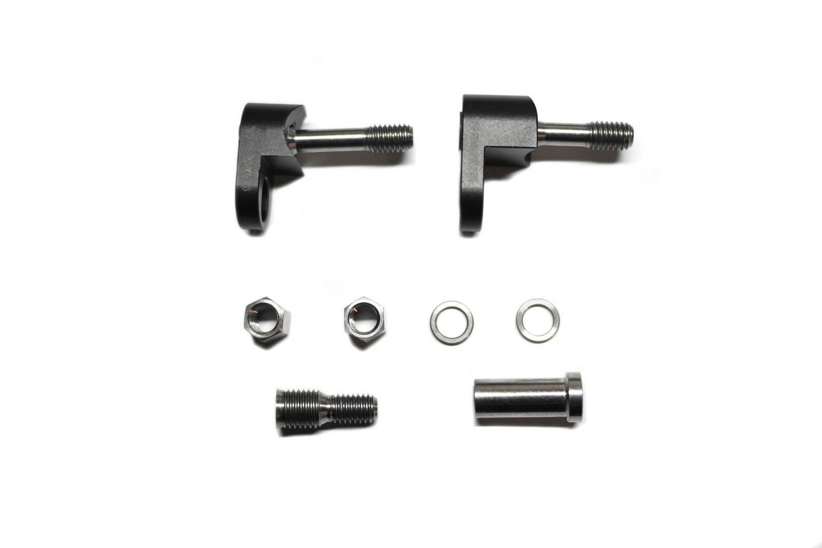

The Brompton is a medium reach o accept fenders and 35mm wide tires.
The second picture show clearly the adapter between the fork and the caliper that lower the caliper bold attachment.
Ti Parts Workshop propose this kind of adapter to mount eeBrakes on a Brompton but it can be used with other short reach calipers.
Yes, its a show stopper if you want a front block. For the eeBrakes, TPW has also a kit that moves the cable output from the top center to the bottom left.
eeBrake complete kit with bottom left cable output
Jipe is offline

Magura HS-11, HS-22 a d HS-33 has similar performance, the differences are the material they use and design of the lever. HS-33 has all metal design and looks sturdier than HS-11 with some plastic/resin material.
chikiball is offline
Old 12-08-20, 02:43 PM
Winfried
Winfried's Avatar
Location: Paris, France
Posts: 1,954
Quoted: 335 Post(s)
Liked 34 Times in 28 Posts
There are two issues:
  1. Finding a way to stick a Magura rim brake on a Brompton, either directly through the hole at the top (Magura HS33 R Urban), or through the use of a U plate (→ HS11 etc.)
  2. Getting the brake hose out of the way of the luggage block, or at least without interfering too much. I personally don't mind having to pay attention when pushing/pulling the bag so as not yank the hose if it means better brakes for not much money compared to the alternative$ (Cane Creek, Ridea).
