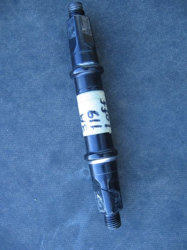

I'm curious what dimension didn't work using the "offset" Phill 113mm bb?
Did the chainring(s) contact the right chainstay?
Did the front derailer run out of travel in one direction or the other?
I was always troubled by the terms "offset" or "+Xmm" when describing spindles, because this is subject to imterpretation.
For example, offsetting a symmetric bb spindle 3mm makes the right end protrude 6mm further than the left end.
And saying "113 +3mm", does this mean that the spindle is 113mm symmetrical with an extra 3mm added to the right end for a total of 116mm?
Or does this mean a symmetrical 113mm bb that is then moved 3mm over toward the right?
Or does this possibly mean that the symmetrical 113mm spindle is actually moved over 1.5mm to make the right end protrude only 3mm further than the left end?
I have always measured and labeled bb's and spindles by measuring how much further that the right end protrudes than the left end, dividing this by two and calling the result the offset.
So, a 119mm spindle that is actually offset 1mm is described as such!
Like this broken one:
Thus the "offset" term refers to the cup spacer thickness I would use to similarly offset a symmetric 119mm spindle.
