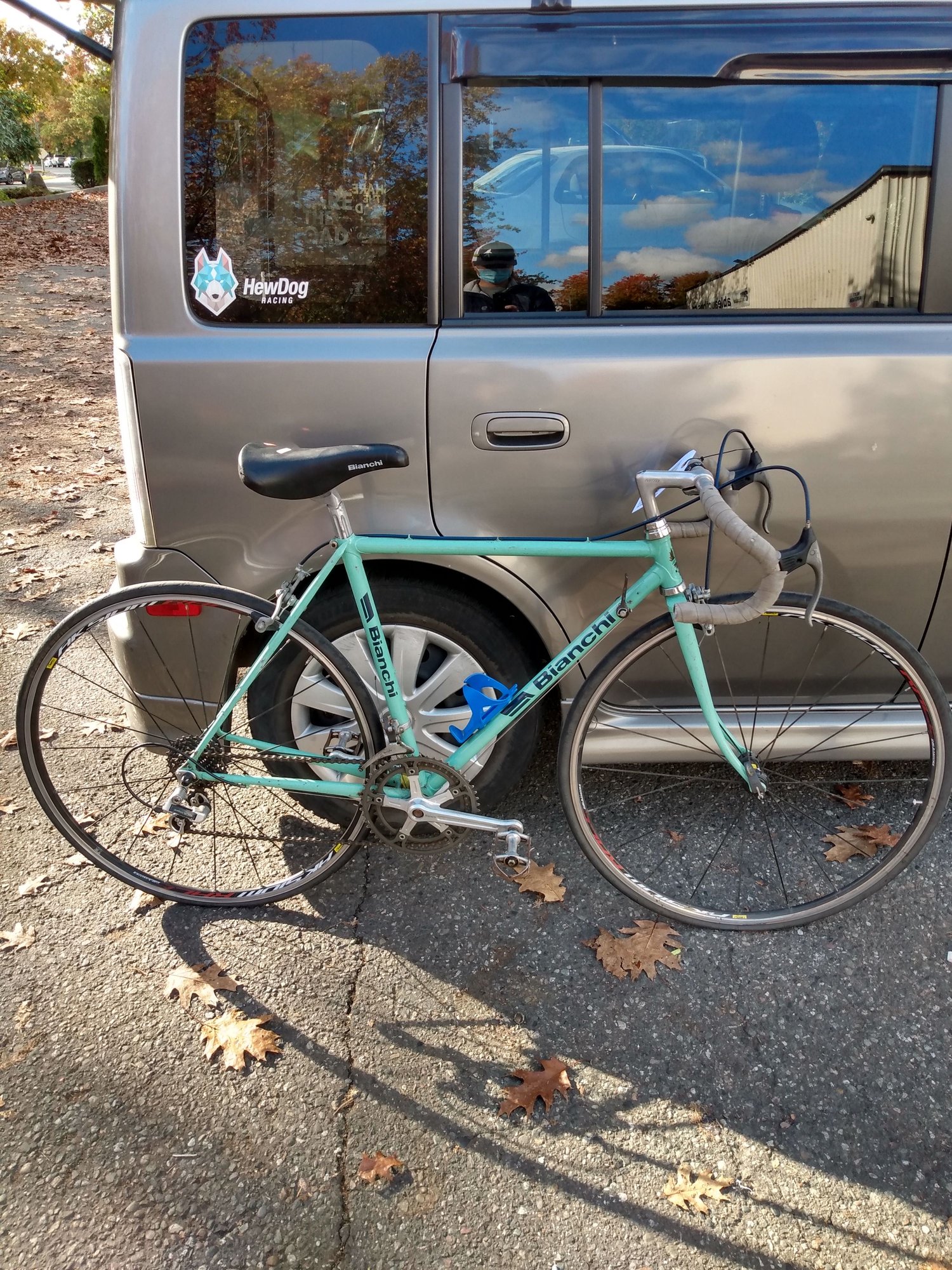

Here's another one for you to identify! Just picked up today, unfortunately a bit sun faded...but let's just call it patina.
56cm frame, has Made in Italy sticker, Modolo Quattro brake calipers, Premier derailleurs, Columbus stamped on the drop outs on the fork. Has modern wheels again, but 6spd on the rear.

Originally Posted by dcee604 View Post
Thank you T-Mar!
It's another 1987 Bianchenstein. This one appears to be the Canadian market Squadra.
Ah great! So that's what the sticker reads on the top tube! Thank you again. It is running decent as is, so will just probably ride it as is.

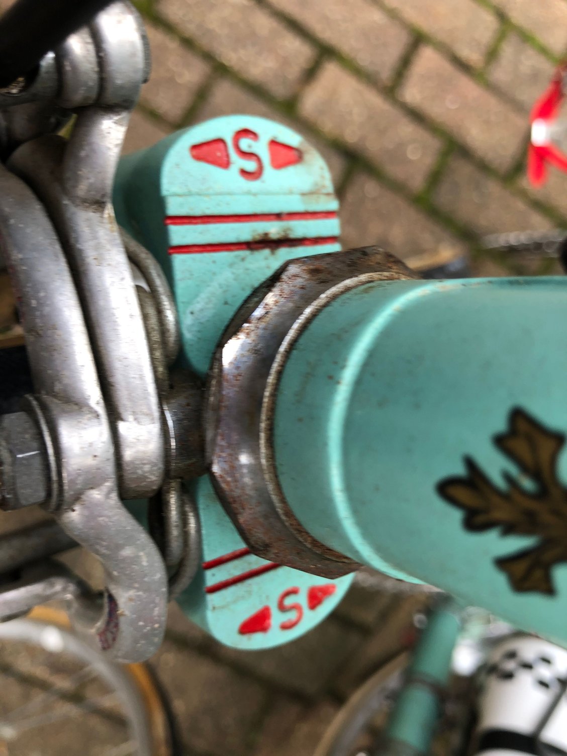

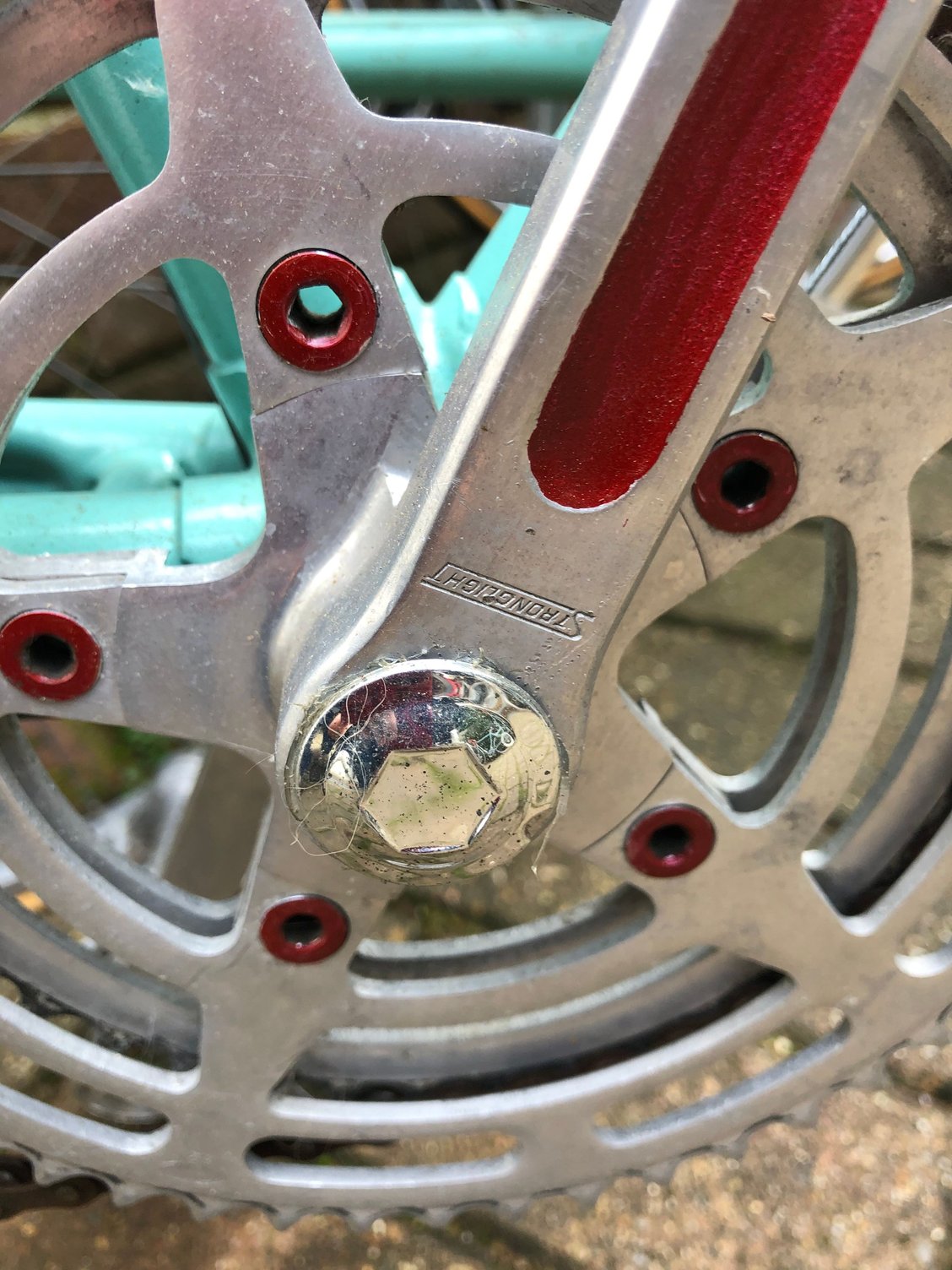

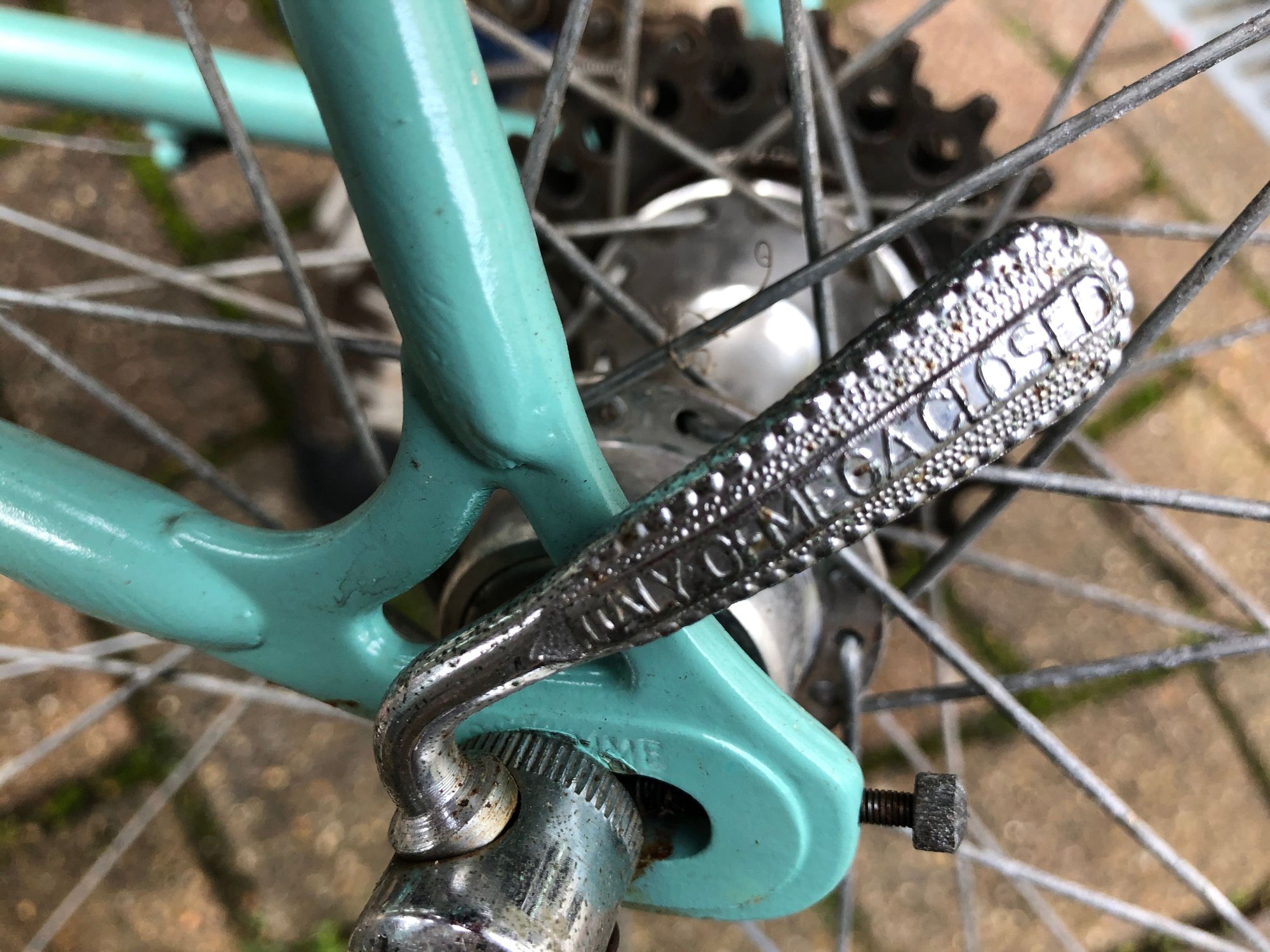

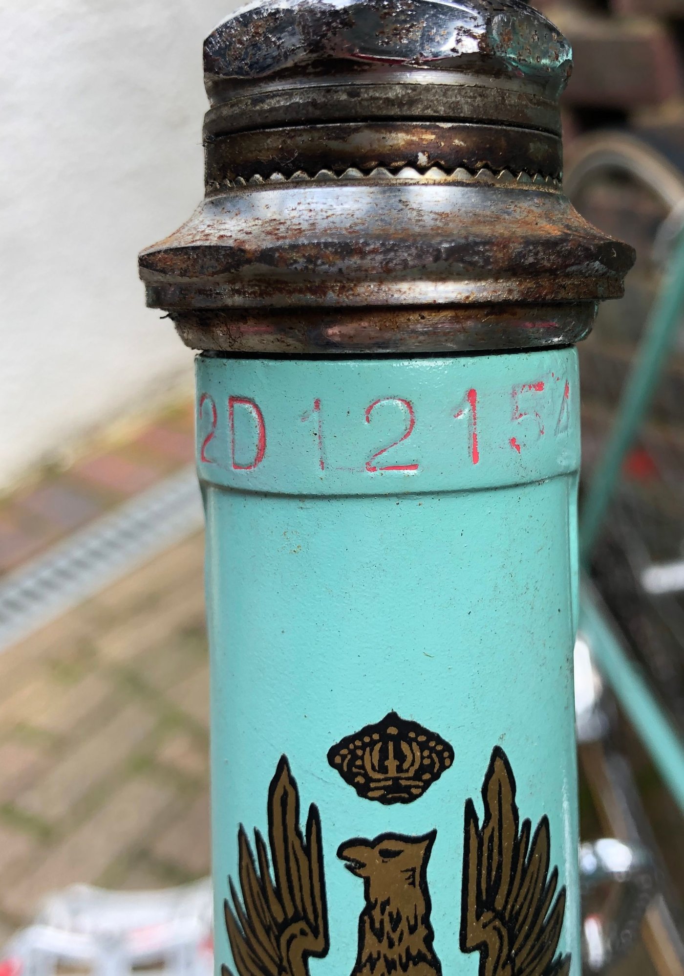

Unusual engraved Bianchi fork, 70s?
I recently viewed an old Bianchi which I think is probably from the 70s. Frame number is 2D12154, dropouts are Gipiemme and it has unusual fork-top engravings: an ‘S’ with arrowheads and 2 parallel lines. It also has a B in a circle engraved on the top of each seatstay. Rear derailleur is Nuovo Gran Sport, shifters are Campagnolo and crankset is Stronglight but I guess components could have changed over the years.
it has been ‘enthusiastically’ repainted at some point but really needs doing again.
Does anyone have an idea of what the bike might be or recognise the fork engraving? It has been suggested that it is a ‘Specialissima’ but I don’t know if that is accurate. Any thoughts anyone?
The subject bicycle is a 1982 European market model. It's definitely not a Specialissima, which would have used Campagnolo dropouts during this era. It's almost certainly mid-range, likely one of the many Rekord variants, The seat post diameter should give us an indicator of the tubeset, which I suspect is tretubi SL/SP at best, or possibly Aelle or even a Falck set.

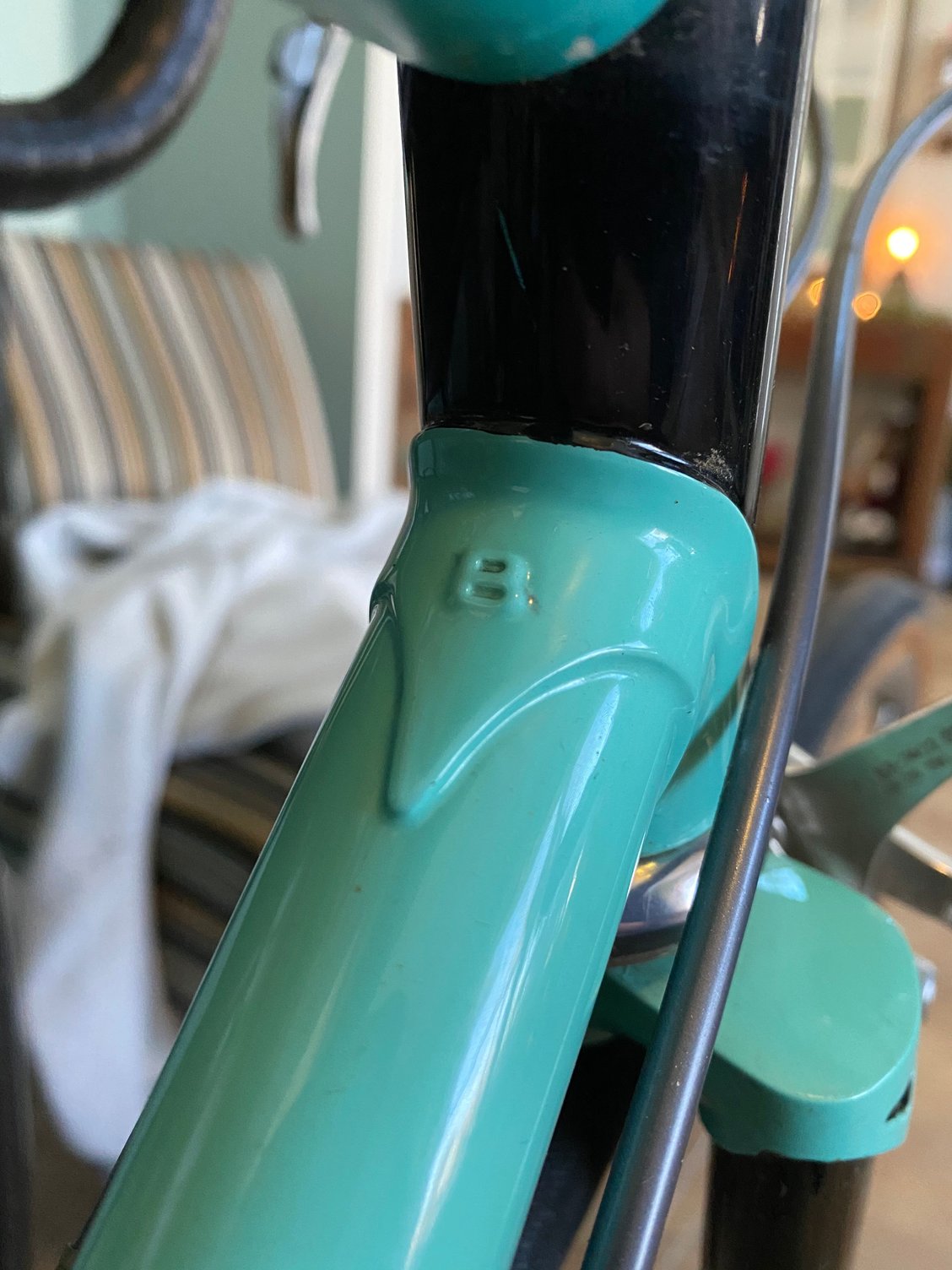

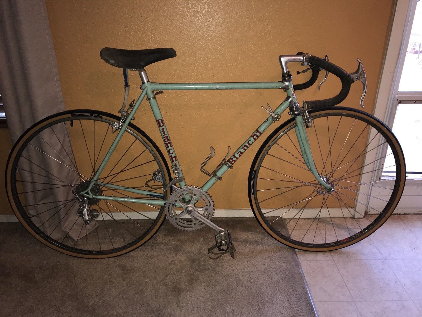

Any ideas on this model
Estate sale score, any ideas on model and year? Maybe 1985 based on serial number 27085. Painted by Spectrum cycles, maybe a repaint?

I am pretty sure it is a repaint. For an upper end frame I would expect to see something on the stay cap. That heavy grommet on the brake. bridge seems odd too. Is there anything on the dropouts? Is there a B on the lug?
drops
only B is on the HT/DT lug
