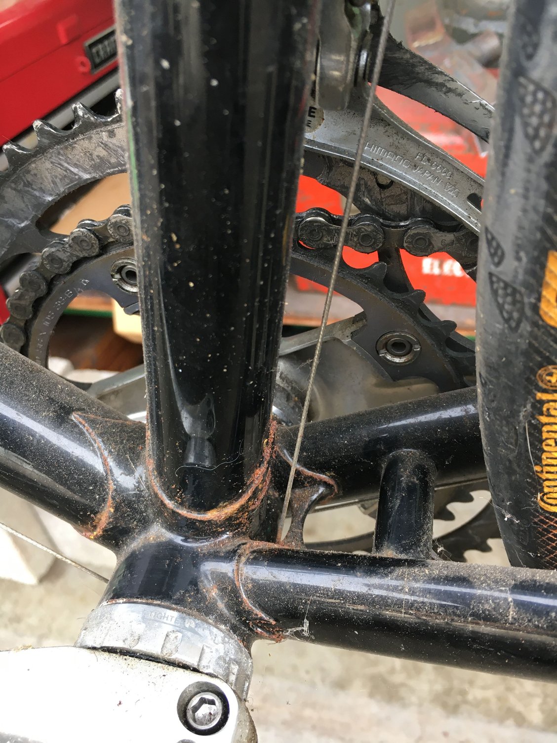

Here is one of the issues I have with my old frame. Rust, plus the chainstay bridge I will eliminate.

I don't think the rack is too low but that the stay mounts are poorly located WRT the brake. I see this all the time with production bikes (along with other common "braze on" placements that might work on the 58cm sized frame but not the 50cm one).
To the rust- is this a PC or a wet job? Rust like this, focused on the edges and corners of the surface of the frame, usually speaks to the exposure amount, the pre paint prep and the paint's chemistry and lay down. Andy

I had rust on one of my early frames just like the photo because I didn't soak all the flux off. In fact, I didn't soak the frame at all, just removed the flux on the outside using mechanical means. Flux is acid and needs to be removed.
It’s powdercoat Andy
I thought the same, though I did soak it quite a while after brazing. It seemed to me that the rust first appeared at the sharp outside corners of the lugs, so I thought it was due to too-thin powdercoating.

PC is essentially a plastic that has been melted over the frame. It has less attraction/bonding with the frame then a proper primer does. It doesn't like going around sharp edges. It is relatively porous to water (compared to wet paint). And it's an application that is built around it's low cost which, IMO, welcomes taking short cuts in the prep before powdering the frame. So no rust inhibiting (phosphate) treatment is not uncommon. I've even been asked if the job needed sandblasting first!
So when I see PC jobs with rust issues I am not surprised. Andy
That explains a lot Andy, thanks. Now that I’ve stripped it down to frame only, I see places where there are small wrinkles in the finish as if the film of PC has separated from the steel, appearing as wrinkles. Probably not the best choice to get it powdercoated again, but I would only be inclined to find a painter and pay the cost of a quality job if it were a new frame with nice crisp edges. Maybe I will find a new source for head lugs, head tubes and downtube and try again later.
