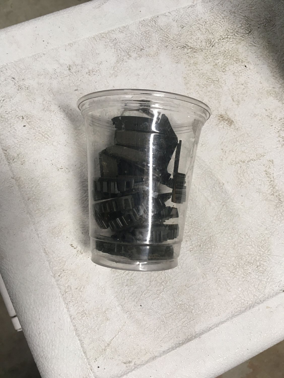

We have several bikes with disc brakes, but probably my main ride accounts for much of the consumption of pads and rotors. I reckon I have to replace a rotor after every fourth set of pads changed.
The cup below has 10 pairs of pads in it:
I've filled that cup at least twice before, since 2015.
I just bought two more sets of pads, at almost $25 a set. (Shimano JO3A). Previously, I bought a bunch of them at about $17/pair (Ben's), but try to find prices like that, now, with the current shortages (or shorting).
So, at $25/pair x 30 pairs = $750, and probably about another $375 in rotors, this is beginning to add up to a number greater than what many people pay for a reasonable bike. (Again, I got some of these pads a bit cheaper, but if today's pricing is the "new normal"...).
(I won't do the toilet paper calculation, but for a family of 5, it also adds up.)
I really prefer disc brakes, but this is a significant expense. If I had a bike shop maintain our brakes, we would really be feeling the squeeze.

How much do you weigh? what mileage are you riding? which type of pads? which weather?
On my old mountain bike with SLX brakes I replaced front pads every 1200 / 1500km aprox, and rear ones between 1800 / 2100km. I usually climb between 700 and 1200m for every 30km I cycle, so I do quite a bit of descending. I mostly used sintered and kevlar aftermarket pads (discobrakes) which lasted for a similar amount of time. Rotors (Avid G3) lasted for 18.000km before I replaced them, and I only did it because they were overheated and would no longer brake properly, as they still had enough thickness according to SRAM specifications.
On my current MTB with MT520 brakes and the stock organic pads I'm around 1000km mark and they're still ok. They're lasting more than on my old bike judging by the remaining thickness.
On my current road bike I'm around the 5000km mark and I'm on the 2nd set of front pads and the rears are still the stock ones with plenty of life remaining.
I don't think it's really that expensive provided you don't buy stock pads. IMHO discobrakes pads offer good stopping power, great life and are quite cheap. I usually buy them in packs of 4 as they're cheaper that way. In any case, it's true that they wear faster than rim brakes, but you never need to replace a worn rim, and braking is so much better it's totally worth it.
Probably 95 kg clothed.
Probably about 3000 miles/year, but lots of steep up/down. Shimano JO3A resin pads, currently, or their precursors. These do wear out faster than metallic ones. Fair weather (coastal central CA), on and off road.
I've almost always used the finned stock pads. The one time I tried a cheapo alternative, I went through them and trashed a rotor before I realized what happened.

There's something wrong there. You shouldn't be eating pads so fast, and definitely you shouldn't be trashing rotors at that rate while using organic pads.
Do you drag your brakes on descents?
I've only seen pads disintegrating that fast on Formula C1 brakes, but that brake was so bad at all levels that it shouldn't be called a brake at all.
Yes.
Lots of steep roads here, and I am scared of descending fast (getting old, previous broken ankle psyched me out, etc, but I have never been good on descents).
I'm checking out diskobrakes now, but the lack of fins has me worried (being a brake-dragger, brake fade is a worry.)

Then your problem could be related to lack of technique. You really shouldn't drag the brakes, it's bad for the pads, the rotors, and with adequate braking technique it shouldn't be necessary even to ride at a slow pace unless you're descending a 20% gradient.
I've used finned pads and non-finned pads without any noticeable difference. I currently use discobrakes kevlar pads on my road and mountain bikes with zero issues. In my opinion, fins are a gimmick. Lots of time ago I tried Clarks pads and they were crap (noisy, and lacked stopping power), so I've stuck with discos since then.

I get that I burn though pads more than most people, and that I am more cautious on descents. I am less clear why it is that this would account for anything more than a factor of 2 in pad/rotor consumption.
That depends on how cautious you are. Dragging the brakes from top to bottom is going to wear the brakes down faster than pulse braking would. I tend to let the bike run downhill, hit the brakes hard to scrub speed and then get off the brakes. Wash, rinse, repeat. For illustration, I did a ride last summer on Swan Mountain Road in Summit County, CO. It’s a very fast 2 mile downhill, dropping about 500 feet over two miles. It’s easy to hit 40 mph without trying. I even ran up on cars on the downhill which really slowed me down....damn it! I was riding with someone who is far less confident than I am and I had to wait at the bottom for about 10 minutes. It took me 3 minutes to get to the bottom (about) so my ride partner was riding the same distance over 13 minutes. 13 minutes of braking is going to wear much more pad material than approximately 30 seconds out of 3 minutes.

You should really try metallic pads, they should last significantly longer. The main disadvantage to metallic pads is that it takes some braking to get them warmed up for optimum braking. But dragging your brakes will generate plenty of heat so you won't really notice. Metallic pads also handle heat much better.

Maybe I should. The audio feedback might be enough to get me to feather the brakes more, or learn to stay off them completely.
They wear the rotor quicker. Impressive you kill J03A pads that fast....Shimano claims double the life of J02A.
I see no noticeable difference. I started with F01A in 2014, then J02A, then to J03A.
I have found the Ultegra splined rotors (160mm) with fins seem to last longer than my 6-bolt XT icetech rotors. But these are on two different wheel-sets that I use differently, so I haven't really been doing a proper controlled experiment. (The Ultegra rotors are on my mostly off-road wheelset, however.)
