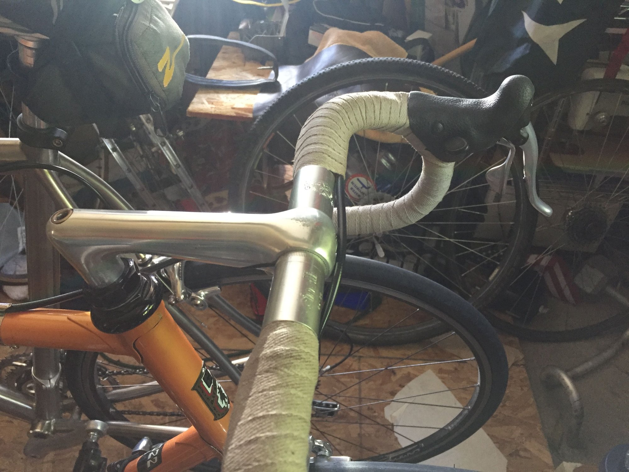

Very much like my two Nitto Technomic Deluxe stems and yes, definitely room to extend further. This is more about a desire to learn from other leggy folks who may or may not have found other non-custom frames with geo near the parameters above
