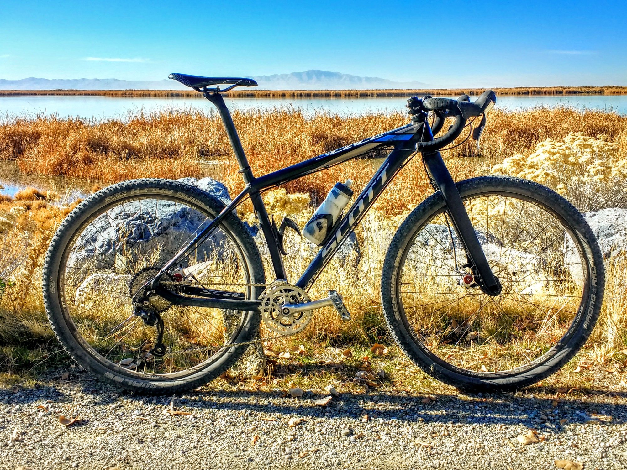

Here's a rigid 29er I'm happy with. The ETT is 30mm too long and the bars are 30mm too high because this crazy geometry is on all 29er frames, but it's acceptable. Built from a used frame with Chinese carbon parts.

Also, if the frame is too long AND too tall, you are just on the wrong sized frame.

All of the things you say you hate about that bike are there to support the features you've removed. What a strange case of willfulness you have.

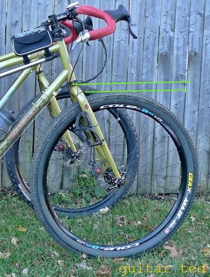

Here's the first generation in front of the second gen Fargo. With the first gen you at least had the option of buying a frame with a shorter headtube. In the later generations you only get too-high in every size. It's a bizarre geometry seemingly designed to frustrate anyone who rides in a lower position.
Here's the correct way to design a rigid 29er. This is a Kona Sutra LTD with its lower fork crown AND a shorter headtube. Congratulations to Kona for making the world's first sensible rigid 29er. For folks who like road bikes AND mountain bikes.
Likes For Clem von Jones:
Advanced Slacker
Join Date: Feb 2017
Posts: 6,210
Quoted: 2762 Post(s)
Liked 2,537 Times
1,433 Posts
Look at the head tubes on those Fargos. The one with the suspension corrected fork is much shorter..
That is what “suspension corrected” means..
You have to look at the hight of the fork plus the head tube length. You have only been looking at the fork length. This is why you are confused.
Also, you can’t go comparing head tube lengths of one bike to another (or anything really) unless you have bikes of the same size, and same fork length. And even then you are not taking into account BB height.
Forget the pictures, look at the actual geometry numbers.
Your frustration is not due to how bikes are designed, it is due to your profound lack of understanding of bike geometry. The fact that it is not obvious to you that you should be on a smaller sized frame is just one example of how clueless you are about any of this.

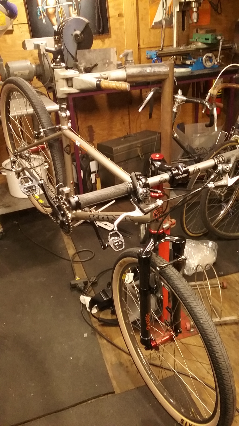

Another vote for vintage. Here is my current project, a 95 Kona Hot with 2x10.
