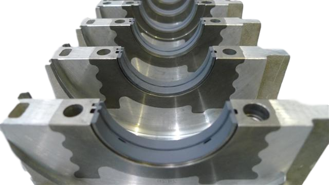

The bearings that the crankshaft rides on in your car do not move at all:
abshipp is online now

That's certainly a pretty good comparison to what I see here. But there isn't downward weight on the crankshaft - if it's in position it will spin freely within the shaft and is also continually lubricated. In the case of these pedals only one moving surface is being lubricated by the grease, instead of two (as with ball bearings as intermediaries). I can already tell the difference in the quality of rotation caused by the additional friction in this case. The design seems bad. I put a lot of grease on these pedals just last night and already I can stick them in position in the morning. I'm sure with a bit of rotation and heat they'll do better, but still...
Tell that to anyone who's ever sought 4-bolt main caps for the block, instead of the standard 2-bolt variety.

Sleeve bearings in a car are used because you have oil pressure. The concept, and it works, is that the oil replaces the ball bearing. In otherwords, there is a film of oil between the crank journal and the bearing. They don't touch. The only reason sleeve bearings wear out is that there isn't anything between them and the mating surface, like at the start of an engine prior to oil pressure building up. That is why an engine last longer (miles) in cars that are driven long distances vs in town driving with short distances. It's the start up that kills sleeve bearings.
Older cars have low oil pressure because the gap between the sleeve bearing and the mating surface is increased allowing the oil to flow through the surfaces faster. I have a Jeep that I replaced the sleeve bearings on just the connecting rods. Oil pressure went from 20 lbs to 55 lbs. If I had replaced the crank bearings, it would have returned to the normal 60 for a new engine. Of course there are other sleeve bearings in the engine like cam shaft bearings and valve stem bearings that operate on the same concepts.
WRT the pedals. Using a sleeve bearing is a way to save money and the part is disposable, a consumable part that is expected to be replaced.
Roller bearings are used in axles on cars because there isn't any oil pressure. There is oil to help with the lubricity for longer life. in the differential, the gears are lubricated with thick axle oil that has enough viscosity to become the film.
