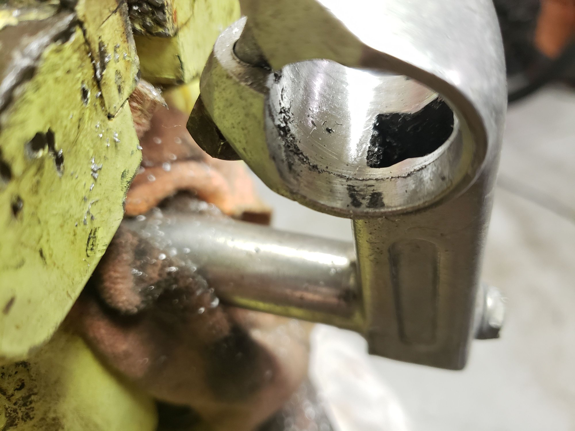

2. Is this stem safe? If so, which size of these bars should I be ordering, 22.2 or 23.8?

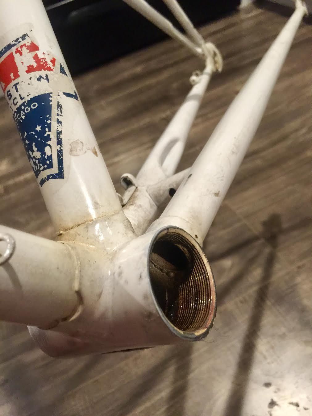

3. It did have a bottom bracket, but it was rough and needed to be removed by my local shop. They ended up needing to use heat to remove it, which discolored the edges of the frame in this area a little, which they told me would not have jeopardized the steel at all. What are your thoughts based on pictures below?

But before you go ordering VO Porteur bars, be aware that their 23.8 and 22.2 options refer to the diameter at the grips -- the diameter at the clamp for those bars is always 25.4, and that will be an issue for French stems which usually want 25.0mm and that'll be just the beginning of your French-specific odyssey...
You might consider finding some original French porteur bars (eg. the Belleri ones that VO used to sell NOS and inspired their version) and those will be 25.0 at the clamp, and 23.8 at the grips to accept the classic reverse brake levers.

Probably safe. Inspect carefully and measure the opening carefully with digital calipers for the correct size. The VO bars are very close to the originals in design.

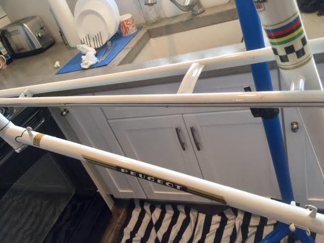

The paint is not bad at all, given the heating. No problem with the steel - it would have charred the paint off at a temperature affecting the steel's temper.

Go on EBay and buy a Stronglight TS crankset with a French threaded bottom bracket. This was OEM on some Peugeot mixtes. Check carefully that your pedals and crankset pedal drillings are French. You will likely need a special crank extractor to use on these. https://www.steintool.com/portfolio-...nk-extractors/ A modern 22 mm extractor will strip the threads of a TS and destroy the crankset.

For the stem, I sanded a 22.2 quill stem until it fit into my steerer tube. I didn't trust the original stem, and the material of the replacement stem is much thicker, even after sanding. SR also made a nice 22.0 quill stem. I have one on my Motobecane Grand Jubile.
The bottom bracket shell looks fine. Note that French threading is unique. With my bike, I found a steel cotterless crankset, with French bottom bracket, for a great price. You can either try to find a matching set like that, or get a French bottom bracket from Velo Orange.

+1 on @BFisher recommendations. Sanding down a 22.2 stem doesn't take all that long, eliminates any worry of "death stems" and means you have many options in bars and not just limited to what you can find on French Ebay. I have heard folks say on this forum that an Origin 8 classic stem will fit with no sanding but have not tried it myself. If you get a French bb from VO then you also have many options in cranks and thus pedals again not limiting you to French ebay the VO French BB has a JIS taper - works with most cranks.

Your only real issues will be a) French bottom bracket threading ( Velo Orange will have both a square shaft French threaded cotterless bottom bracket or a set designed to fit into the bottom bracket regardless of threading standard), and b), the frames Metric tubing diameters for a front derailleur or down tube cable stop. These can be adressed by altering the front derailleur's opening with a half round file. Any cable stop or derailleur band will usually"self modify" when installed.

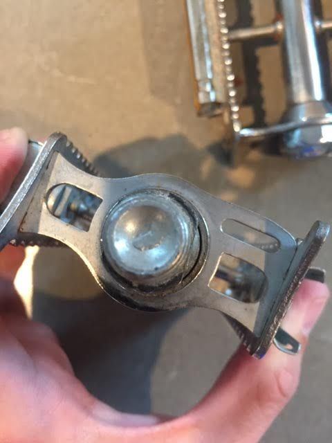

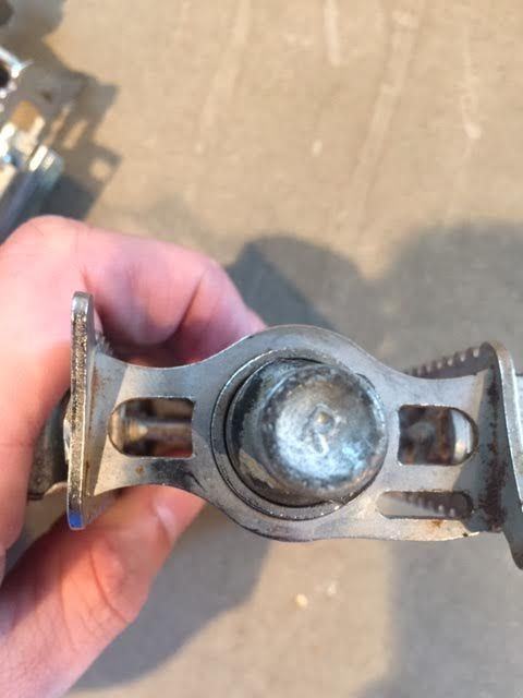

Really great advice, thank you! How do I know if the pedals and crankset pedal drillings are french? The pedals I have are the ones that originally came on this Peugeot, FWIW. And if I purchase the Stronglight TS crankset and rings, aren't I good to go with the pedals?

A small update, but today I did a quick wash, polish and wax on the frame just to see what I'm working with and for some inspiration. The paint really came back to life and I got a nice shine out of it. Forks up next while I start debating what to order first, bars, wheels or BB/crankset.

Cleaned up very nicely!

Are there any markings on the pedals or the pedal spindle? That might indicate whether they are French or not. Judging by the date of the bike it's most likely French threaded pedals and bottom bracket. If in doubt or just to be sure before ordering other things for it online, I'd take the frame and pedal or crank arm to a bike shop and have them ascertain which threading they have.

Do you have a normal crankarm you could CAREFULLY try threading the pedals onto those crankarms. Those pedals just might be normal threading and not French threading. Most French threaded pedals have the letters for French left and right on them.
