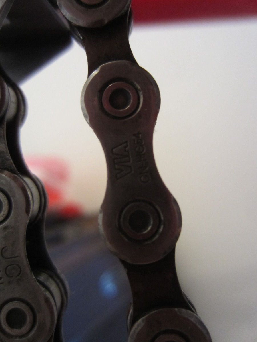

How about some additional data like miles ridden, chain replacements, race/hard Training, indoors only or fast recreational use? Andy
The previous owner had it since 2010 (original bought it in 2007). From what he said, he is not a racer, maybe the original owner who had it some three years may have been. I gathered he is fairly accomplished hobby rider, he said due to some hips problems, he stopped using the bike and in his place he had several nice but only recreational like bikes for family outing like. In the selling note, he said,
Only ridden maybe once every couple of weeks in good weather. The wheels and cassette never saw outside use and the rear was only used on my trainer with my road bike. Chain replaced last year.
I don't really have any definite reason to disbelieve what is claimed. I had the impression of honest dealing. The BB is original and I am sure still ride-able, I figured to replace it to start on new leg with the bike. From the looks of it, I have the impression the bike was serviced in a bike shop, by which I mean everything properly greased and tightened and ship shape, so to speak. It feels like I got what I was buying.
The chain marks like you say, are from shifting under the load. Not my style, I don't ride that hard or without regard for chain. The owner didn't look like a brute, just average build, 5.10"
Wheels and the cassette do look newish, chain I have doubts about but could be new last year as claimed, I am no expert to judge chain. I just noticed when closely examining that it has beginnings of rust or what looks like it. But that could be due to standing in garage this whole winter (was long to sell, also you don't bike in winter as a rule anyway). Didn't clean it yet because still waiting for chain tool pliers to come in mail. Just surface wiped it a bit to stop getting dirty whenever I touched it. I suppose I should have ordered a chain gauge for checking chain length, never worried about it on my own bike.

Those chainrings do not look bad at all. I think some of the 'wear' you pictured was actually manufactured tooth profiles to help with shipping. There are a few gouges and nicks, but nothing that should require replacement.
Generally speaking, when chainrings are work the teeth get a asymmetrical profile when viewed from the side, and yours does not as far as I can see.
As for the chain, you cannot see chain wear - the wear happens inside the links where the pins meet the bushings. You can detect wear by measuring a length of chain - put a ruler up against the chain when it is mounted on the bike (big chainring and small cog put the chain in the easiest position for access), and measure the distance from the edge of one pin to the edge of the pin 24 links away. The measurement should be exactly 12" and any amount over that is caused by wear. If 24 links are 12 1/16" or less then you can probably just replace the chain and keep riding. If the chain is worn more than 1/16th of an inch over 24 links, then it is likely the rear cogs have worn to match the wear in the chain and replacing the chain will result in skipping under load.
Chainrings usually last longer than chains and cassettes, so it is common to replace several chains and even cassettes before you have to replace a chainring.

That chain needs a serious cleaning if it isn't stretched out. I doubt you can tell the difference of 2.5mm in the cranks. But I would replace the BB and put it together as is and see what you got before I started throwing parts at it that you might not need. Good luck,

How has this not been mentioned? Grab the chain at around the 2 o'clock position on the chainring, and try to pull it away from the ring. You should only be able to lift it a tiny amount, if at all. My big ring is so worn, if I pull up on the chain in that way, the whole chain slides off the chainring. Most of what I'm seeing on that ring doesn't look like wear, but damage. Mine has ~9,000 miles or so, looks better than the one in the OP, and is still worn out-- not shark toothed yet, but worn enough to make some krrkrrkrrkrr noises (similar to a chain rubbing against the FD cage) under power (chain slipping on the teeth.)

I measured it as advised above, 12" on 24 links, also did full length measurement, 4x24 links when it was strung out on a table (I have 105 in total), in which case I would measure the stretch even easier, and it is like new. After all, it is a TT bike and where I got it, was flat country and the guy was no pro, and likely didn't specialize in sprinting either, so the chain was just dirty. I also looked around to buy a new chain but then I was glad I didn't have to, since shopping for a chain is a meh experience. I mean if I was to settle for some 'equivalent' cheap chain, then OK, also if I wanted to pay $60 and up, also OK. Still, this particular chain seems not to be on the market, the HGX, at least not in quite a few places I searched.
Anyway, I gave it a good cleaning, several baths in paint solvent while shaking it in a plastic jar, then another one or two in methyl hydrate and after a week of drying out, I put a drip of that wax in solution on each roller from both sides, then covered all side plates on both sides, including the narrower connections, so it is thoroughly waxed and ready for new life.
