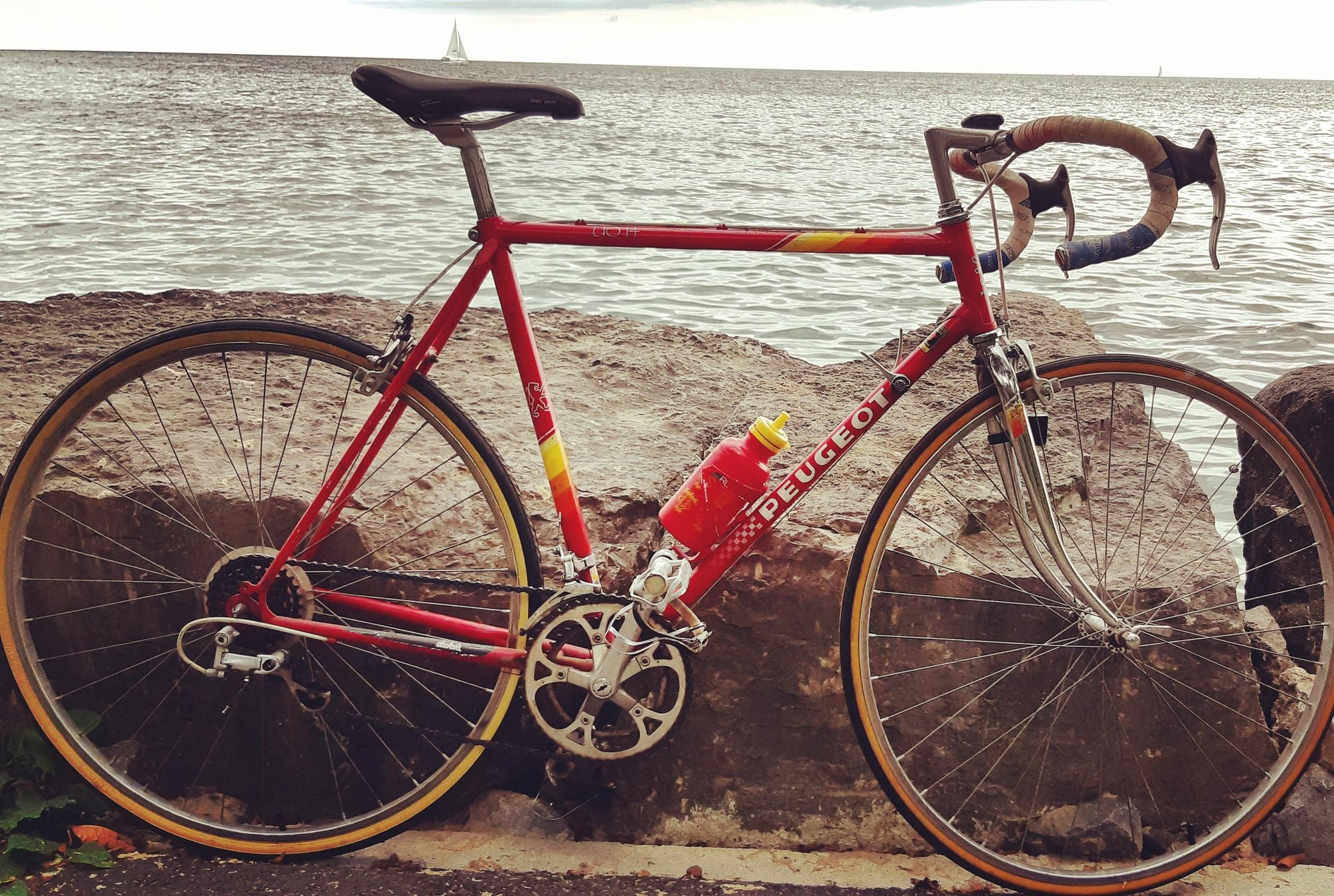

Originally Posted by gthomson View Post
thank you bikemig that's great information. I've been reading Sheldon Brown and looking at YouTube videos so have a better idea of what to expect. The bike is a UO14 which I read a while back was made in Canada mid-80's so hoping the components are pretty standard. I don't have any of the tools to remove the freewheel or chain cutters so will have get those or.
Will I need spacers to fit the wheel and new freewheel to fit the frame? I just checked and on the current wheel roughly 127 mm's? The hub on the rear wheel is about 50 mm?
The bike below is a completely different bike than the UO14 in the brochure I posted earlier....

Looks like there is at least 4mm of room to adjust the brake pads down in the slots. 700c is an option.
This should be double checked with actual measurement obviously.

gthomson , are you sure the bike in the photo you posted has 27" wheels? If yes, they may not be original. That bike looks like it had 700C wheels because it's a later model than the one in the brochure.
You also have more than enough room in the caplipers to drop the pads for 700C
