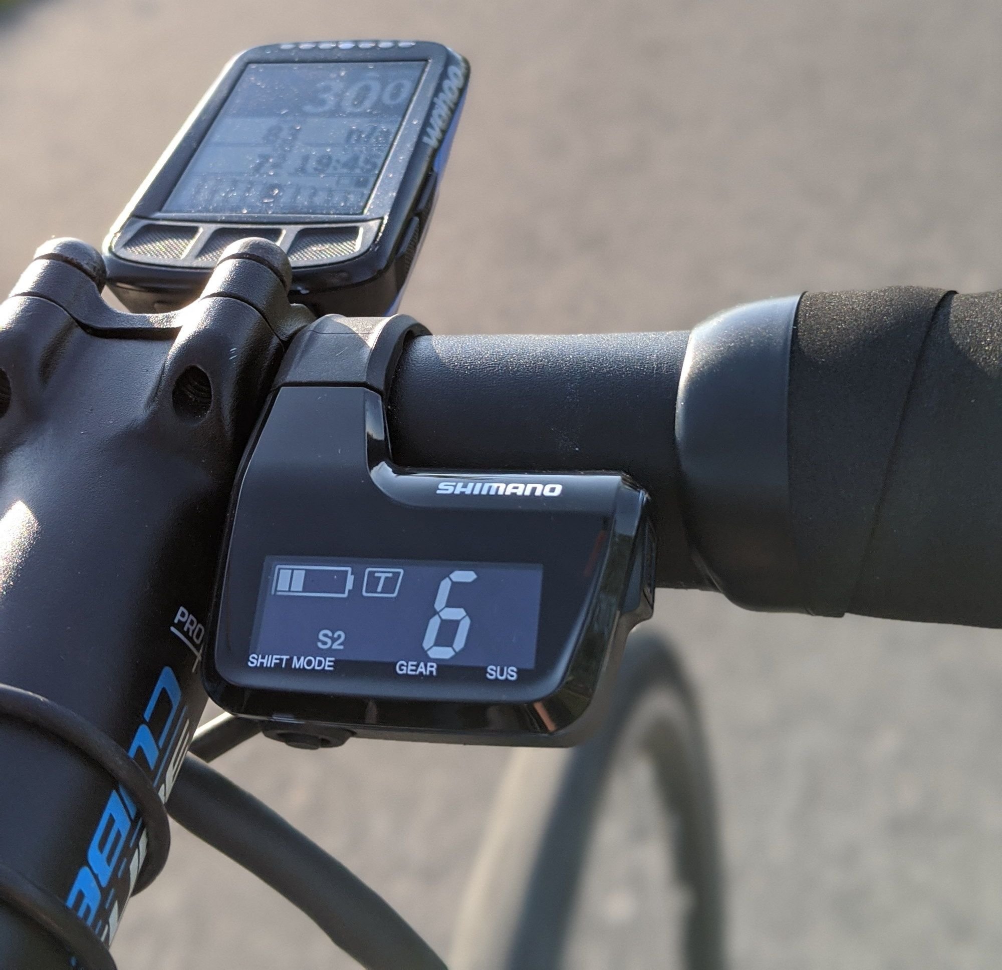

See my post above. If you have the shop install the XT display, in place of the A Junction and wireless unit, not only do you save $85, but the display unit shows you what gears you are in, and that's actually more useful then you can imagine, but you also get a battery level display. Only downside is it takes up some space on the handlebar.
https://bike.shimano.com/en-US/produ.../SC-MT800.html
I think the SC-MT800 is OK. I have one on my road bike right now, bought that to help someone who had problems installing theirs.
What it does nicely is beep one gear before the front derailleur shifts automatically (full-synchro mode). It also beeps when you're at either end of the cassette, indicating that there is no more gears for you to shift .
The default "display time" of 5 seconds is a bit short - basically the display switches off after five seconds of 'inactivity', and only turns back on when you press a shifter button (or the button on the display). So while it does display the current gear, I never look at that because well.. the display is either always switched off or I have shifted less than 5 seconds ago
I do like the button - I find it easier to change shift mode on this than on my SM-EW90-A.
There is an EW-RS910 bar-end junction in the shed, I'll install that on my new frame next month.. This SC-MT800 will probably stay on the older / second bike, because I only have one EW-WU111. I do prefer the EW-WU111 on my main bike, it just looks a bit cleaner (if you hide it in either handlebars/frame - while not supported by Shimano it usually works just fine).
And yeah.. once you get past the EW-WU111 initial firmware update it should work just fine. Like others have said, just don't forget to "disconnect" the app .
There are units out there with updated firmware on them as far as I know, but also plenty with the original firmware.

Originally Posted by TerryDi2C View Post
I
Yes, noticed that about the time out. I’ll have to check to see if there’s an “always on” setting, that would be more useful as you want to know before the shift what cog you’re on. At least on a road bike maybe. I get this gear display on my Garmin, it’s really really useful.
