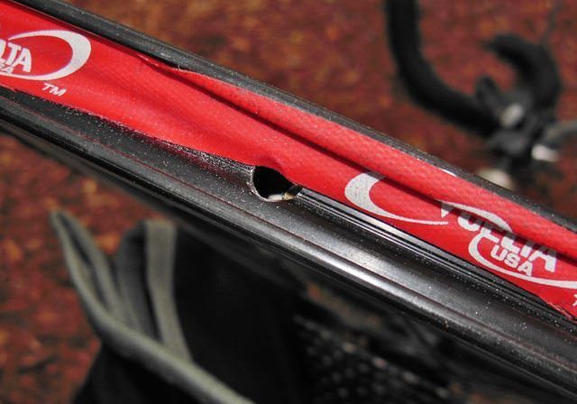

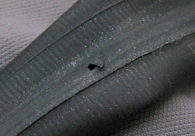

Got Flat Tire Twice a Day riding my bike
It has been chaotic guys I thought I was losing my mind.. Since I had the wheels (used ones off ebay) and new tires installed I've been getting flats once or twice a day... Flat on the way to work and another flat on the way home. This has repeated pretty often even going out to the store... I got flats so many times I had to keep buying spare tubes all the time. There were a few times I had to walk push my bike home because I ran out of spare tube and the flat tire patch kit wouldn't work.. both the glueless and traditional patch are worthless as the bonding is too weak... there were times I had multiple punctures at a time too.
The cost of having to keep buying spare tubes negated the savings on buying a set of used wheels for my bike. By the way flats was only happening on the rear and not the front.
A week ago I finally decided to take the plunge by taking the tire off the wheel and inspect.... I felt like I was a detective. I found out that the rim tape inside the wheel was not covering all of the spoke holes....the tape job was a mess. I wasn't sure if this was the cause for having flats... I checked on google and it says you "will" get flat if those spoke holes are exposed. I didn't have a rim tape so I used the duct tape, cut out in small square or rectangular shape to patch these holes... After I have finished I put on my fresh spare tube and pumped up air... been riding my bike and haven't got any flats since then. I recently got me a bike cargo trailer and one of the wheels kept losing air...eventually flat. That wheel also had spoke holes not properly covered by the rim tape too so I patched thst up as well. The tube near the valve was starting to crack also. Just giving you guys heads up to inspect your wheels for spoke hole exposure... they can be very destructive and make your life unpleasant.

I take the tire off the rim and inspect inside my wheel every time I get a flat...

I always take the tire off the rim when I get a flat, even if I'm repairing the flat roadside. You need to do this to make sure there isn't anything inside the tire that's puncturing the tube, not just the rime. An example that happens to people a lot is the very thin metal wire that ends up on the road after a car tire bursts. That can work its way into your bike tire and really not be visible from the outside of the tire. Small sharp pieces of glass can do this as well.

Also, top tip: after finding the puncture in the tube, figure out where the hole is in relation to the tire and rim so you can focus on that area specifically to find any sharp edges or foreign debris that could have caused the flat. In your case, the punctures being on the inside of the tube as oppose to the outside part which contacts the tread of the tire, would be a dead give-away that there was a problem on the rim side.

If you're looking for something sharp poking through the inside of the tire, use your glove to find it not your finger. It's hard to make a bandage stick to a sweaty fingertip.

Or as many do, carry a cotton ball in your tool kit. The cotton fibers will catch on just about anything.

if you know exactly what caused the flat & the precise location of the puncture, like a thumbtack, you don't even have to take the wheel off the bike! but if you do, you can just ease the tube out the side to work on it
but yeah, rim tape ... you have my sympathies!

Ugh. When I was new I got 3 flats in an hour and it never occurred to me to look at the rim strip. Very frustrating, but a valuable lesson learned.

If the holes are on the outside edge of the tube (where the tire tread is) you should remove the tire. To make inspection easy, invert it (turn it inside out). This stretches any hole out and makes it easier to see. And a cotton ball rubbed around the thing will snag on a piece of wire or glass. If you have this in the tire, you have to remove it.

Same problem I had when I bought my new bike a few years ago. The cheap rim tape they used at the factory just barely covered the spoke holes, and I got a few flats from the tube pushing into the holes and rubbing on the sharp edges. Bought a couple of rolls of rim tape, installed it, and haven't had a problem since. I do agree with google, you WILL get a flat if the tube comes into contact with those spoke holes.
Best bet would have been to get some regular rim tape since it's a lot stiffer than duct tape. The duct tape will eventually fail. But, failing that, it would have been better to cut a long strip of tape and go all the way around the rim and completely cover all the holes. I have a feeling you'll eventually be suffering more flat tires as soon as those patches you made start wearing through and the tube starts rubbing on the edges of the holes again.
