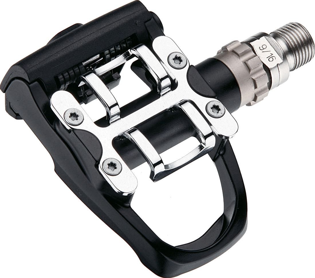

Agree, I think the VP is the best off the shelf design at the moment. In my experience, they are basically just like LOOK Keo low-mid level pedals, maybe bearings and materials a little nicer, but basic pedal design. The bearings do develop a little play, but not excessive, and the price is right as well. Recommended.
Now that I've moved within 45min of Milton, I've been seriously considering getting them, as staying with my current SPD-R set up means altering soles, custom shoes, or making shoes. I really like the idea of making my own set, and have the means and knowledge to do so, it's just whether or not I want to devote the time to tinkering with it. I have narrow feet, with a narrow heel and moderately high arches, so finding shoes that fit well is always a pain. It will still be a few months before I am able to devote any time to riding outside of the house, so I have some time to decide. It's just weighing whether I want to stick with what I consider the best pedal system for sprinting, and dealing with the hassles from time to time, or modernizing my set up and be able to use current equipment. I have enough gear to outfit 4 bikes, so the inventory is there for me to use, it's just dealing with shoes going forward.

This is another example of Track getting hand-me-down tech from the Road world where we have very specific (and somewhat easy to solve) needs that we will pay to have met.
This is an opportunity for some pedal company.
This is a great start, but it's still a relatively minor adaptation to the standard Road pedal.
What if a Track pedal were designed from the ground up?
I honestly wouldn't change anything about this design except for maybe bearings and offering multiple spindle lengths. It is a relatively ground-up design in that the pedal body itself, as well as the clasp are designed and manufactured from the start to accept straps. It solves the strap problem without altering or adding to the pedal. Fact is, the way the pedal is made, in no way harms its function, but improves it as soon as straps are added, as per the design, and as per out wants and needs. It ticks all the boxes that trackies want and need with absolutely no detriments.
The SPD-R were almost the perfect track pedal in my opinion, Solid metal to metal interface, no chance of breaking a cleat, and strong enough to adapt straps securely. People dropped them when SPD-SL came out. Many were saying (I believe you included) that having the wider/solid platform was a help, from a propriocetive standpoint. So if a wider platform was needed, then SL solved that. All that was needed was a good retention system. One that was strong and adaptable/accepting for straps. If a company like VP can do it, why can't Shimano or LOOK? Because there's no money in it. They already have the lion's share of the high end pedal market, and they're not losing it.
VP comes up with a pedal that was designed for track right from the ground up, and barely anyone buys it. The clasp AND pedal body are slotted to accept straps, single or double. I remember when they first came out years ago, 2011 I think, yet how many people do you see using them? I know of two people who actually own them. How many people are using strap hacks on SL pedals, or LOOKS? I bet you that there are more hacks than VPs. People like us keep saying that we want these track specific products, yet no one goes out and buys them when they hit the market. What message does that send to the manufacturers? If enough people started to buy the VP pedals, you can bet your ass that Shimano and LOOK will offer something. Why? Because they are losing market share.
You want track stuff, buy track stuff when it comes available. If people keep adapting and hacking stuff, then manufacturers have no incentive to make what we want. Why? Because people are still buying their product and it costs them no extra time or money for us to change their product. They are out nothing and we're still buying their product. Buy track stuff, and Shimano and LOOK and will lose out on product and will try to reclaim that market. It's not the offerings that are the problem, it's the consumers.
