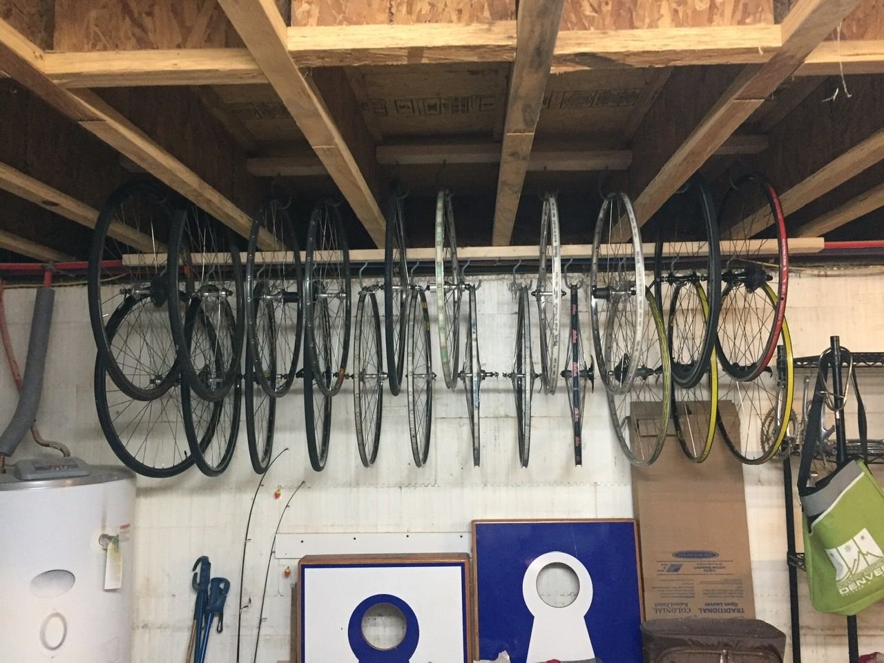

Made some progress on organizing the shop
Got some of the wheels up off the ground.

But still have more work to do ....

The never ending battle.

Well done. Step by step gets things done.

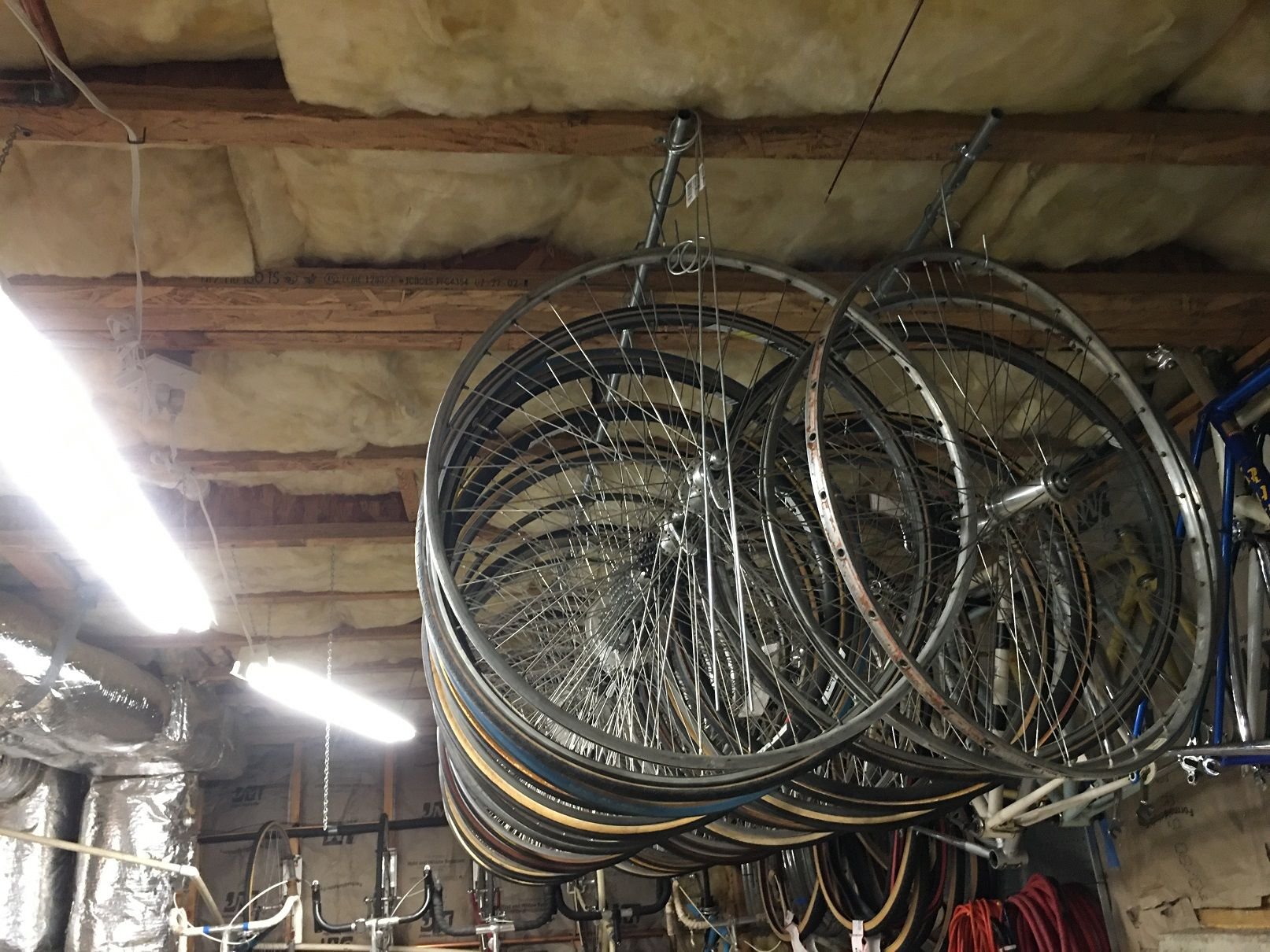

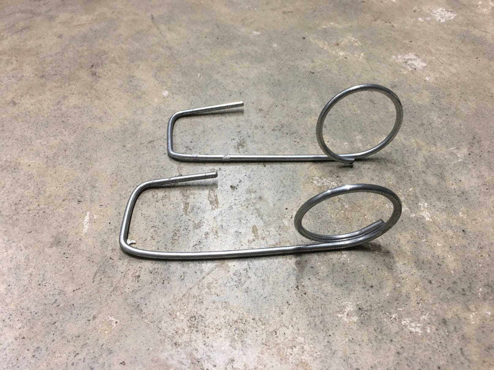

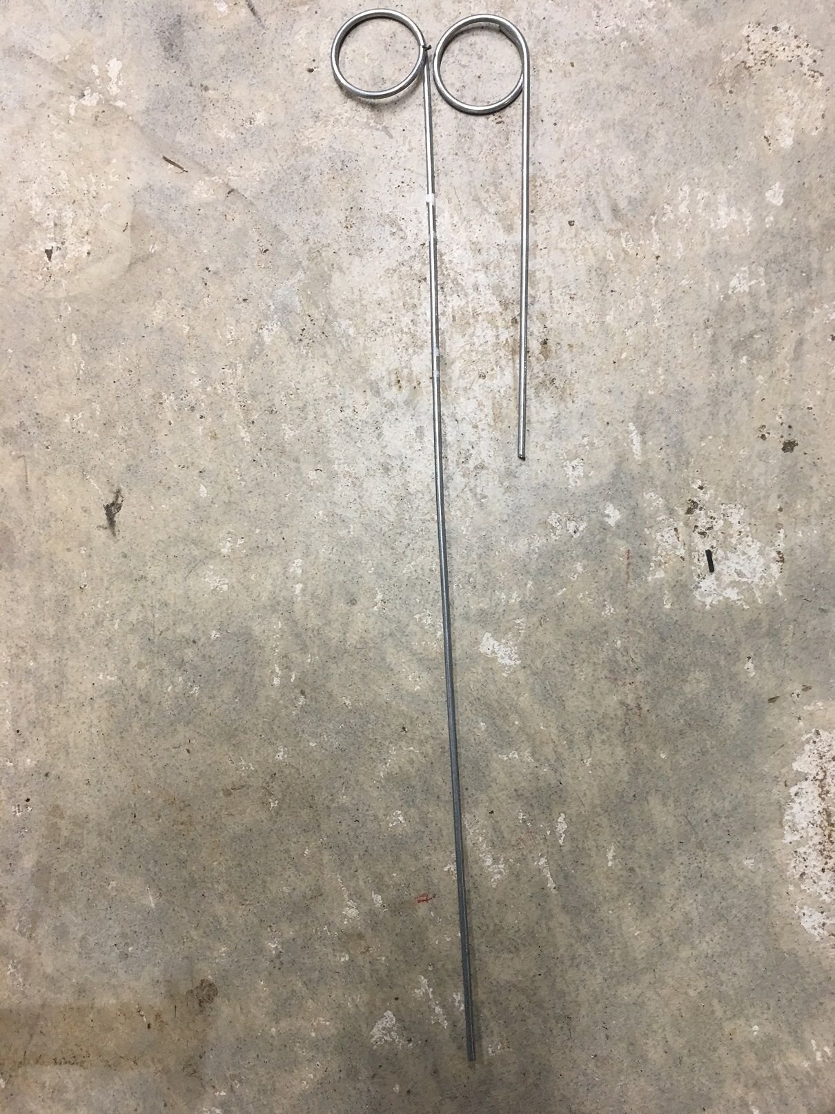

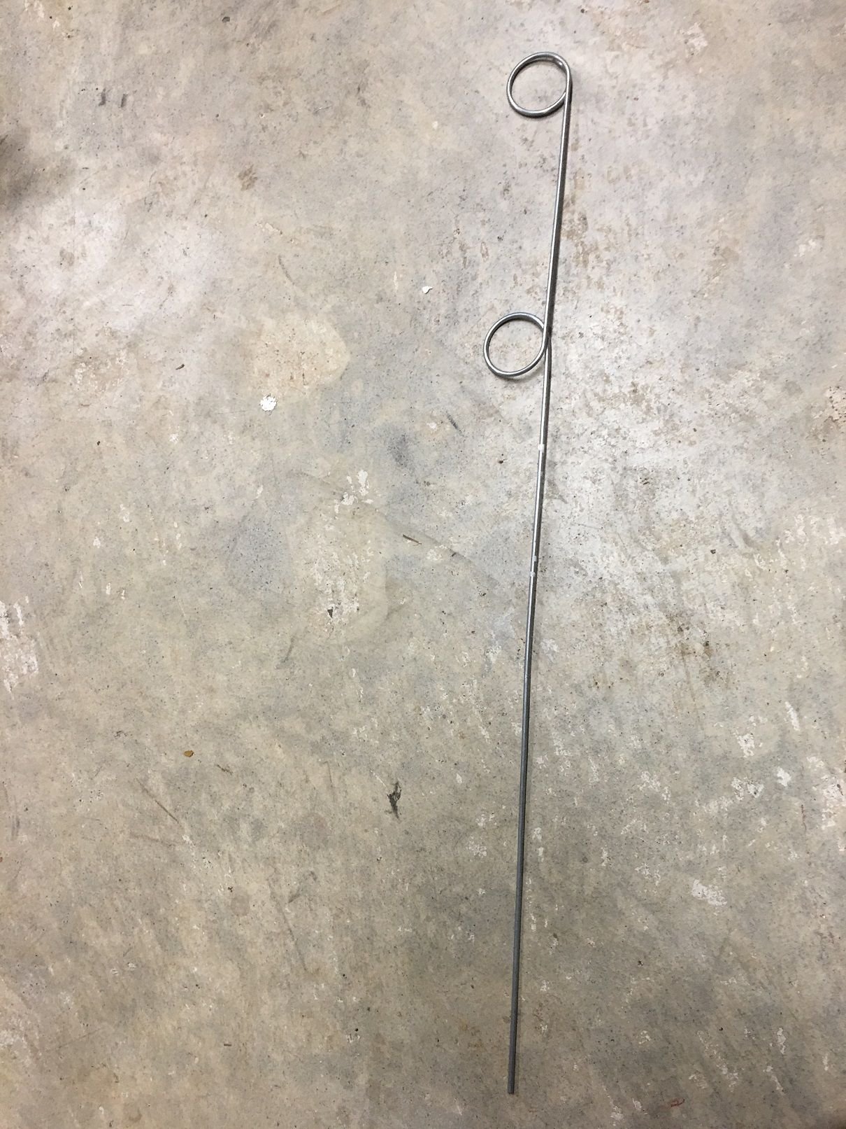

I made something similar but used 1/2" conduit. Clamped two runs in parallel offset by about 12-14". Home Depot and Ace Hardware both have "sign hangers" for around a buck a piece you can modify in half, then bend to hang pairs of wheels. Just cut in half above the middle loop, then bend to offset. Here are some pics to explain. First, the whole hanger, the halved hanger, the bent hangers. $1 per pair of wheels was a good cost to benefit compromise for me. Then the conduit running parallel and some wheels hung.

I like that idea francophile.
Im thinking about how to do a second row in front of this one with the wheels staggered and hung up higher, suspended between the floor joists. Maybe some iron pipe run through them with your hangers might be the solution.

Yeah, without having I-beams or joists with gaps, my idea of using conduit won't work unless you were to using (at least) strategically placed shims or furring strips to act as a standoff.
I won't lie though, the conduit idea was from someone else here. I just stumbled upon the "sign hangers" at the store and realized the loop part would hang perfectly on conduit. Just needed to bend the correct way to support a wheel.
Using the parallel runs allows an offset so you can pack in denser. I aimed for 13" between the conduit runs if memory serves correctly, this puts the QR or axle holes just shy of the next rim's edge. You could do the same with another 2x4 a foot away, then stagger hooks in between the other 2x4's hooks.
Sad part about this is, even with this, I can store a good 40 wheels and still have another 10-15 pairs on the floor.

Coat hanger wire. Or old galvanized spokes; plenty stiff.

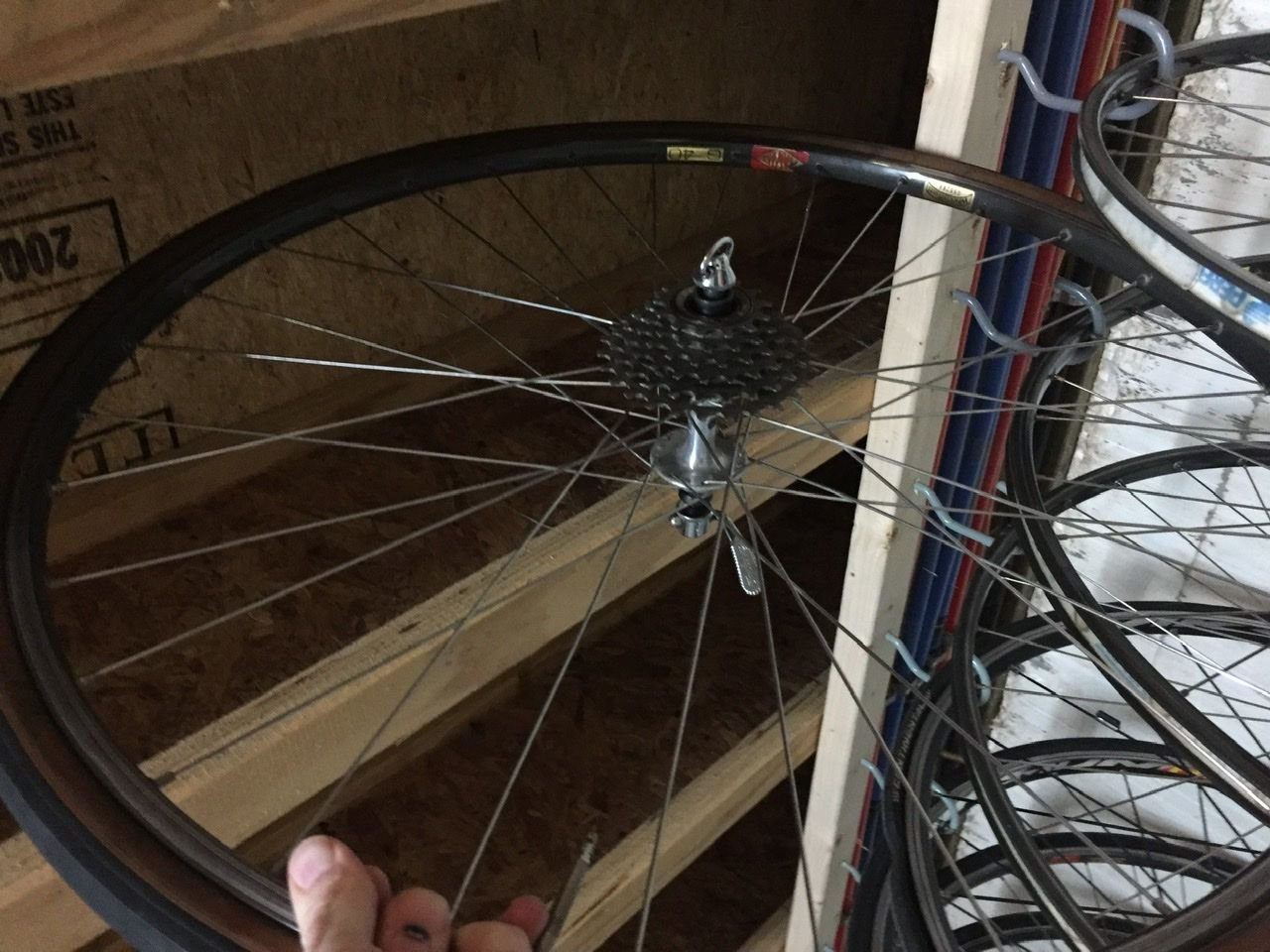

Well on further reflection, it will be a major engineering challenge to work iron pipe up into the position I need. I think what I’m going to do is Fix short sections of 2x4 horizontally, screwed end on into the vertical joists, about 8” higher than the current 2x3. Same hook idea and the wheel will rest against that 2x3. I’ll have to stagger each one a little to be able to place the screws but I think it will look good.

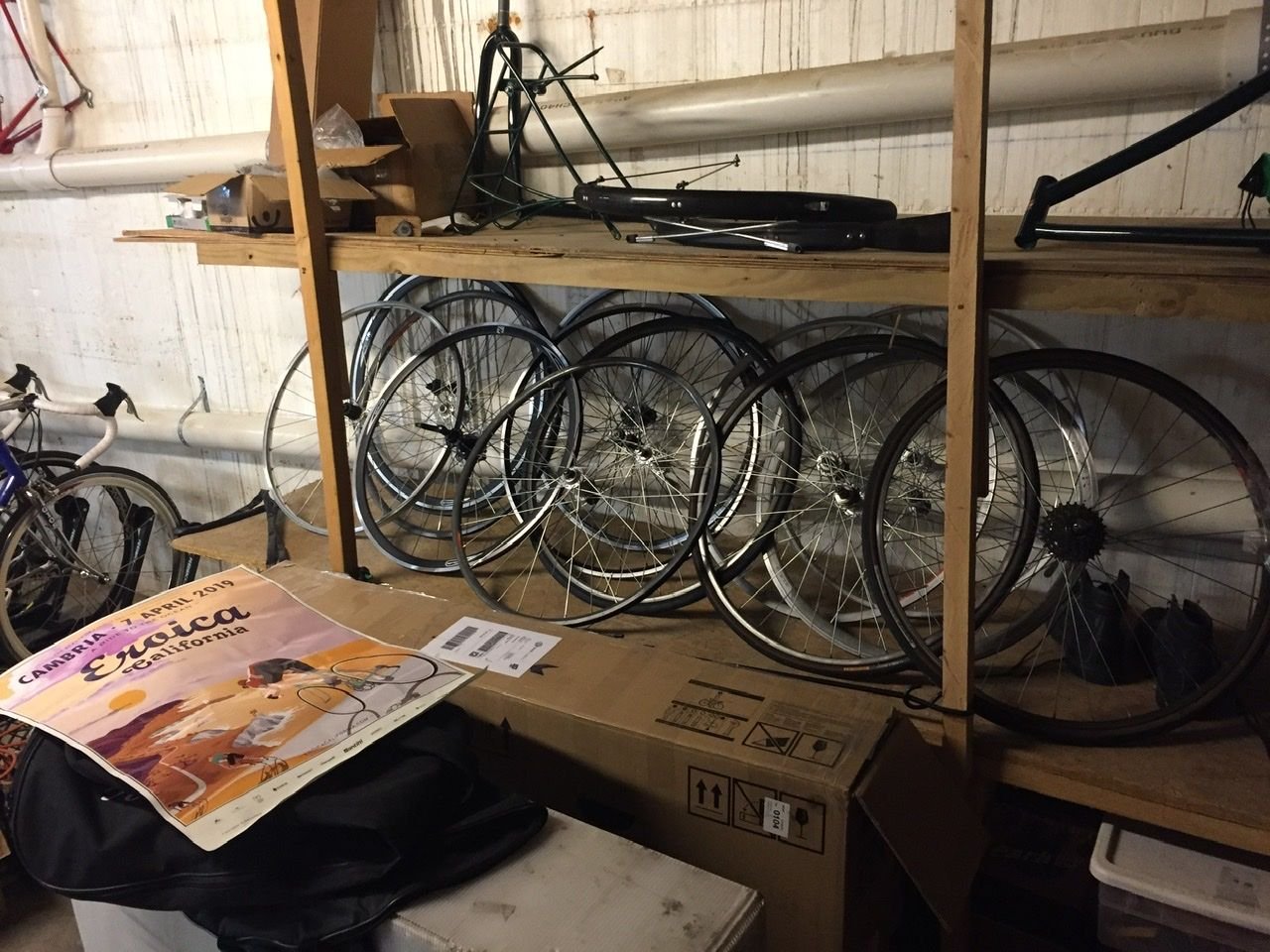

The game is plenty popular in my area... with "Beavis & Butthead" and "Office Space" in mind, I call it "bags" whenever possible.
P.S. Nice work on organizing your wheels, @Spaghetti Legs. I don't have a large collection of spare wheels, but I could stand to organize them better.

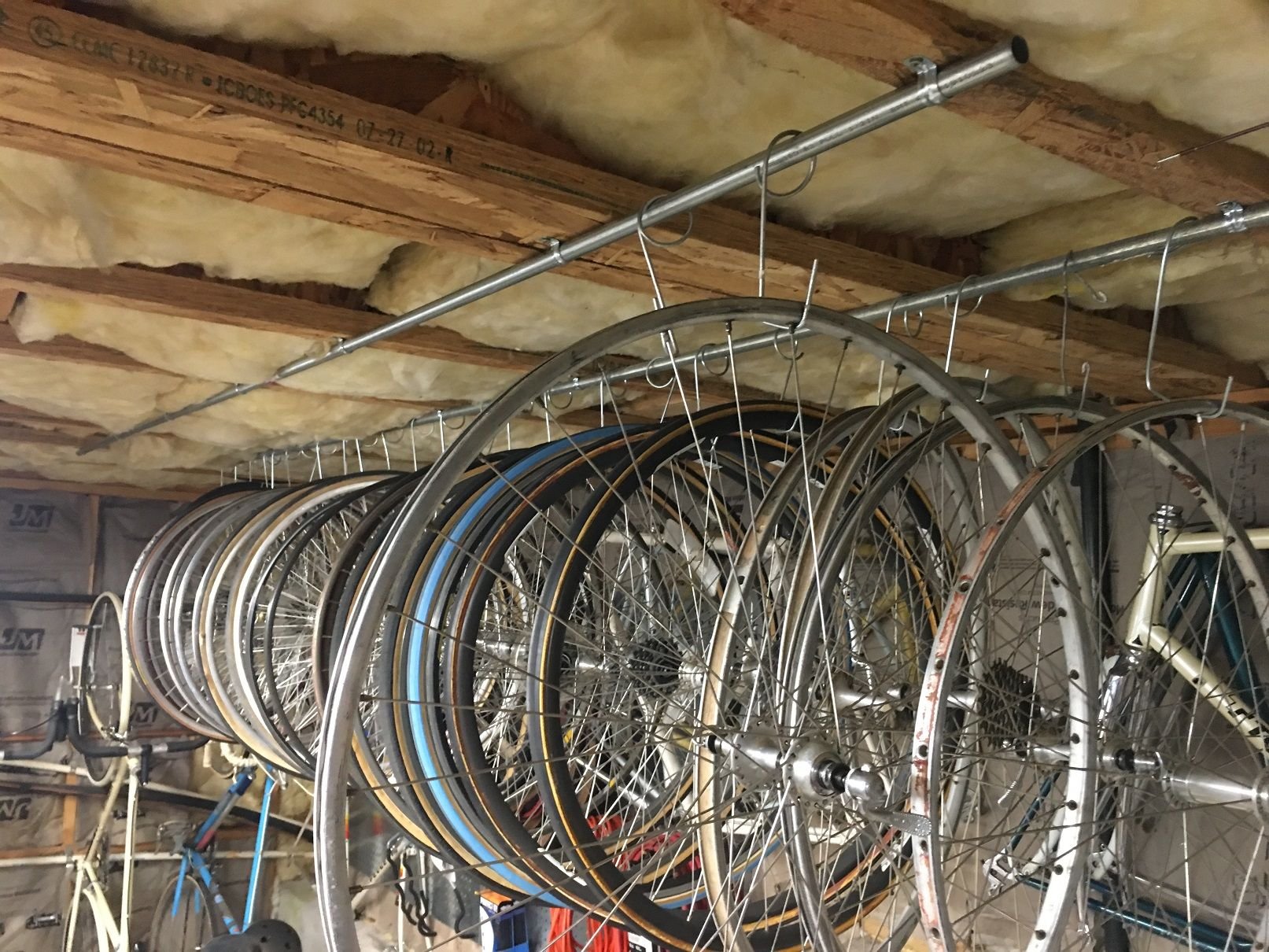

Because my pics above sucked, here are two more showing what I'm doing. Better shows the conduit and the basic clamps. And a fingertip, because I've had a bad day.

Who needs iron pipe? I just used the cheapie conduit. You could easily use PVC. Strength isn't imperative.

Mission Complete
.. for now.
After my next build is done (Heron Randonneur) I’ll have one road and two MTB wheels homeless.
Now what to do with the bikes ...
