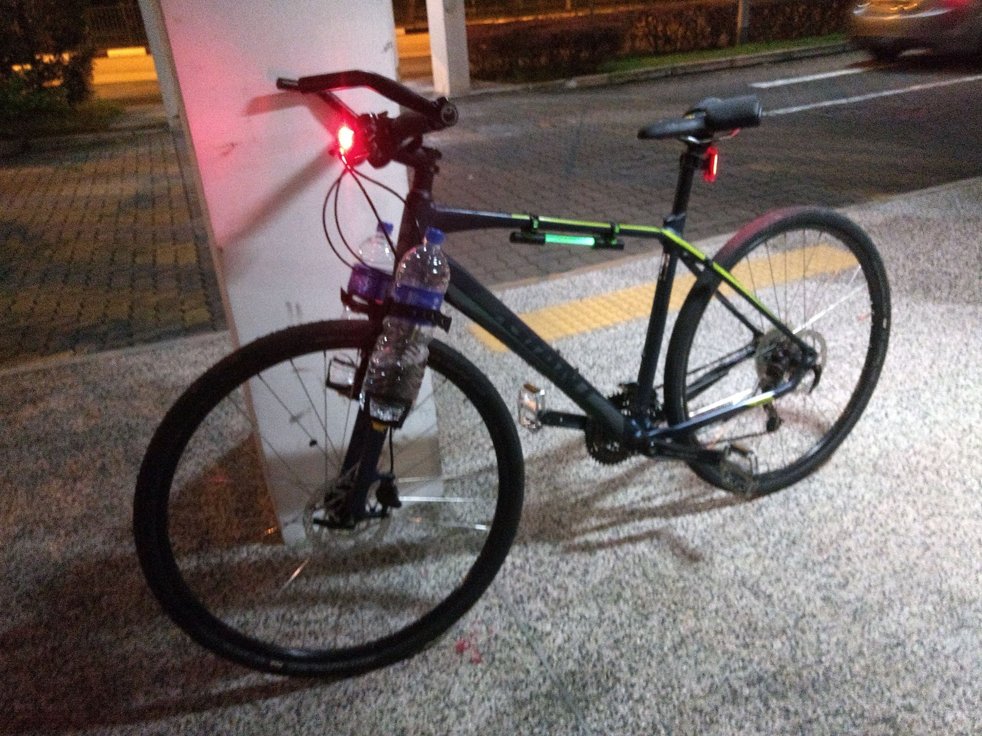

I just picked up a lightly used Fibre Flare light at USD $ 7.50. it's the green light. This pic was just for myself, at the seller's unit, so I haven't taken any time to position the bike or search for good lighting. These Origin 8 bar ends are a bit thin for me, but inserting foam over them didn't feel comfortable. These bar ends were good for moving my hands forward, when I wanted to cycle faster.
Trying out attaching ToPeak bottle cages attached to front fork with SKS Anywhere attachments. When they work they're ok, but the 1 or the 3 pairs of SKS Anywhere's I bought don't work now. You can see different bar ends too. These are comfortable for putting my hands on the ends of the handlebars, but aren't good for getting leverage . Can see the 700 x 38 Schwalbe G-one's too.
Yes, the Colonal is right- it's the eyelet he described. I was going to get this nice Racktime front rack, but no can do now- I've ordered the Racktime Add-it rear rack- weighs 770gms, weight limit of 30kg, which is far better than the 20-25kg limit many other racks have, especially at this price. The order includes a pair of G-one 700 x 2.00 and SQ Lab 711 grips. In the main frame triangle, I've managed to jam 2 x 1.5L water bottles in (not in these pics).

My Toughroad with XT 1x11 drivetrain. Its fast, comfortable, and looks awesome!
