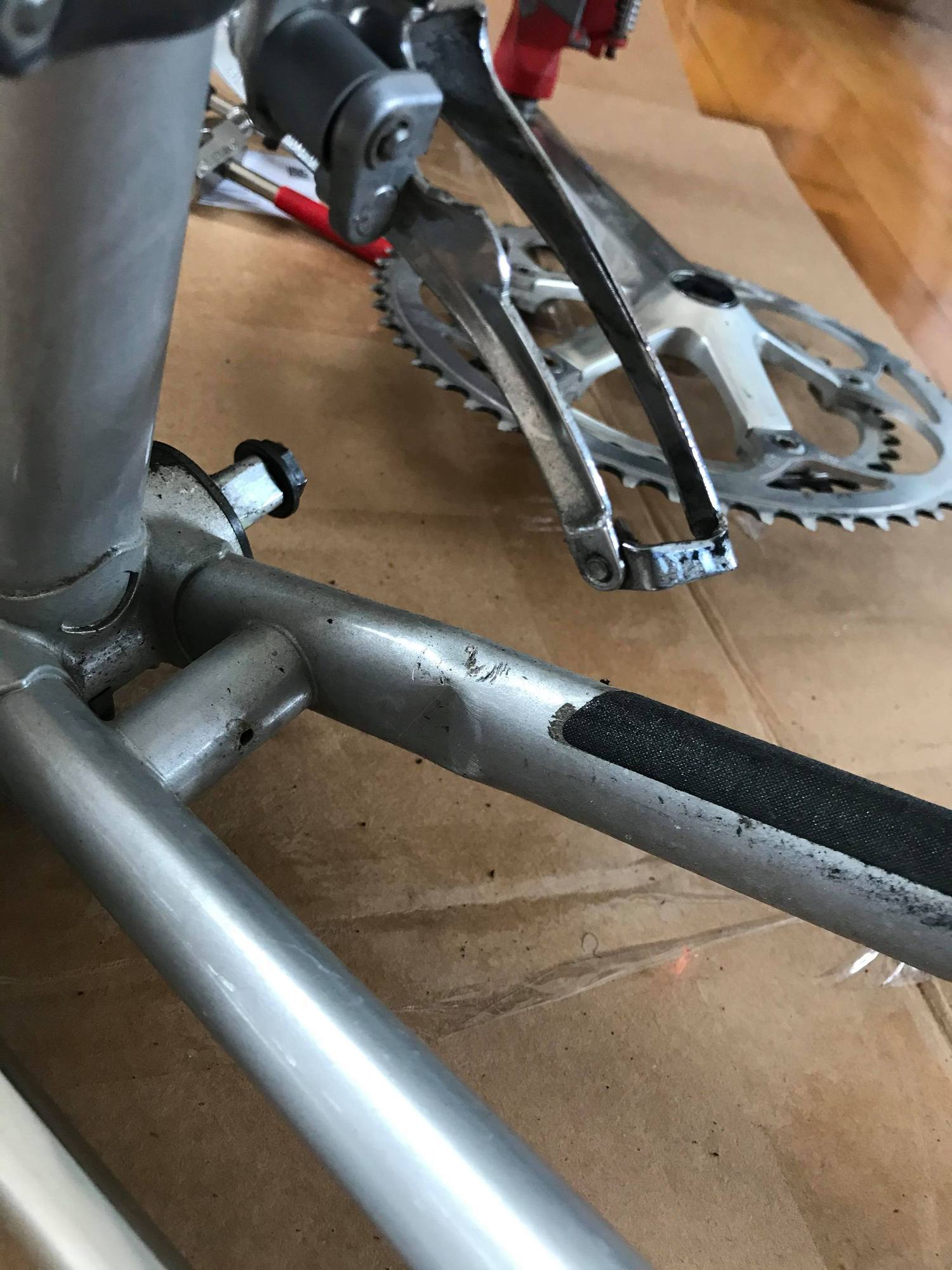

Bought a CV frame. The chain stay is damaged. How bad is it?
Posts: 378
Bikes: 1994 Cadex CFR3, 2006 Scott CR1 SL, Rossin aero, Bertrand GB 2000, Spec Allez Pro
Quoted: 134 Post(s)
Liked 68 Times
52 Posts
I was honestly pretty stoked when I bought this bike through marketplace. It's the same model as my first bike and it has very cool features, e.g. the handlebars. The previous early had mentioned superficial damage but nothing structural so I felt confident buying it. It arrived today poorly protected in two separate boxes. Everything seems fine except for the right seat stay. See pics below. I don't know if it happened while it was shipped or if it was already like this. But this is not my main concern.
I by no means intend to race this bike. I'll only use it as a commuter. Do you think this damage on the seat stay is enough to disqualify the bike?
That crimp is subject to developing a crack so it depends how much stress you put on the bike. I’d ride it and keep an eye on the crimped parts. I doubt it will fail catastrophically while riding.

...I wouldn't buy that, and I wouldn't invest a whole lot in repairing it. Neither would I ride it.
That is oddly damaged, almost looks like an intentional crimp, poorly executed, for chainring clearance.
Is it aluminum or steel ?
Due to the sharp crease at the top and bottom of the crimp, that is what makes it no bueno and subject developing a crack in the tube eventually. Will it do it immediately? probably not. Is it repairable? Yes. Is it worth the repair? only you can answer. IMHO you should ask for a refund or a renegotiate or insurance. It was either there and they didn't disclose, or it happened in transit (I have no idea how it could) and it wasn't packed properly.

Keep an eye on it, but it might never develop a crack. I have a frame with damage like that and it’s been fine over ~4000 miles so far.

I agree with 3alarmer, that is not "superficial damage but nothing structural" that is structural. Also agree that the creases did not occur in shipping and it was an attempt to get chainring clearance with a technique that did not work on the Pro's thin tube.

I wonder if the damage is from an attempt (successsful or not) to steal it. ???
My Guess:
Shipped without a rear wheel in it .. or a separator block, before shipping,
The chain stay was crushed inward, dimple on the inside , then bent back, making the outside one..

No they don't pack them very well for shipping. But was the box showing a lot of damage and was anything else damaged. And I don't necessarily think what follows is correct. But it is another thing to consider that hasn't been brought up.
Although the dent doesn't look purpose made, it is in about the area of the small chain ring. Many frames have dents, depressions and flat spots put into them at this point of the chainstay. This looks like a steel frame from the 80's. Specialized probably had several different suppliers from Japan or elsewhere. At that time different techniques of manufacturing on the same model frame where common since they are hand built. Perhaps this was made by a not quite experienced enough builder and is just sloppy work.
So put the crank back on and see if that is plausible. However if the BB is not the original length spindle and cranks too, then that might not show if this was done for clearance. There is frequently a dent on both sides of the tube when the make the dent for clearance. I'm not sure why there is a dent on the top of the tube. But if this is a steel tubed bike, it might not be an issue if everything is lining up correctly.
You can look through pictures of old vintage frames and you see many different ways that the stays are dented for clearance. Even some of the same model frames seem to have been dented by different methods.
Without any damage to the crank, chainrings or front DR, I'd be skeptical this was done during shipping. Or were they removed for shipping?

I think you can be pretty confident that it's a deliberate (amateur after-market) modification for small chainring clearance. But if the seller claims it's original to the bike, here are some pictures of the same model frame where you can see clearly that there's a slight indent, but nothing like what you've got and nothing visible on the inside of the stay:

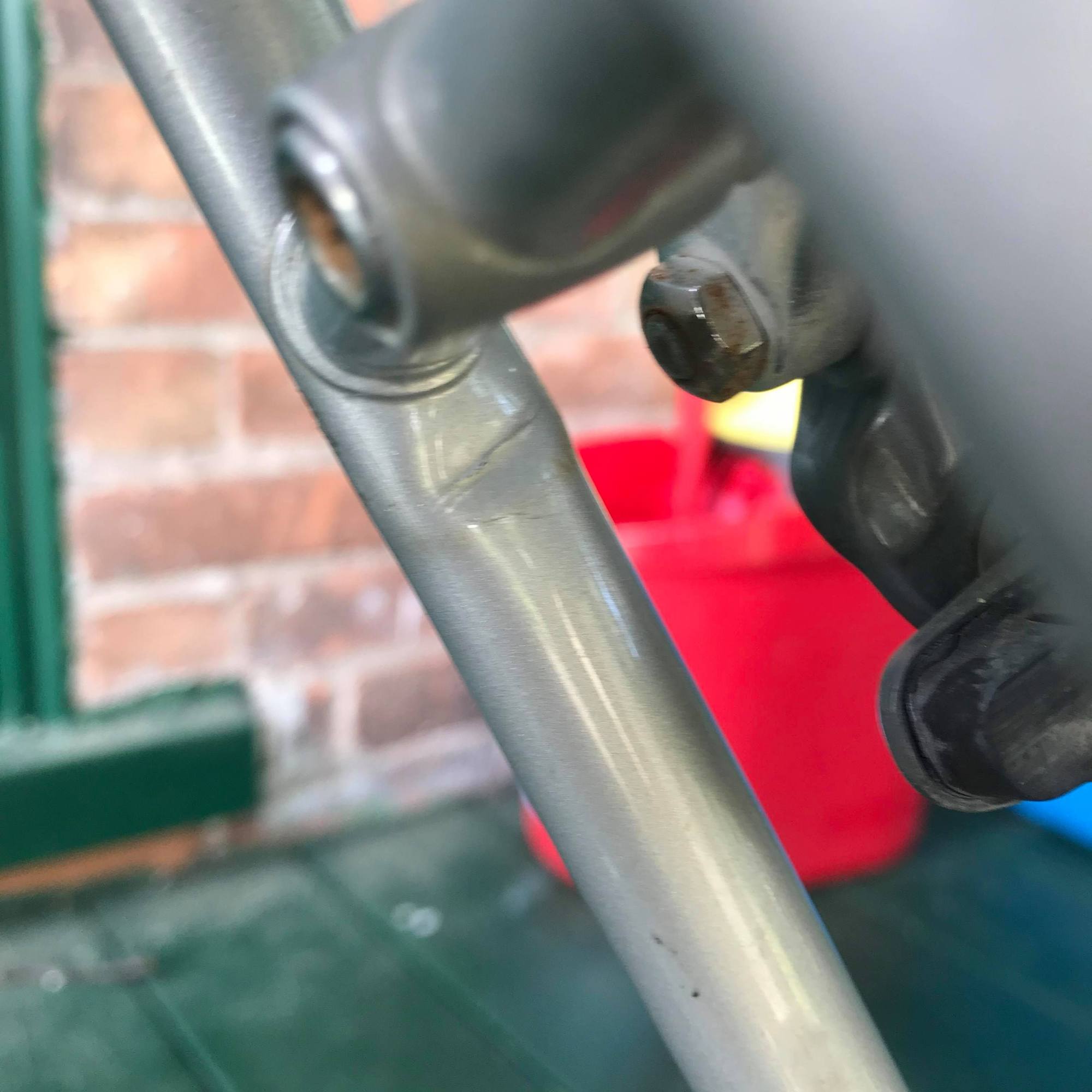

And now I've litteraly found a crack in the seat stay
Oh, and while we're at it!

Only thing is, there's a scrape mark just aft of the indentation on the inside. This suggests some kind of clamping/crimping action. In any event, the bike is not as advertised, not even close.
remove the paint to learn if it was just paint cracking

If those dings and dents were not disclosed by the seller, then I'd want my money back. If they were caused by shipping, I think it is the person that shipped the item that has to make that claim.
Unless it was a less than 50 dollar purchase, it'll not be worth making it right enough for riding when so much better is out there. It's scrap iron to me.

Due take the following as "a grain of salt", since I'm no pro mech; if it is repairable, yes; it depends on how much you value it. Those drive side stays were bent either in an accidental, an incidental, or intentional manner. The bends are almost parallel to one another, so my guess would be a motor vehicle collision ( being side swiped or t boned by a driver), an amateurish-gone-bad-attempt at re spacing the rear triangle, or an attempted illegal possesion of the bike. Yes, they will crack eventually so it will be up to you to decide between riding carefully 'til they crack/split, have a frame replace the tubes or, negotiate a refund from the seller. Good luck on whatever you decide, and keep us posted.

Send that back. If those dents were from your life with the bike you could just regard them as battle scars and live with them. But on arrival? No. This is on the seller Either he didn't disclose or his packaging and choice of shipper are to blame.
That chainstay - I think Fietsbob nailed it.

holy c.. that must be it.
Since... he was by no means an experimented seller. He sent the package in two different boxes (bc of the size limits), one for the wheels, the other for the frame and other accessories.
Ask for a refund immediately. The seller’s description does not match the real condition of the bike. The dents and crack will always nag you if you decide to keep it.

If that frame showed up at my door it would go back to the seller. Those bends indicate that the frame was in a crash and damaged to the point of being replaced by an insurance adjuster. If it wasn't, it should have. Find another frame that fits you and purchase it. The cost of repairs is way over the value of the frame, so I would not keep it. Hoping to hear an opinion from Robbie Tunes.... JHMO, MH
