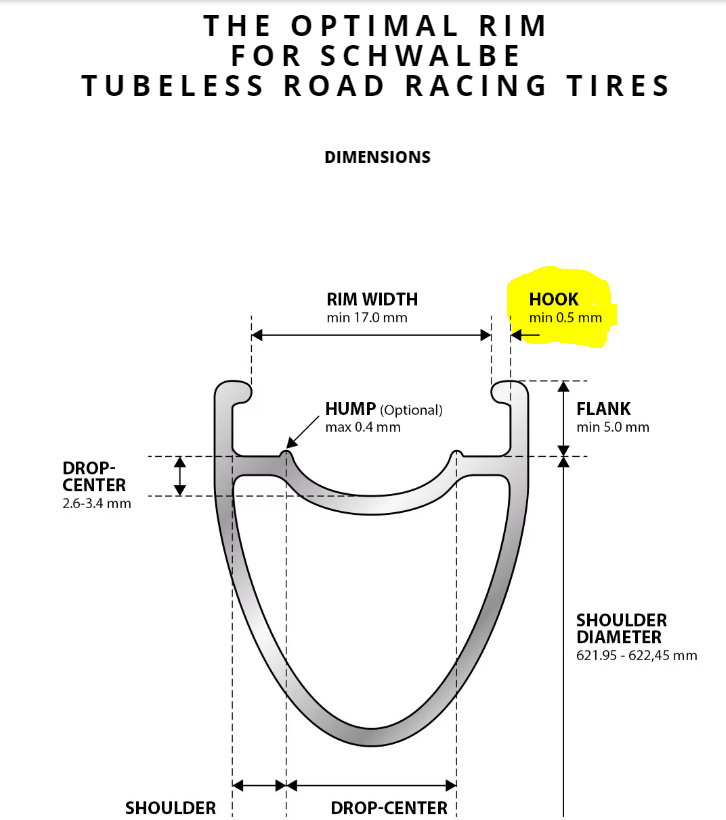

My favs are the IRCs, followed by Pro Ones. Funny that they're both on the list.
You only mount tires that work with your rims. Kind of like in your car. Are you telling me the danger is that you're going to crash while texting? That people who don't know that they're taking about won't like your setup?
Likes For Seattle Forrest:
Thanks! Is water wet?
https://www.schwalbe.com/en/tubeless...danforderungen
But Sure, You Enve and Zipp knows better. Right?
