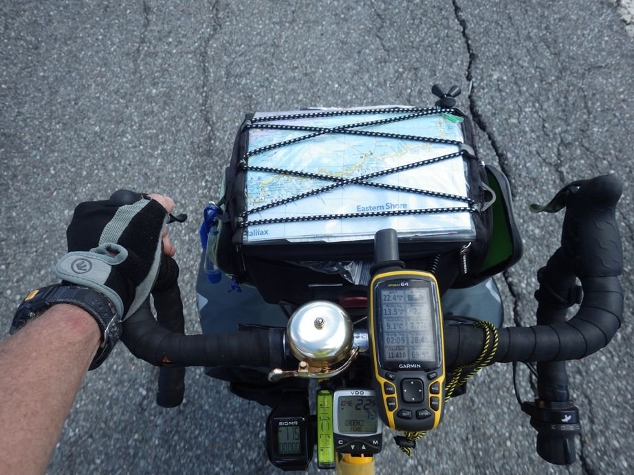

I do not train, thus have no training screen. Touring, by row starting at the top, each row from left to right:
- speed
- GPS battery status
- moving average speed
- elevation
- overall average speed (includes time stopped)
- vertical speed (my GPS does not have a percent grade function)
- moving time
- trip odometer (I reset every day, so it is the distance that day)
- ETA at destination (not sure how it is calculated, sometimes appears to be far off)
- distance to destination.
I have no data fields on my map screen, when my map is up I do not want to consume some of the small screen for non-mapping duties.
I also have a separate heart rate monitor, inclinometer (level bubble with percent grade) and a bike computer that I sometimes use for cadence.

I have a different setup for Road and Mountain bikes, but for touring, I have these data. I have the navigation map next page.

Cropped part of the photo out of the photo I posted above so you can see it better.
