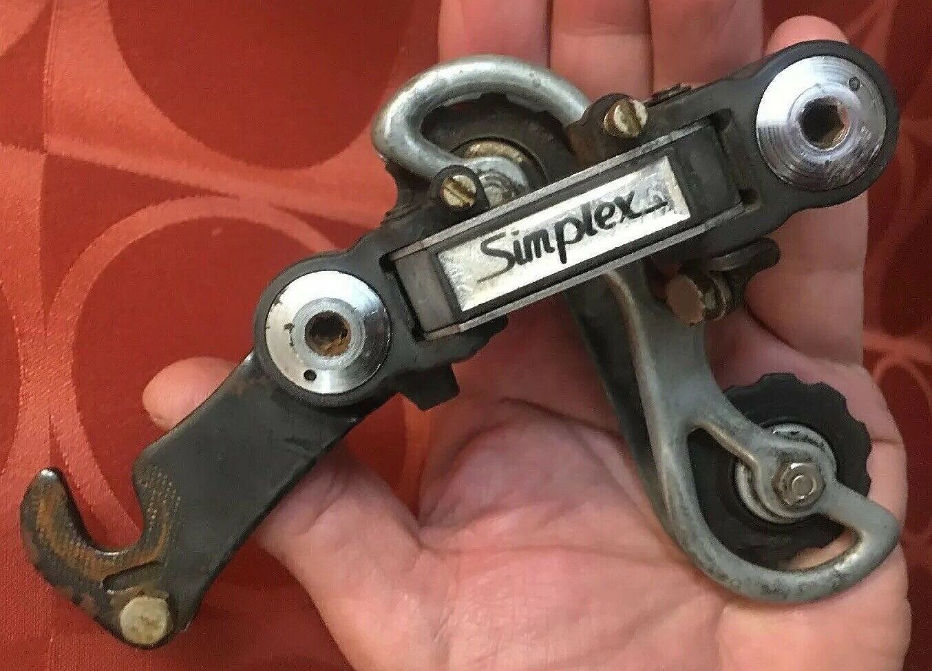

Simplex Maxi Prestige Long Arm Derailleur
Originally Posted by hokiefyd
Or even stamp longer claws! I recently asked about different lengths of hangers for this very reason. The (correct) answer is there is really only one length of those claws. I acknowledge that most nicer bikes use integrated hangers, and have done so for the last four decades or so...but it still is curious that this was "never a thing" back in the day.
Of course, back then, a "big" freewheel or cassette sprocket was 24t...real cyclists rode a maximum of 21t, right? (And only on the 53t ring!)
au contraire mon frere
Alpine Gearing found on most non racing bike boom models had 14-28T 5sp FWs with 52-42T, 52-40T or 52-36T cranks. The standard Simplex Prestige RDs could usually handle those range gears.
Simplex Maxi Prestige ca 1972-73. They had a long claw attachment plus a long arm pulley cage. I only saw a few of them in the steel. They were on "touring" mixte bikes, usually with 14-32 5sp FWs.
There were many different length claw hangers depending on brand but few/none as long as these.
1972-73 Simplex catalog page from velo-pages.com showing the Simplex Maxi Presitge front and rear derailleurs.
