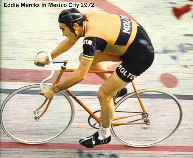

This one. Because Eddy rode it.
There was nothing truely innovative about the steel framed bikes of the 70's. Perhaps sloping downtube and pursuit bars located on the fork crown was as exciting as it got if I recall, or was that still later than the 70's?
Best era was the mid 80's through 90's with the experimentation with new materials such as Carbon and designs straying from the double diamond before the UCI stepped in. Bikes such as the Lotus 108, Aussie Superbike and US GT's to name a few...

If that's Gord Singleton's bike it would be, but that would be because of who rode it, not the bike itself. IN the 70's and 80's, most high end bikes were made from similar steels. Some brands made some funky designs with custom geometry or tubing. Moser made an interesting big wheel track bike for his hour record attempt. Colnago used to make double downtube bikes and bikes with square tubing, or even lobed tubing to emulate their company logo.
