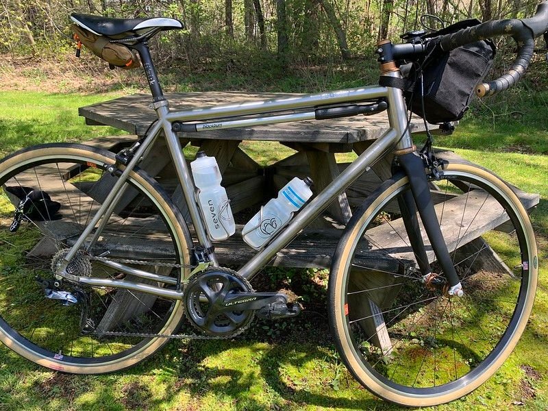

This one is not cheap, but it works wonderfully. You really don't need to run the elastic straps to the handlebars unless you're riding off-road and need extra stability.
https://www.ruthworkssf.com/store/p6...ht_Brevet.html
Ultralight Brevet bag on my Seven Redsky

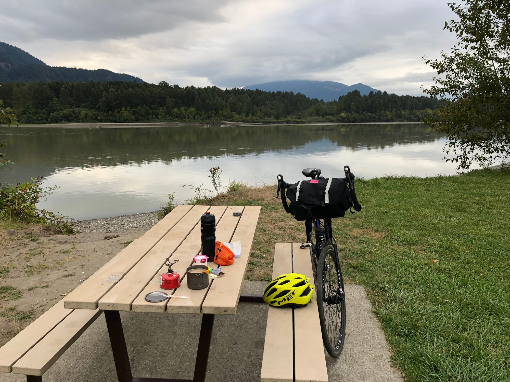

I’ve been using the Swift Zeitgeist for a few months. It fits well in the 46cm drop bars. It’s really well made and the perfect size for me. It does push on the cables a bit which does affect shifting once in a while. If you use the optional foam spacer blocks it will hang slightly below the bars. My Wahoo is mounted on the stem.
This isn’t the most relevant picture but it’s all I have at the moment. Coffee break overlooking the mighty Fraser River.
