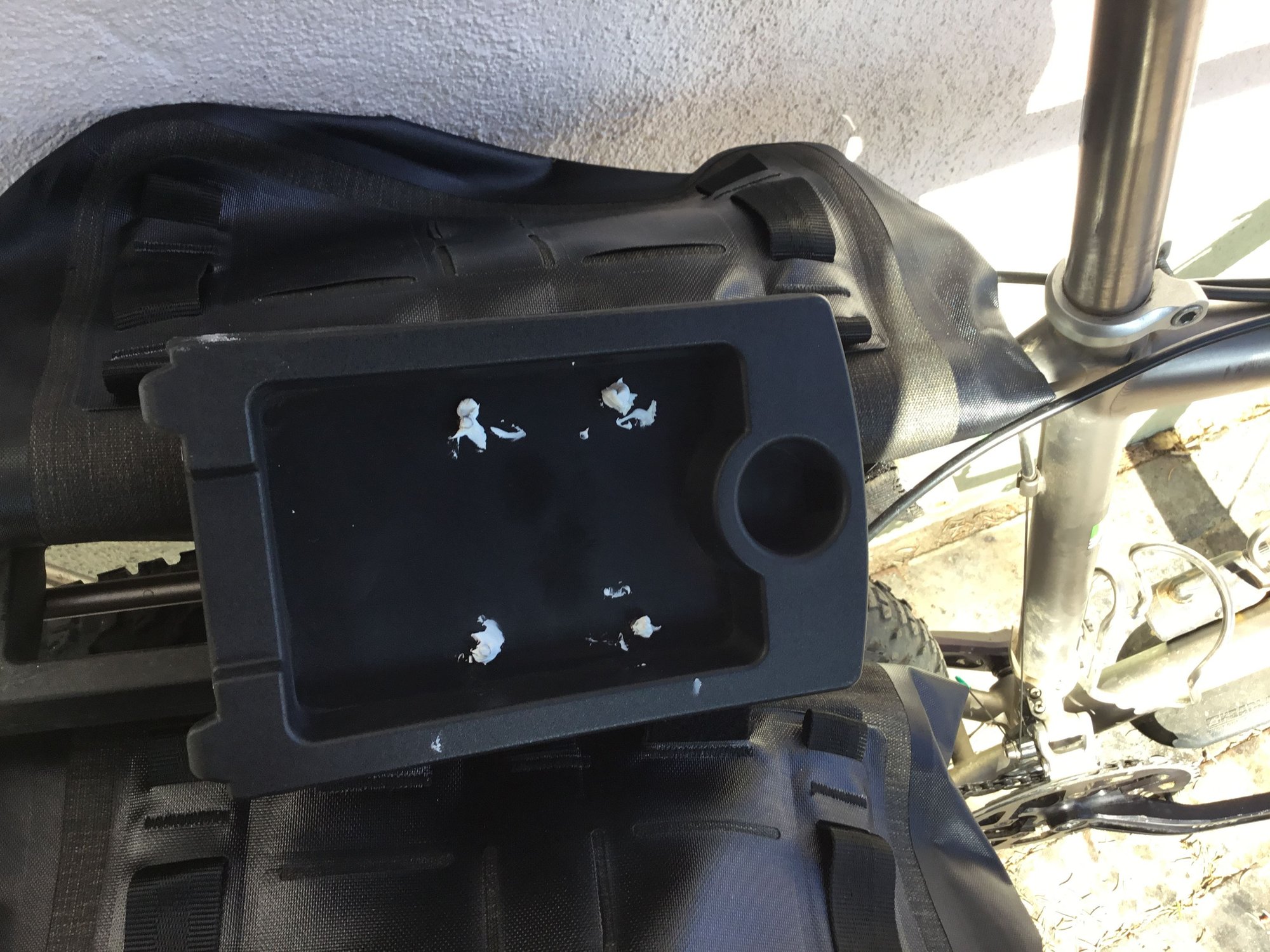

I do use an Airy on my bikepacking bike and have fashioned a micro pannier set for it. I use an Ortlieb rack adapter to carry a trunk bag most of the time when not touring. The Airy isn’t a good fit for trunk bags because of the deck’s narrowness.
You can see the rack adapter here.
Close up. I use this rack adapter on all my bikes. I’ve found it to be much more secure than Velcro straps. I could carry the bike around by the trunk bag if I wanted to.
I used an Ortlieb basket adapter and a plastic sheet to make the base for the micropanniers. I use this same basket adapter on a Racktime Trunkit for my regular riding.
I used two Rock Bros handlebar pockets for the “panniers”. They have around 5L of volume for each one which is enough room to carry 5 to 6 days of freeze dry meals. My bikepacking is usually quite remote so I don’t cook. I only boil water.
What the bags look like close up.
Here’s a picture of one of my bikes with the Trunkit on the rack
DSCN0387 by Stuart Black, on Flickr
That Trunkit is probably 20 to 25 years old and still going strong. It’s never come off the bike no matter how rugged the terrain.

I actually have several of them but I don’t use them for panniers…at least not traditional panniers. The deck is a bit narrow for my tastes. I use a Tubus Cargo on my road touring bike. It gives more space and support carry a tent and sleeping bag on the rear rack. I couldn’t carry the tent and sleeping bag in that orientation on the Airy. The bags would work in a perpendicular carry to the rack but the rack would provide only minimal support.

Thanks cyccommute for all the photos, they actually answered most of my questions, Did you bend the rack the stay/s? if so are they hollow or solid titanium.
Since that picture was taken, I’ve had rack fittings added to the bike and have a much less radical bend on the stay. I only have to use one stay (it fits my brake configuration better). Again, I bent it myself.
