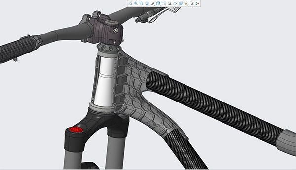

I am part of a team developing this cross country racer for a Denver mnt team. Cabron tubes are glued in if you can believe it just like Boeing's 787 The design is a hi pivot design created from the chromoly frame they raced the last 3 years. If you search 'design engine instagram' you can see the design
Im not able to post a picture till I get 10 posts LOL

yes, you can't post pics because we get a lot of spammers. What did you want to post?
What are the joints made out of?

doesn't look like there is a lot of surface are for gluing********** "Just like 787" is apples/oranges as any application in a 787 is going to be bit different from the application in a bike

it used to be a lot more common to have metal joints and carbon tubes. People are still making them that way. I have never heard of one coming apart

This bike will be a prototype racer. We are doing it to learn and break. We did break the alpha version in a race and learned from that bike. They build 3 of those as chromoly examples.. This one if we can we will start a proto build before June. I wonder with our social distancing if we will even race this year.... Notice the honeycomb inside the shell. Im eager to organize that honeycomb with generative design but have not yet. Gle will go on the end of the carbon tubes and if CNC'd then the weld will go down the middle halfs.

what are the joints made out of? I assume additive manufacturing?
I'm a bit curious about the 787 claim.
