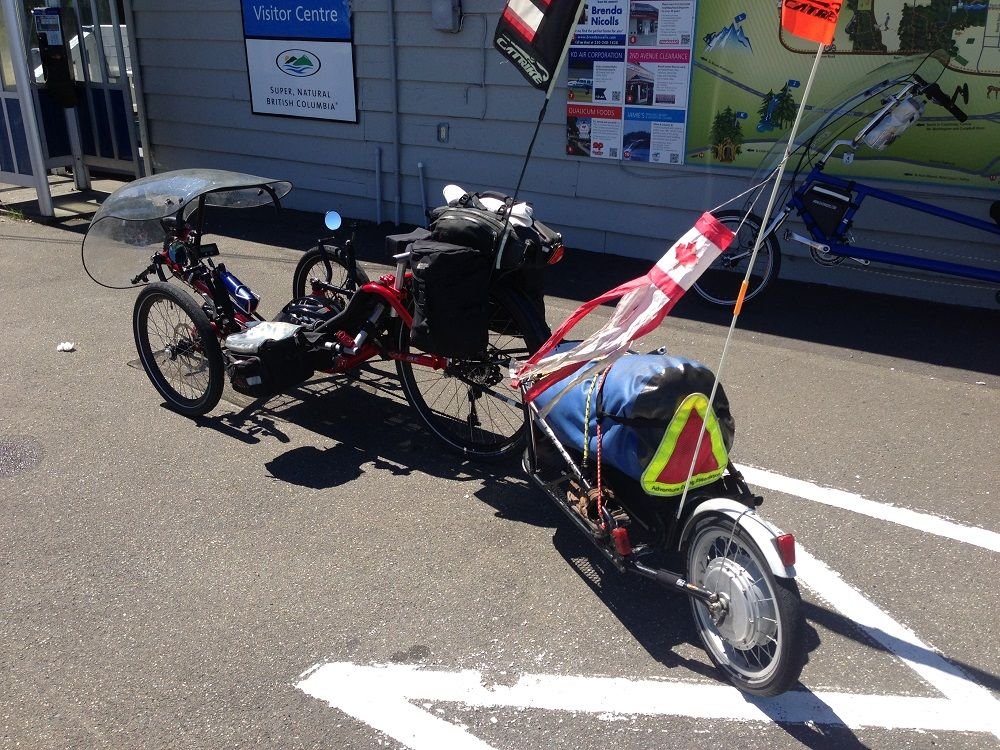

At this point, I have gone through three types of motors, a geared hub motor, a BaFeng, and a TongSheng. They all have different benefits.
The hub motor was on a commuter. It was on the front wheel and was relatively low power and throttle controlled. I liked it on snow and ice (with studded tyres). I was able to carefully give power to it to match my pedal input and have, what was effetively, two-wheel drive.
The BaFeng was on a touring trike. I used the internal cadence detection on it. It had plenty of power; however, as it required a full revolution to get started, it was very hard to start on hills. However, being able to put all that power through the gears was a strong benefit when crawling up steep grades. I had it paired to a Nuvinci N380 which was ideal for that type of motor. I was able to use the transmission to trim power consumption in order to maintain the charge in the batteries from the solar panels.
The TongSheng is on my current commuter. It has a torque sensor that provides the best "normal-bike" (also known as a push-bike). However, it seems a bit fiddly. It frequently throws error codes and right now it is sitting unused. My daughter has it and she says it isn't working. I am convinced that, when I get back to her, I will probably find that it is either now working, or that it is a connector issue.
I am sold on Mid-Drive. It just feels more natural when riding it. I don't think I will get another hub-drive. That being said, both the BaFeng and the TongSheng kits are not great choices for someone who is not able to tinker. I am probably going to go with the manufacturer built one at bikes direct soon.
