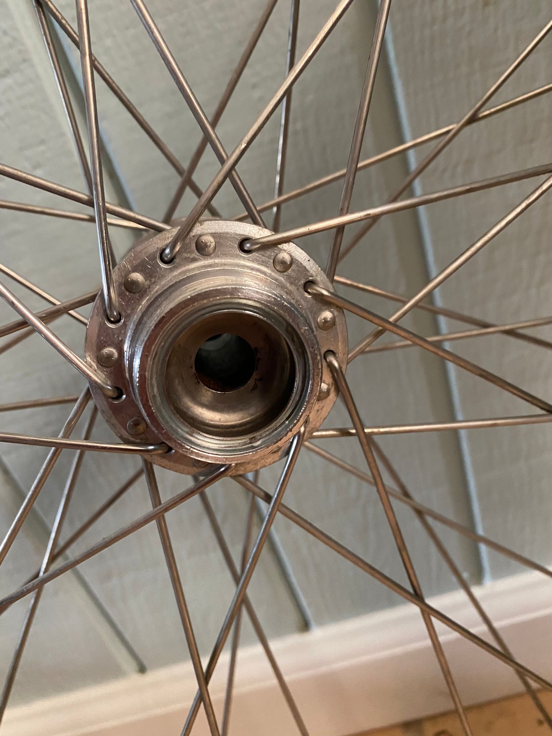

Front wheel
Feels gravely also
Maillard 500 hubs
Spindle out. Needs cleaning.
Will try to clean out the races in there.
This side didn’t fall apart. Will take them out. 10 each side. Looks like 3/16”
Feels gravely also
Maillard 500 hubs

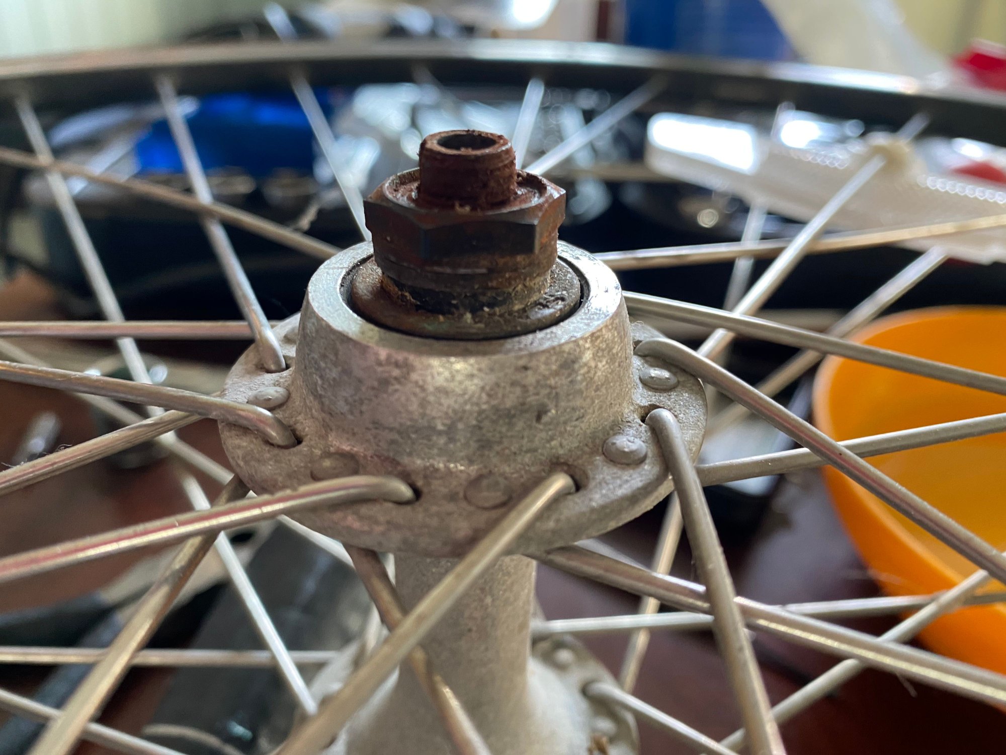

Still slowly working on this.
did I order the wrong freewheel? Didn’t know how that worked. Just got a Shimano 6 speed With the same tooth count as mine, but this one has different spacing between the smallest and second smallest gears, which I’m pretty sure will throw off my indexing. I bought the mf-tz500-6. [Edit: actually, I bought MF-TZ20 and they sent me the TZ500-6. Not sure the difference, but I may send it back just because it isn't what I ordered].
besides that. Going well 2 pedals and a wheel done. Working on reassembling the rear wheel (hence the freewheel question). Everything is smooth sailing so far. Have to figure out which crank and bottom bracket tools I need next.
New freewheel
Front wheel hub
Both pedals
Rear wheel hub stripped. Looks like 9 ball bearings and this one is 1/4” balls. Every bearing is different on this thing haha.
The rear hub shaft and cones/washers/nuts cleaned and partially assembled.
New freewheel
Front wheel hub
Both pedals
