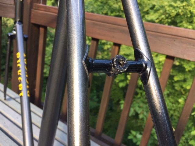

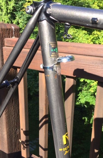

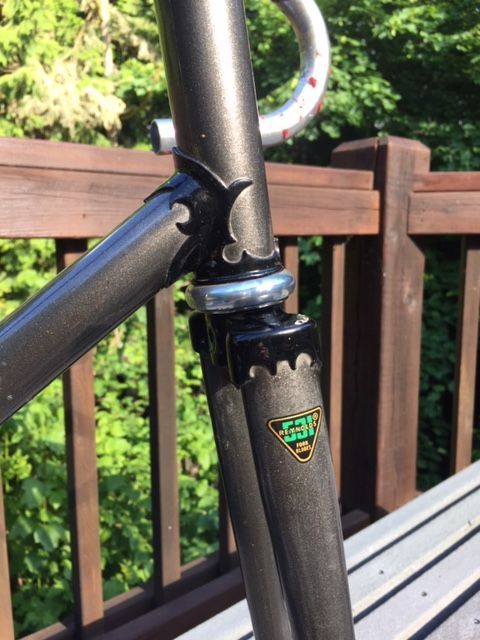

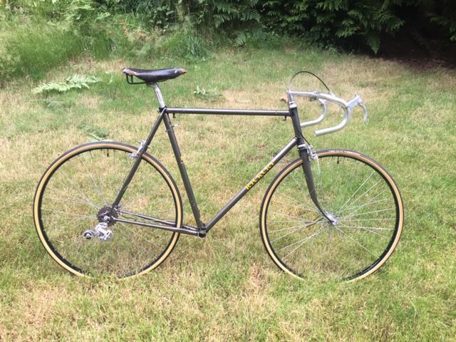

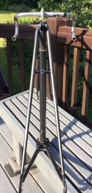

I'm no good at 'build threads', but I thought I should document this frameset for the ...... well, for the heck of it.
Brief story is that it came to me from a collector on Bainbridge Island, WA. He built it and rode and liked it but it was a bit large for him. Supposedly belonged to a family member of Ted Ernst, the racer, shop owner, etc. in S. Cal. I was told it was from 1959, so a relatively early Rickert.
531 butted f&f incl stays, 60 X 58.tad (ctc), with 17cm on headtube. Campy dropouts/forkends. Pointed seatstay caps, Nervex BB. Rollers at BB for derailleur cable routing. Repainted (primer and paint seem thick) about 25 years ago. Frameset felt so light, but they all do before adding stuff.
Pics tell the story. All comments welcomed, any information appreciated.
Decals available on ebay. I should search to see how accurate these are.
easily clears 33mm w/ knobs - rear wheel about 1/2way into dropout, so can go wider with longer wheelbase.
Nervex BB, and I think the 'Pro' lugset.
Paint on BB is too thick for me to distinguish the numbers/letters.

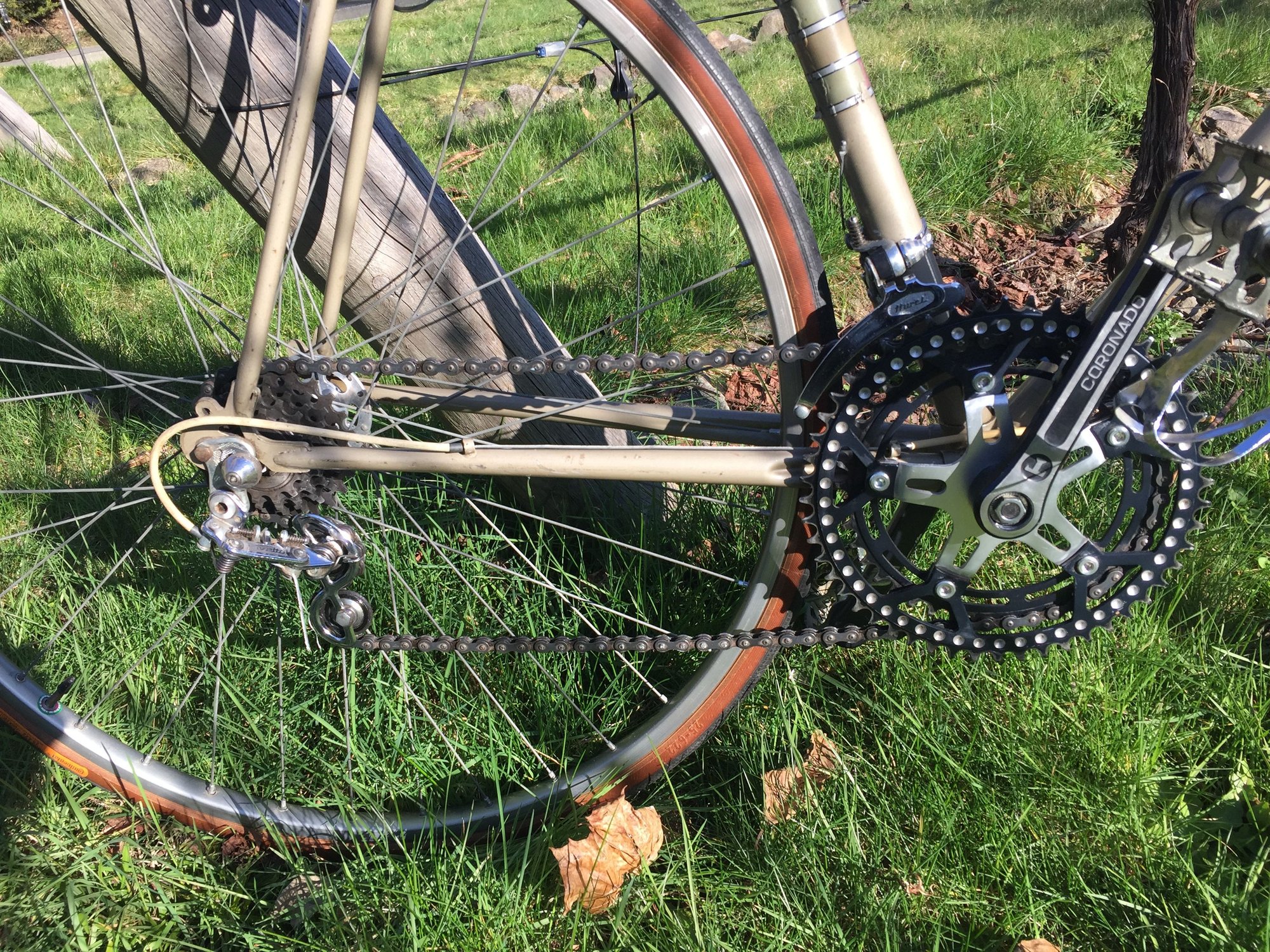

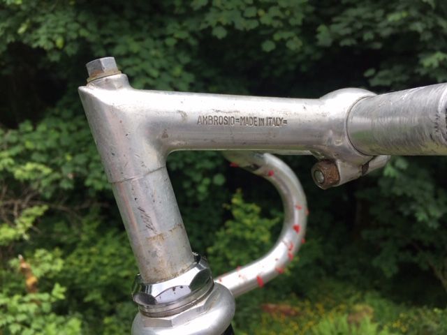

The 'Plan' - as always - is to build it up affordably, ride it, decide if it is worthy of upgrading.
First build is Huret Svelto rd, Huret fd & shifters, Universal side-pulls, Galli levers, Ambrosio stem, 3ttt bars, tubular wheels w/ black rims. Crank is German Thun with black rings drilled. No name headset & BB. If it's all I hope, an upgrade to Campy Gran Sport might be in its' future.
Your thoughts on build always welcomed, even if not heeded.
Some pics with bits
25mm tires. Saddle and stem height about right
33mm cyclocross tires
This will be the crankset.
and with the Svelto der. The crank, derailleurs, shifters presently on a Frejus that I can't make fit well because of a very short top tube.

You've got a few parts I've never actually seen on a bike; interesting stuff. I didn't know Rickerts went back that far. Anyway, cool project
Strong Walker
Very nice frame there! Rickert is one of the most desirable German frame builders and there are a few specialists over here in Germany, one was a regular at Rennrad-news.de if you want I can check whether he's still around and establish contact. Don't think you need the frame number when the history is backed by Ted, what he doesn't know about Rickerts isn't worth knowing
Unfortunately, there doesn't seem to be much reliable information around about which decal style matches which year of build, and also no original decal sets are available. Velo cals has a set but I think these would be too new for yours.
Oh and please loose the thun crankset, it is way too new and also a horrible piece of junk, they bend when looked upon angrily.

Thanks @martl - if the Bainbridge Island collector I purchased from called it a 1959 Rickert, then I believe him. Had been looking for a German bike and had been looking for a bike from my birth year - so I relented on the year requirement and it's from my birth decade, close enough. Kills 2 birds with one stone.
I'm quite certain the bike warrants full Campy Gran Sport group- but I don't have such today. So first build is from what I have around. The Thun crank seems universally rejected as an acceptable bicycle part. At nearly 70yo, breaking or bending it would be worth 'bragging rights'. The Thun goes on 1st build with motivation to mash it. I have a Campy crank that needs a lot of polishing for build #2 .
There's just not much info on Rickert bikes. Hugo worked alone, so the volume must be low. Glad it is mine, a perfect fit for riding is the icing for this German indulgence.
