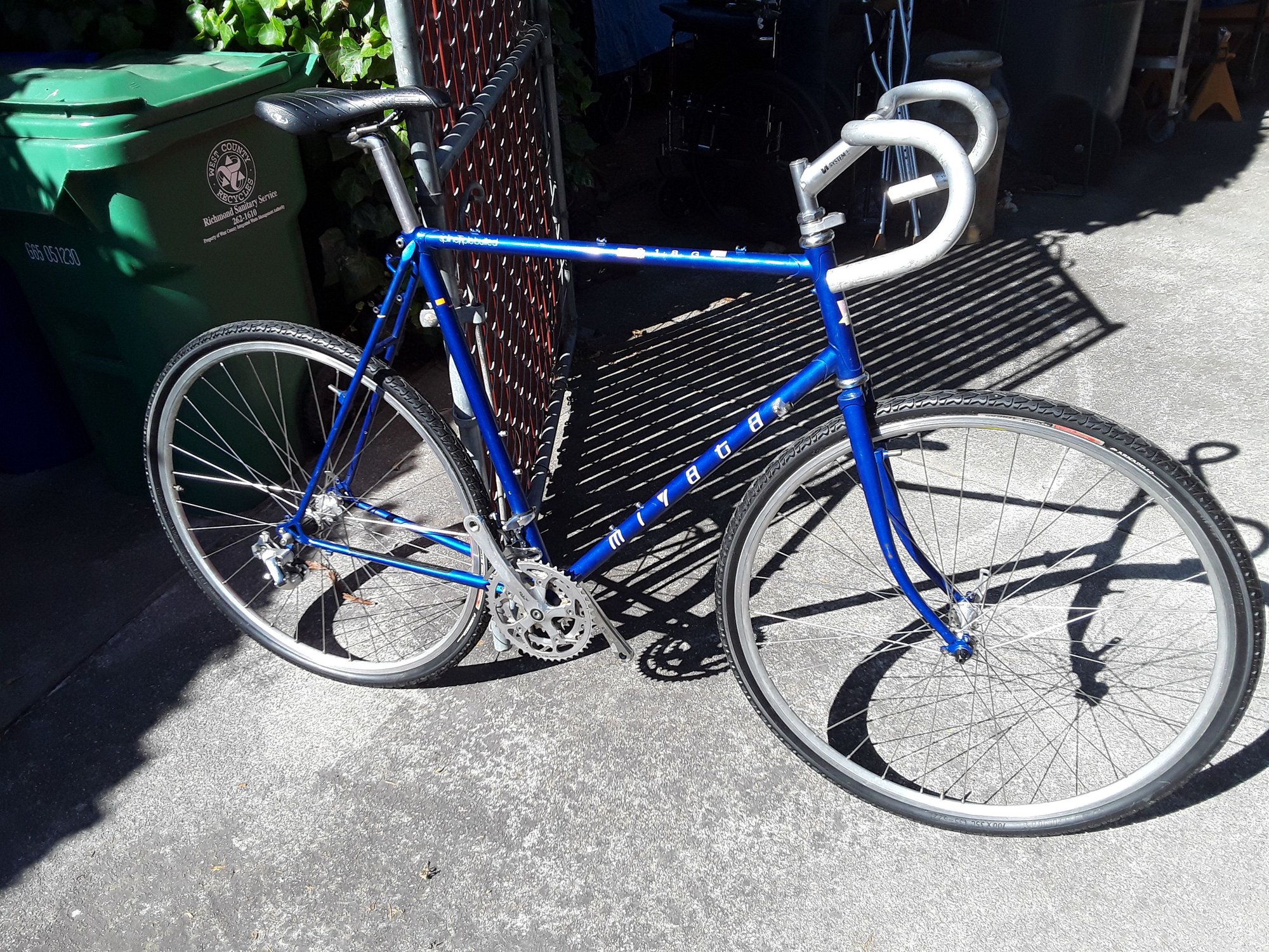

I have a Miyata 618GT that's getting that treatment. I like the logic on using the barends. When your out exploring you don't always have the luxury of knowing what's coming up. I'll add a picture when I get a chance.

Parted out a 90's Yeti with XTR components and was thinking they'd go good on this. Trying to use the Avid canti set that came with it also. Tires are 700/35 with lots of room to spare. 58cm frame

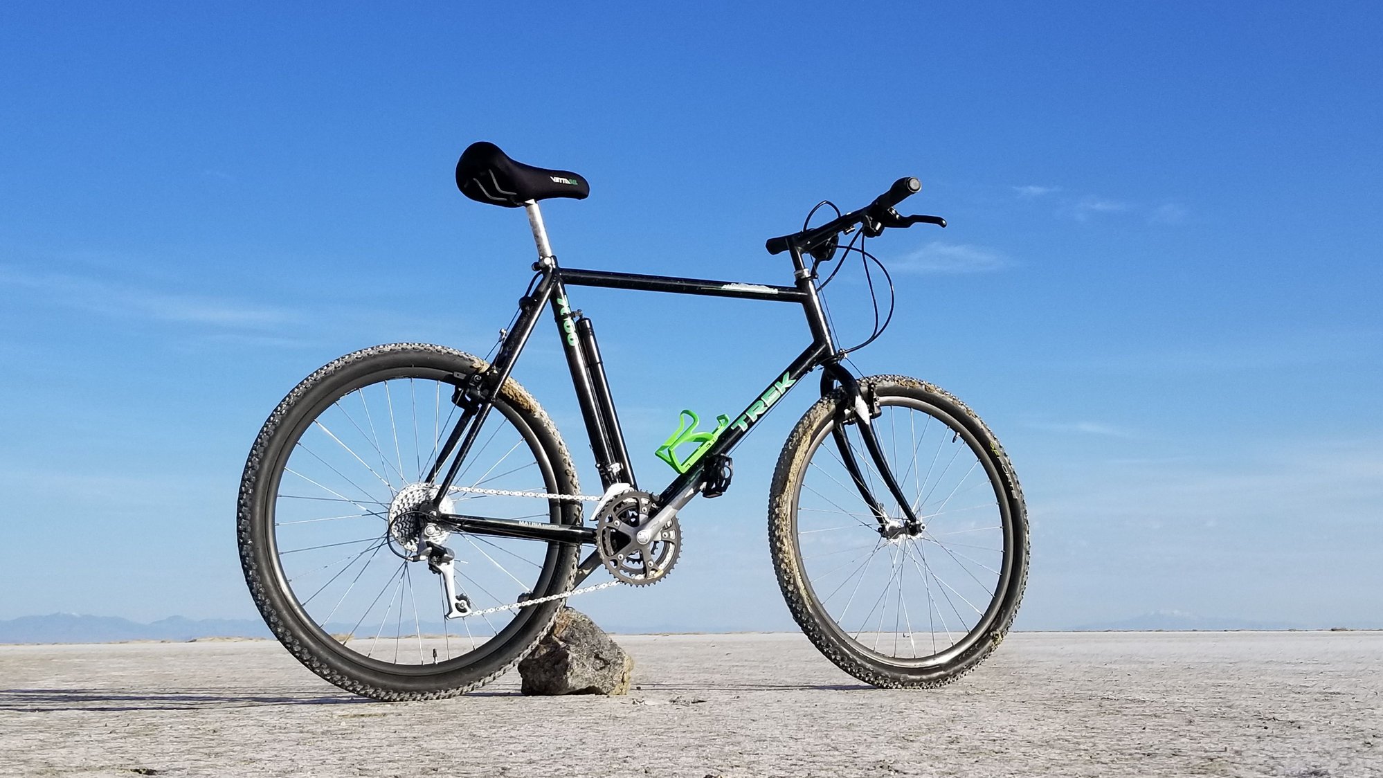

Originally Posted by jcb3
Because I could?
I was riding the 26 one day and got to thinking that it would handle better with a bigger wheel (to match the big guy riding it). Indeed it was better. I also did a drop conversion at the time as well (more hand positions)
And when I decided to throw it up on CL, it got snapped up pretty fast, so there was the uniqueness factor that so many people down here are looking for.
I've considered such a build on this nearly original 90 Trek 7000. But everytime I think about altering it, I lose sleep. Guess I need to find a different bike...
