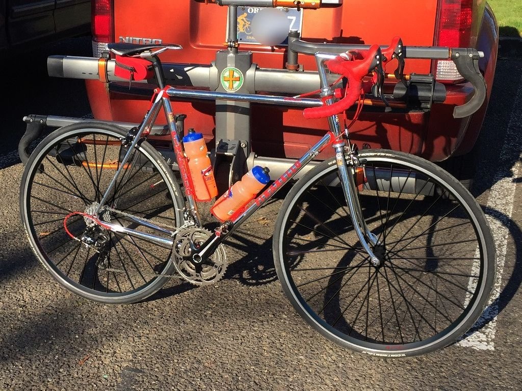

Maybe something more like this? The photo is, as we know, a bit on the exposed side, so my corrective magic is limited (especially with the medium resolution).

Originally Posted by RiddleOfSteel View Post
(...) Thank you!
You're welcome. I've been playing around with the retro-mod concept and find that balancing shapes and colors in such a way that the result looks in any way coherent is not an easy task. And since you seem to have an above-average sense for getting it right, I am very grateful for these examples. Please, keep 'em coming!
Thanks for the suggestions, and nice work on the "corrective magic"! I'll give it a test fit with the wheels from this bike and see how it looks.
By the way, I just bought an unusual Bianchi frame that I'd like to consult you about. I'll send you an e-mail on that one.

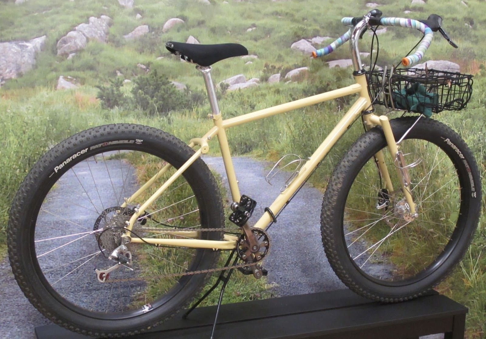

I guess my 1971 Raleigh Super Course qualifies for this thread, among a few others. I've rebuilt this bike several times. This time, it has new bars and stem, new wheels, seatpost, and brand new 2x8 Claris drivetrain. Tires are Vittoria Voyager Hyper, 700x37. I put the original brakes back on so they could reach the smaller 700c wheels. I'm not going to keep the mustache bars, as there isn't enough room in there for my handlebar bag. I'll also put on a bell, rack, fenders, and dynamo-powered lights.
Those brifters are for drop bars, imho they look horrible on these handlebars. Mountain bike shifters/brake handles would both look and perform way better!
noglider - I have to agree with ski4bob:
the ergos with the brifters & moustache bars has got to be pretty awful.
Even if it's only a short jaunt/Townie.
Why not bar ends?
Or maybe dirt drops with the Claris STIs?

beauty is in the eye of the beholder. i think brifters look pretty cool on moustache bars. atleast, my ultegra 6500's do. and, for the throw on those, and my smaller hands, it's works functionally rather well
besides, mtb shifters/brakes won't work on moustache bars. they're road size
moreover, he's not keeping those bars on there, right?
having said all that, i've seen some soma sparrow bars flipped and brifters installed that look pretty sharp
thook is offline
They work fine. The controls are right under my fingers. I've had this setup on my Raleigh International for about three years. But I'm going to put regular drop bars back on this bike. These bars don't have room for my handlebar bag.

'93 Cannondale T700 frame and fork. 2x9 Microshift shifters mated to Tiagra derailleurs. A Sakar crank with 50/34 rings makes for a nice modern drivetrain with older style look.
The bars are Soma hwy1 since modern bands work great with STI shifting. Deore/rhynolite wheelset finished it off.
Hope someone can use it for trail riding, commuting, or touring. A few small changes would make it a great touring bike since it has plenty of mounts.
Have you had any interest in this?
I have an old alloy Trek hybrid bike (2002 Trek 7500 FX) that I converted to drop bars, and I am thinking of selling it. But I'm wondering if it will get more interest from buyers if I convert it back to it's original flat bar configuration.
