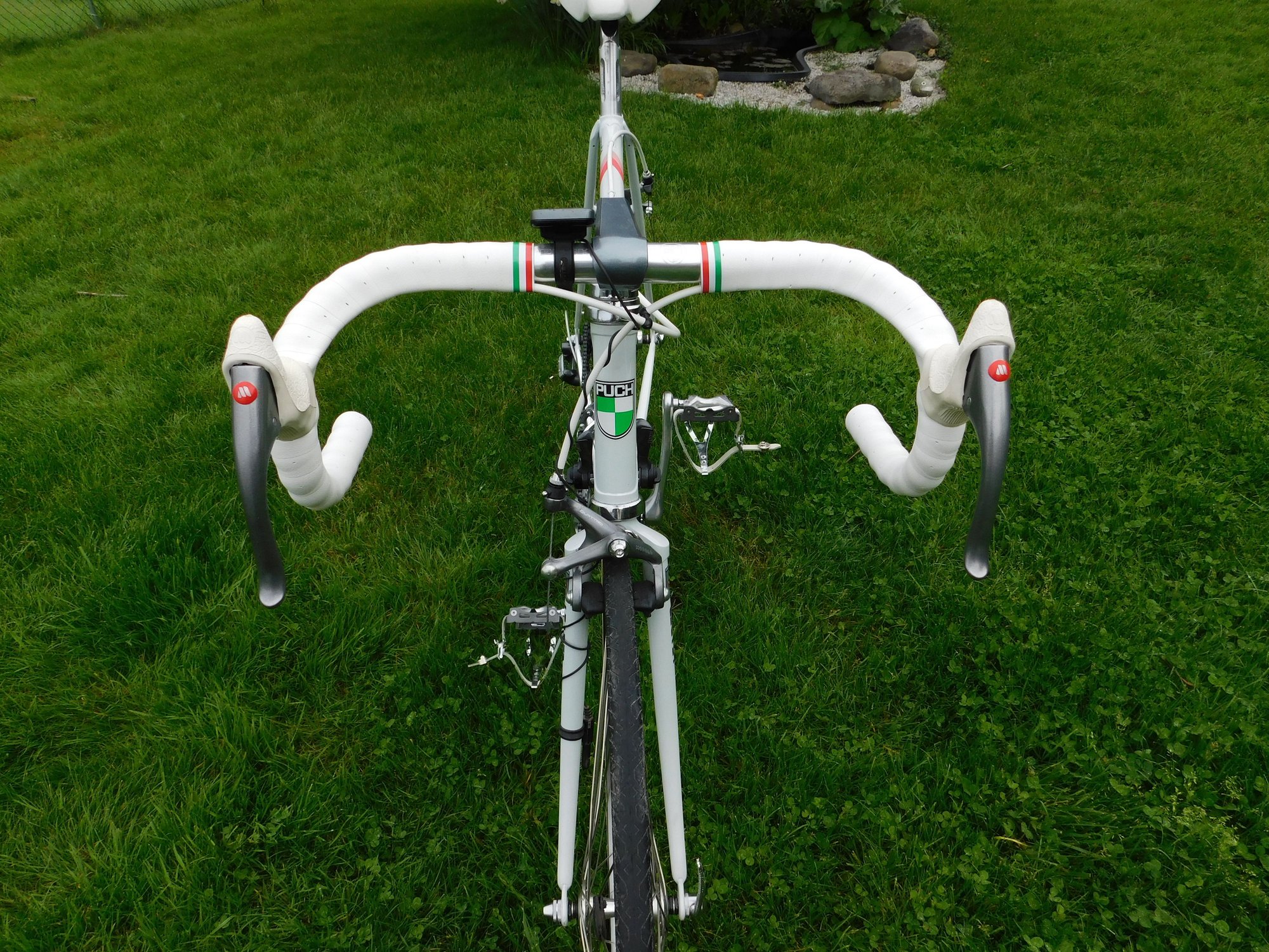

I'm Ok at it. I think I learned a lot of technique by wrapping with various types of wrap.
Cheap, fat, foam 'cork' tape is the hardest to get good results with. Cloth tape with a narrow width is the easiest. I have a couple of my favorite bikes wrapped with old-fashioned 1/2" cloth friction tape. Very easy and surprisingly satisfactory results, if you don't care about the padding.
● 1971 Grandis SL ● 1972 Lambert Grand Prix frankenbike ● 1972 Raleigh Super Course fixie ● 1973 Nishiki Semi-Pro ● 1980 Apollo "Legnano" ● 1981 Miyata 1000 ● 1984 Bianchi Limited ● 1984 Nishiki Landau ● 1984 Peugeot Vagabond ● 1985 Shogun Prairie Breaker ● 1986 Univega Nuovo Sport ● 1986 Merckx Super Corsa ● 1987 Schwinn Tempo ● 1988 Schwinn Voyageur ● 1989 Trek 400 ● 1989 Bottechia Team ADR replica ● 1990 Cannondale ST600 ● 1993 Technium RT600 ● 1996 Kona Lava Dome ●

@Lascauxcaveman, nice wrap job with no unnecessary finishing tape at the top.
Tim
Tim
Heh. Wrap from the top down, and the only finishing is putting the plugs in the bar ends
But I did put some unnecessary "finishing" on my Raleigh by adding an underlayer of complimentary colored hockey tape (again, wrapped top down):
