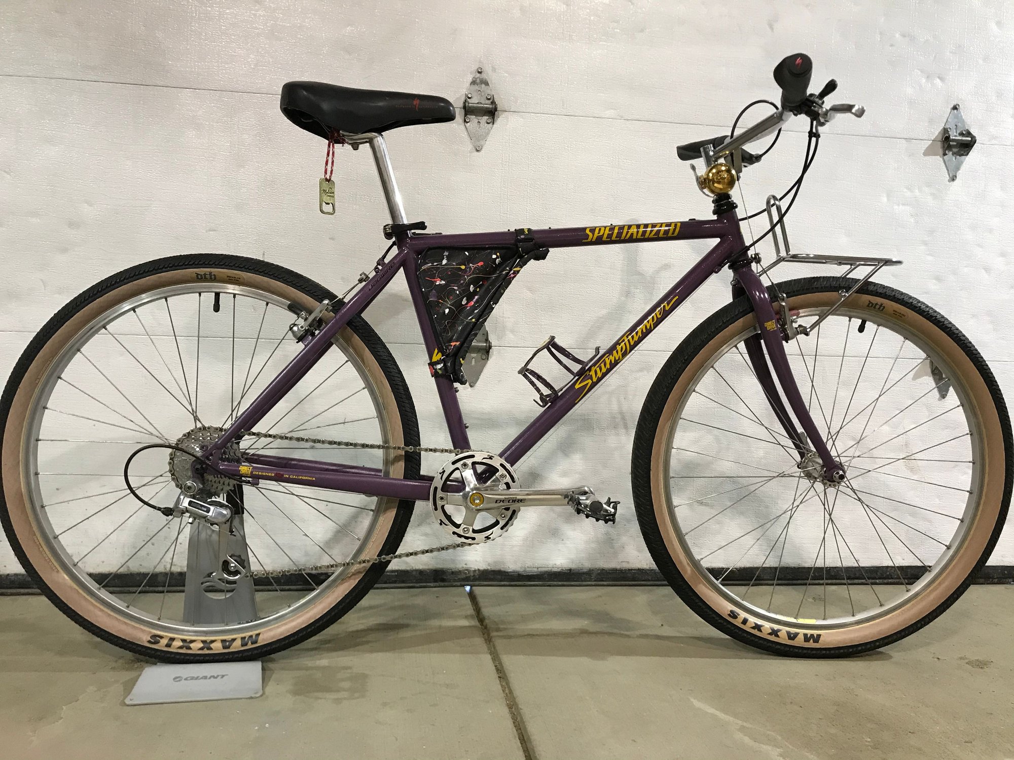

Haven’t even sat on her yet. We have a lot of snow and ice and it’s not exactly set up for that. Appreciate the kind words. Thinking about grips. Oury, Deity maybe Specialized not sure....have Zee cage on the way and gold chain. So it’s kinda experiment as I go now. Also not in hurry to getter dirty yet. I haven’t waxed the paint yet either. I do have to say the Jagwire cabling was definitely worth the extra money wow didn’t think cable could be so different. Top quality stuff for sure.

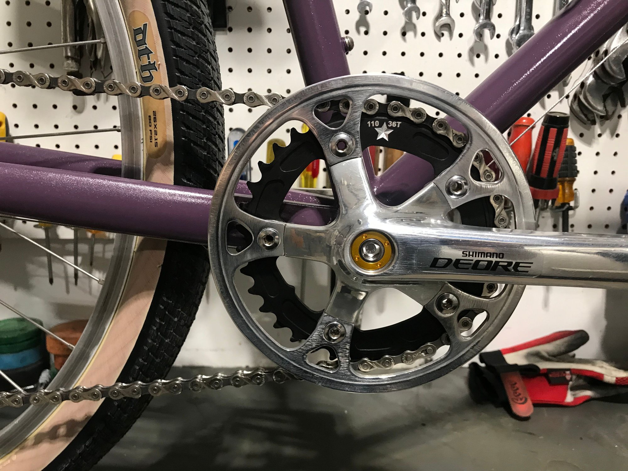

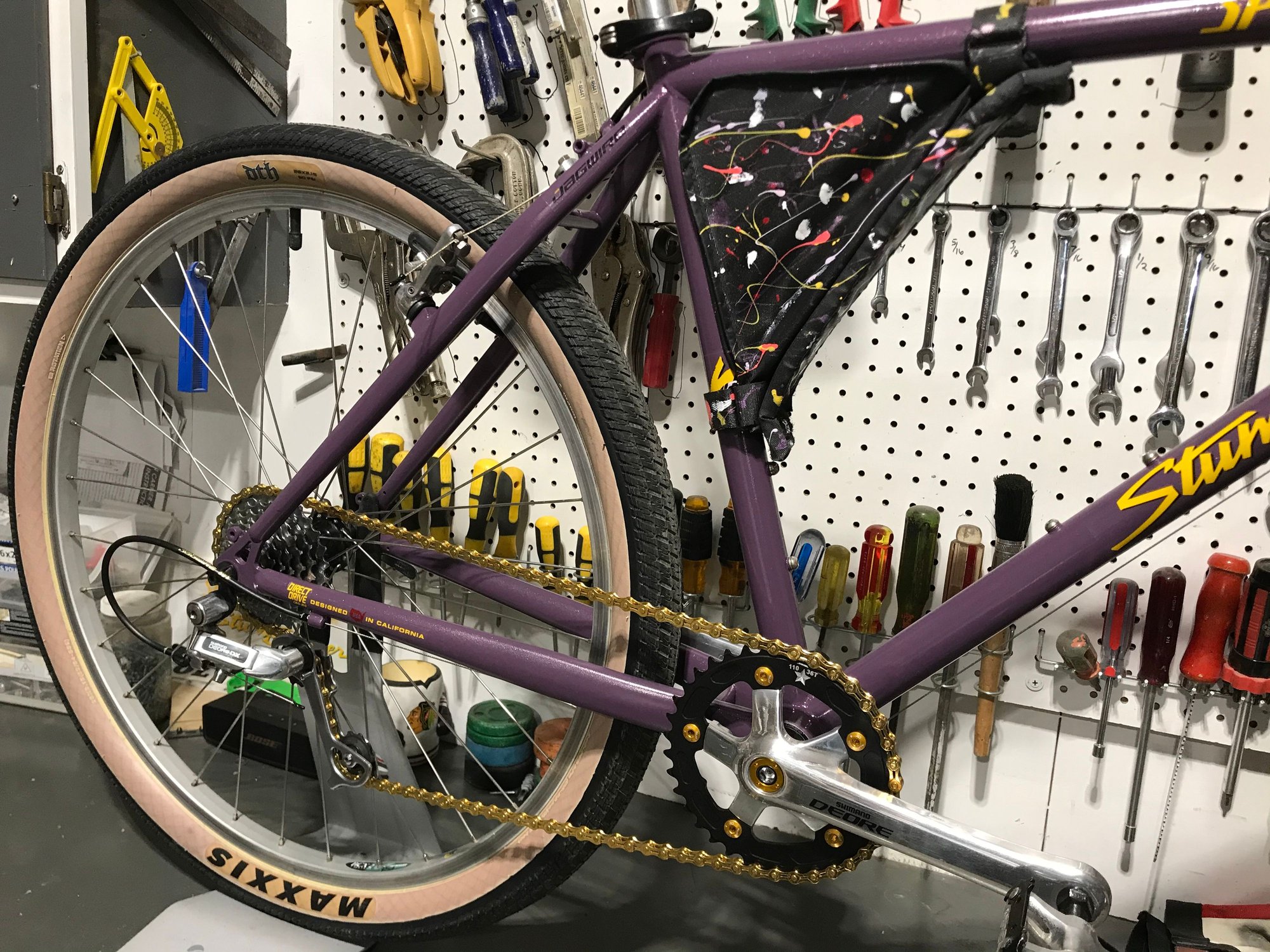

Need help
Gold chain and ring bolts
Nickel and black with bash guard silver crank bolts
So ultimately i want the chain ring on the outside of the crank legs but the chain line to the larger rear ring is pretty bad. So i moved it to the backside of the legs. Not wanting to see the step down on the crank legs i cit the teeth off the old outer chain ring ground the circumference smooth then sanded 320, 600, 2000 and buffed. Want your thoughts on the look. Yes no whatever. Gold chain to much? Wifey says it is lol and she is pretty smart. This is a cruiser now not a rough trail rider.
victorm is offline
A narrower BB may correct your chainline, but the inner position is correct for the original BB and watch for crank arm strike. Colored chains are not my thing, and gold is not my fave color by far, but its your bike. Proper chain length is a bigger deal than color for me.
DorkDisk is offline

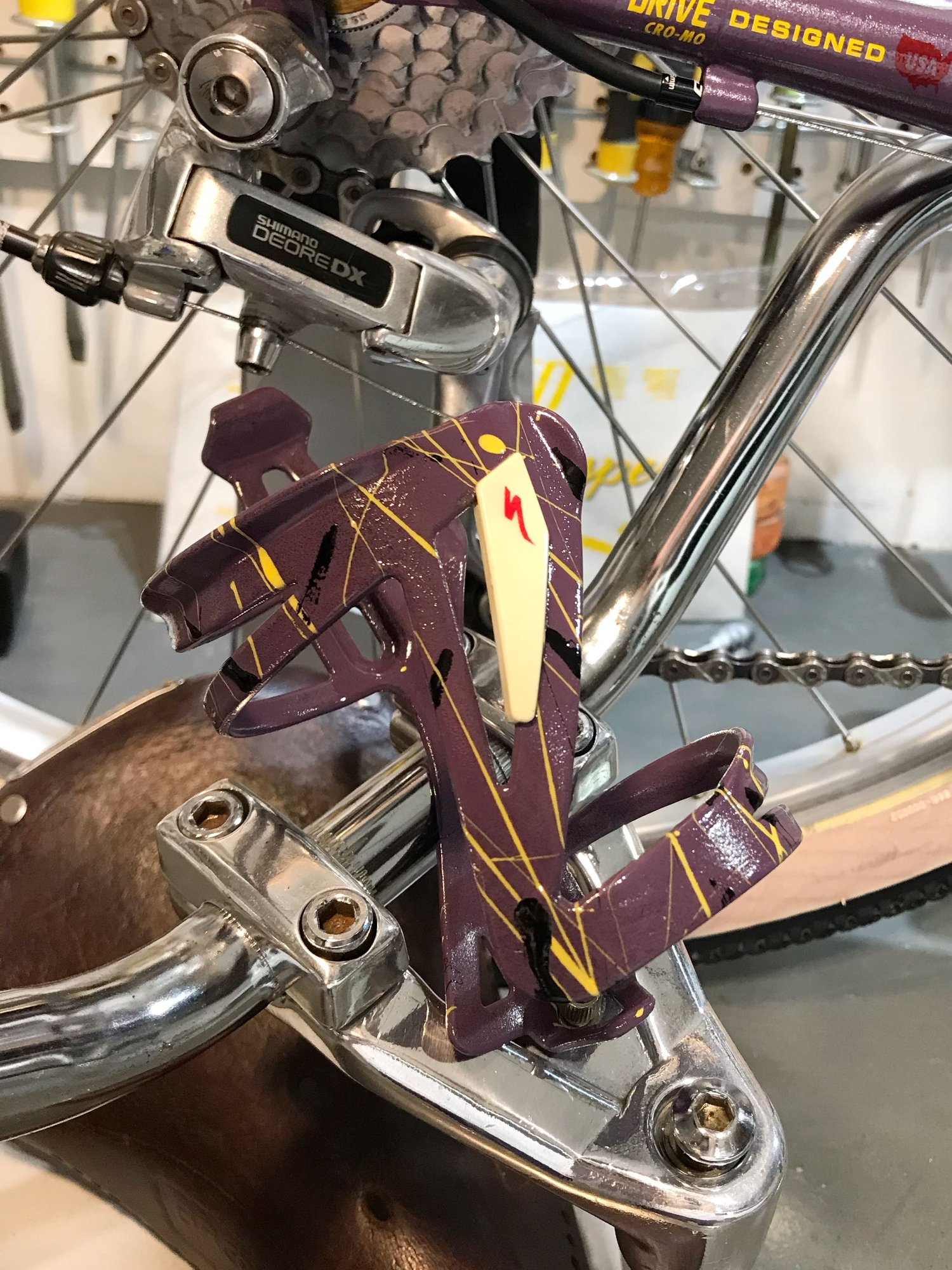

Quoted: 33 Post(s)
Liked 154 Times in 67 Posts

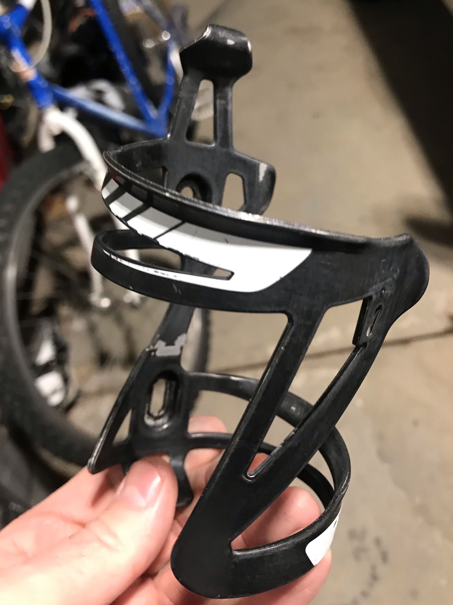

Original Alloy Zee Cage
Was pretty disappointed when I first got this Zee cage of Ebay. Color wise it looked like dreck on the bike. I was struggling with what colour to paint it. I ended up going with the same colour as the frame then hitting it with the yellow and black nail polish. Love how it turned out. Once it’s had time to cure I will clear coat and post a pic of it mounted. Now for the right water bottle thinking Specialized Purist insulated bottle but what colour hmm. It’s all part of the fun right...
victorm is offline

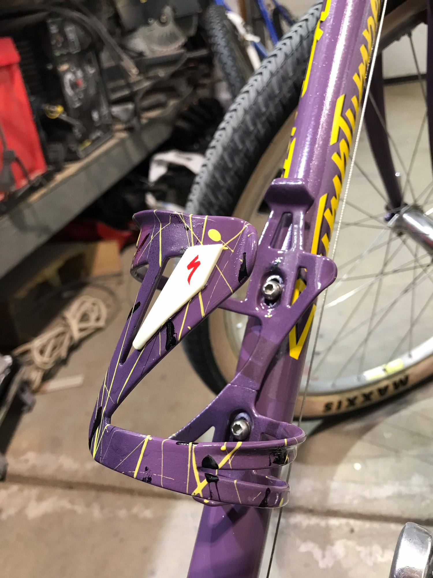

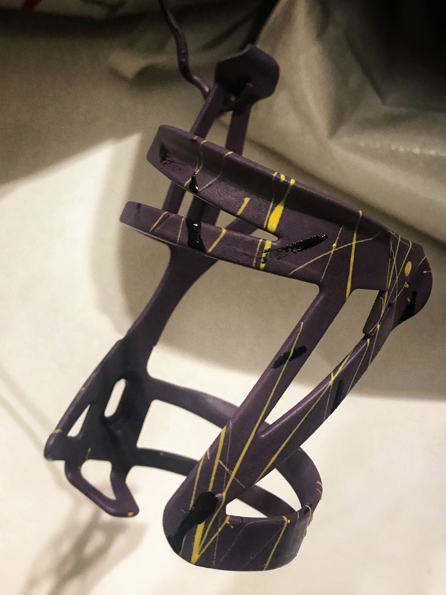

Bottle cage is done
victorm is offline

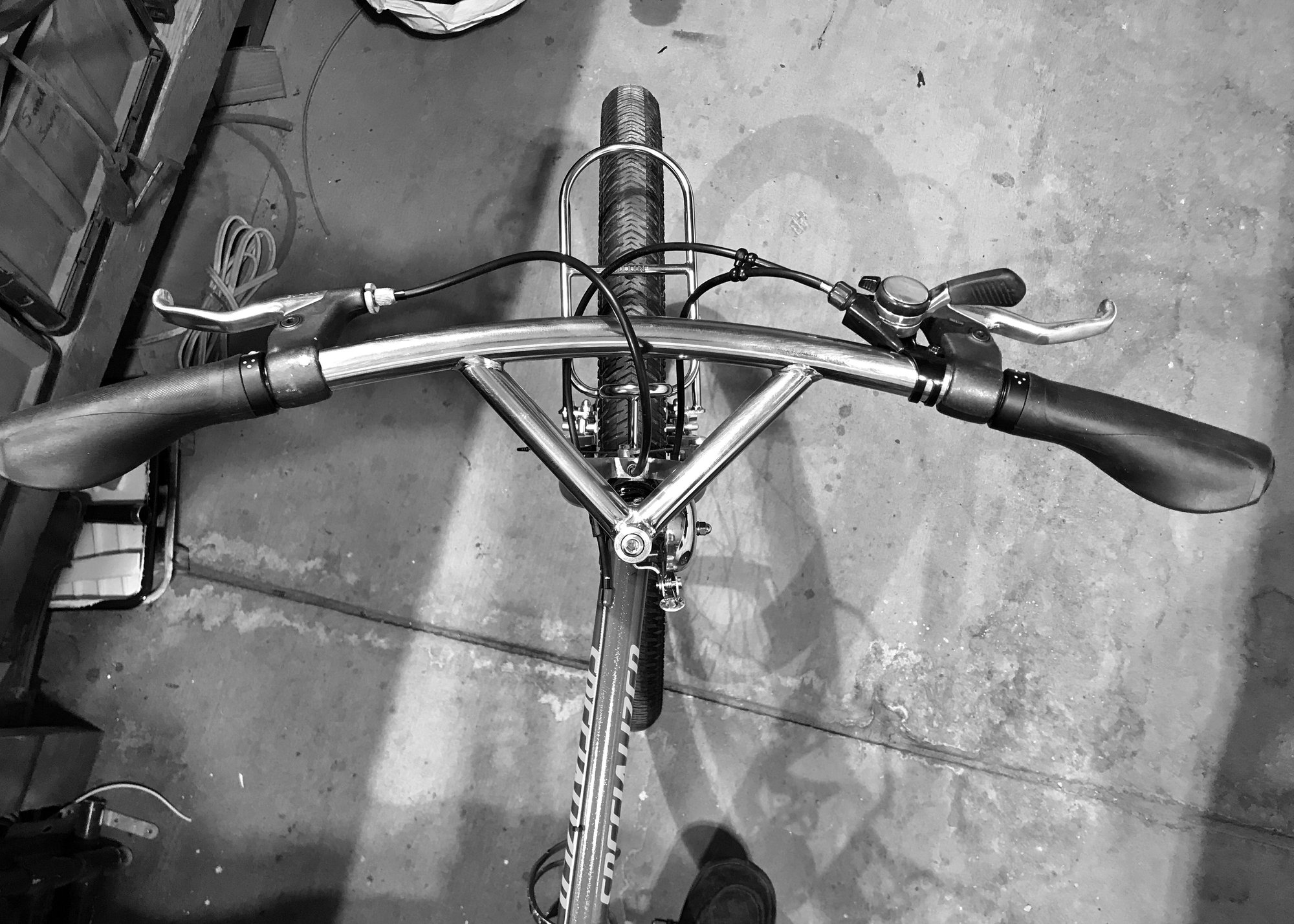

Cockpit
the PNW grips were nice but looked to modern to be on this bike. Decided to go with the Specialized BG Concepts grips. Can’t beat the hand position of these babies plus my OCD is satisfied because they are Specialized. Couple things left before this ones done.
victorm is offline

Cockpit
Have this as my desktop background. Something about it sooths my busy mind at work. So many small details in the curves and cables. Sorry but I love it.
victorm is offline

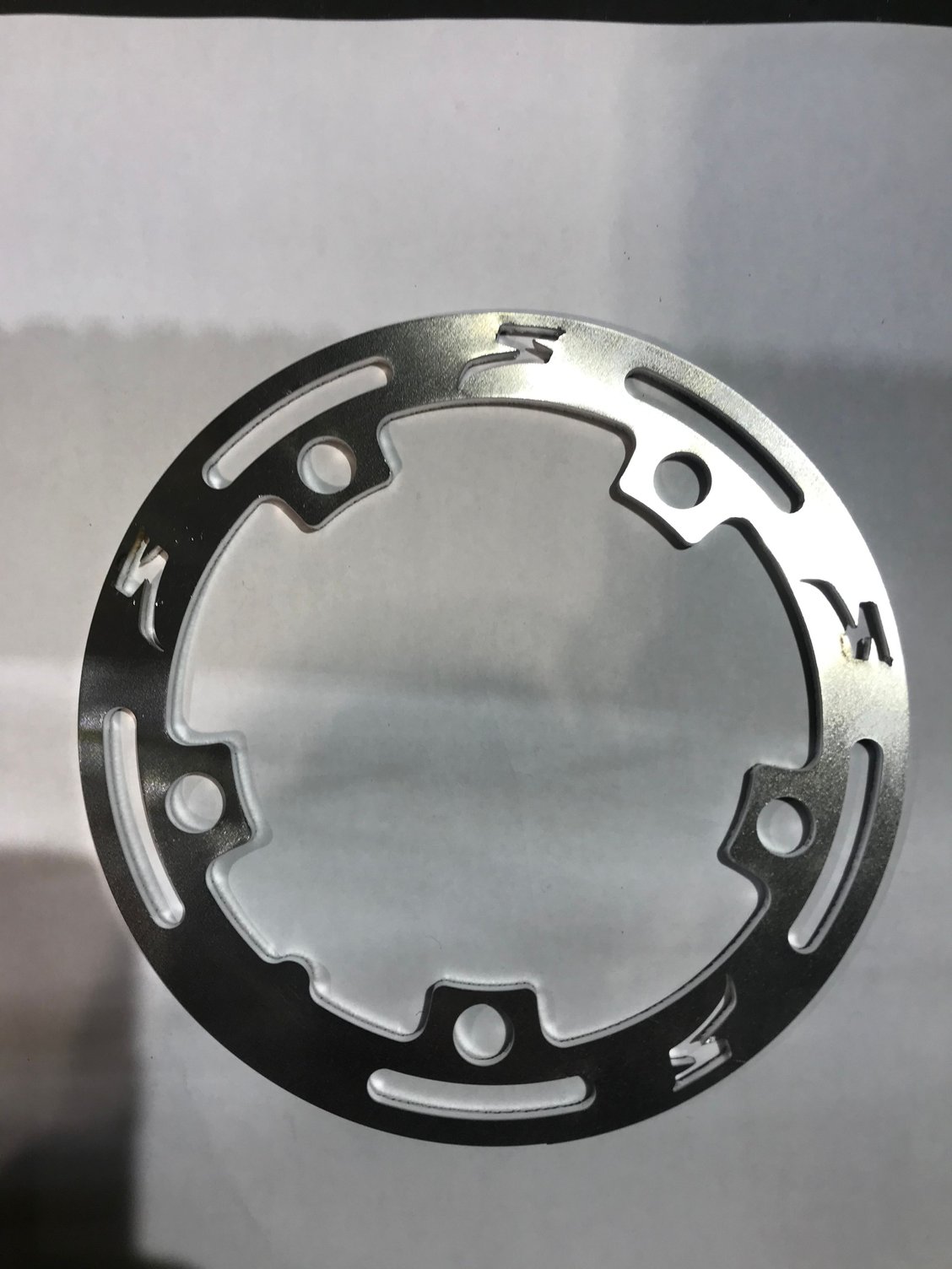

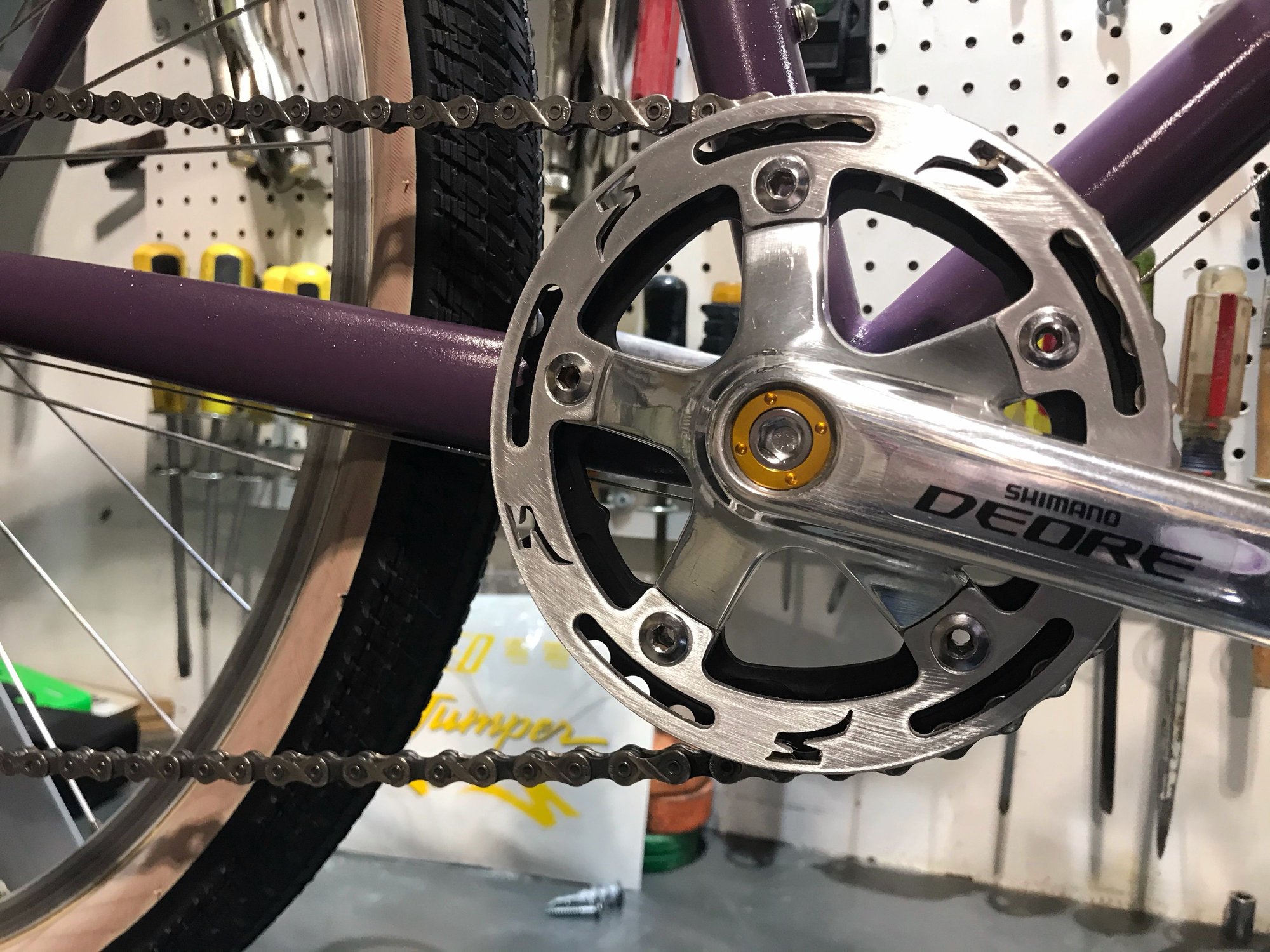

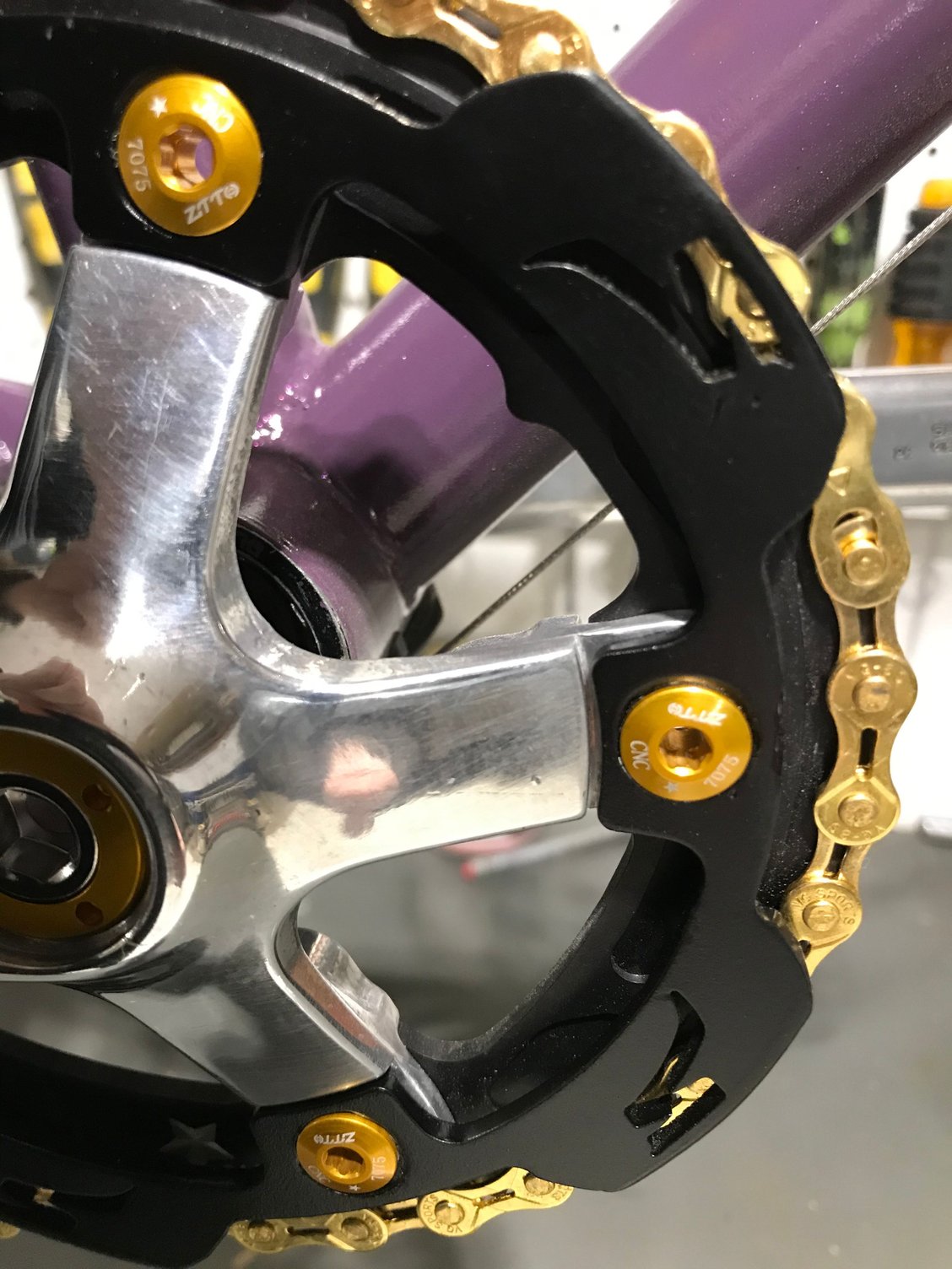

Bash guard progress
really didn’t want to see the crank arm end so decided to lazer cut an out bash guard guess you could call it. I took the finish to 320 grit to keep a brushed finish to offset the mirror finish on the crank arm. Let me know if any of you want something custom done.
victorm is offline

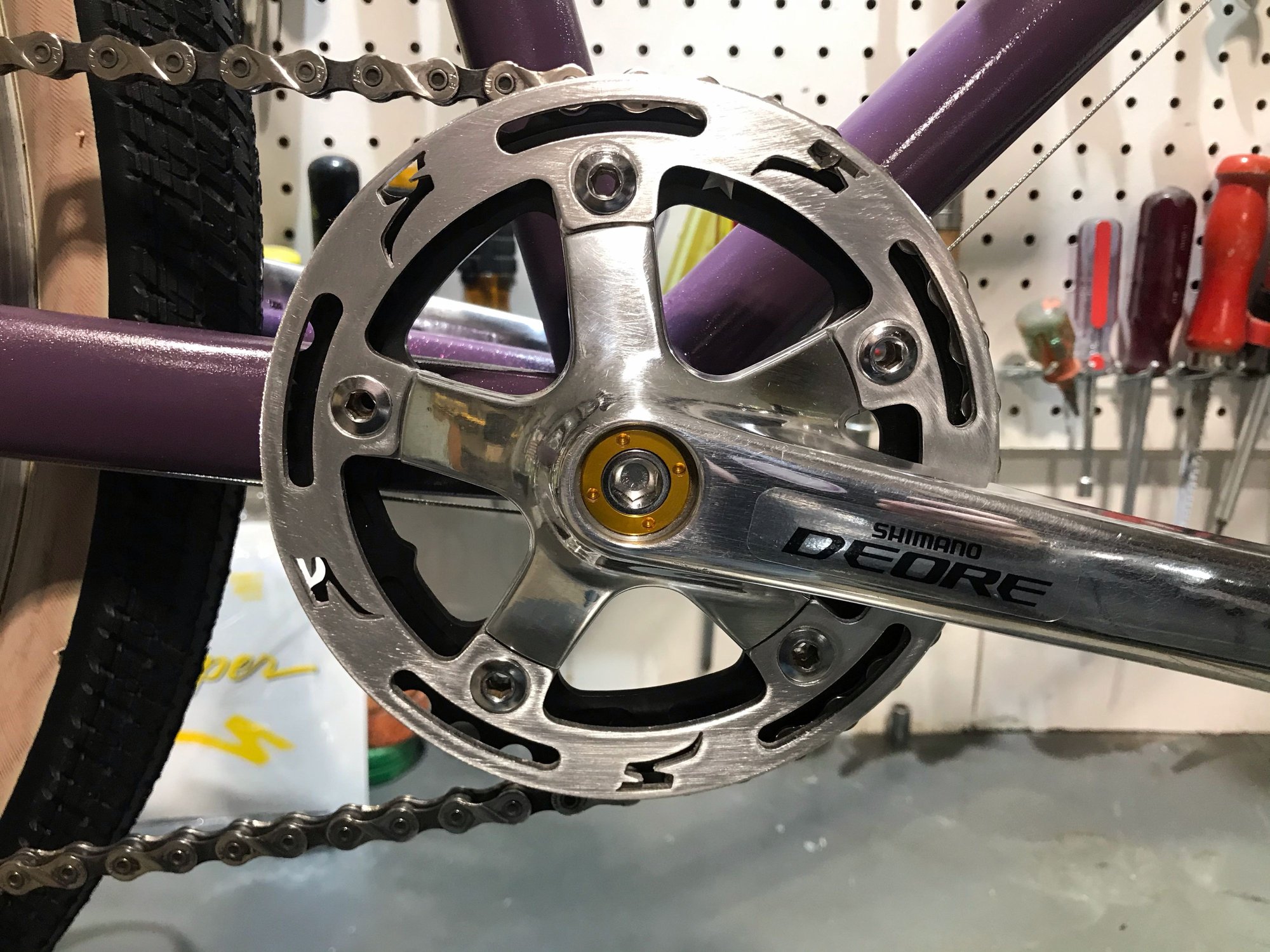

Final decision
All that silver looked off to me so I sprayed the bash guard with some self etching primer then some black Rustoleum and matte clear. Swapped out the silver chain and chain ring bolts for the gold. Much better and such a custom look. I’m a water bottle away from finishing. The Specialized Purist are sure in limited supply these days. Shark fin chainstay guard and maybe a Carradice Bagman would look good on her🤷‍♂️
victorm is offline

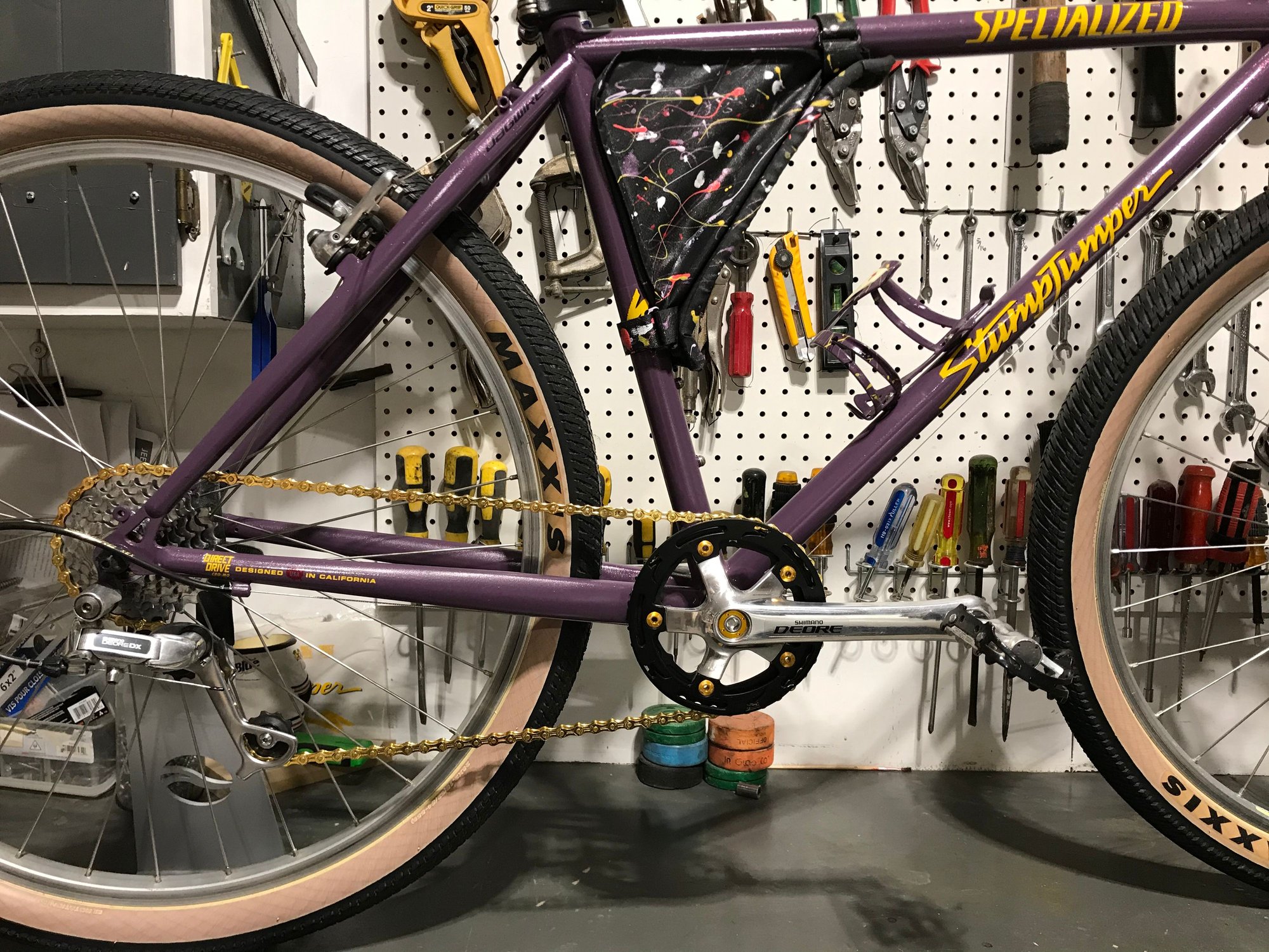

Final Alteration
the blacked out bash guard hid the chain more than I liked. I decided to zip off the long outer portion of the slots and am really happy now with the result
victorm is offline
