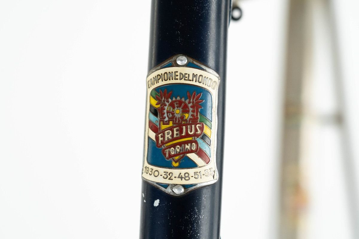

The seller claims this to be a "Campione Del Mondo" model from the mid-50's.

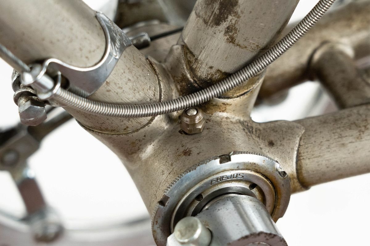

As you may have likely learned from your researches the name refers to a village of 2,200 souls in the extreme SE corner of France. It is best known for a rail tunnel.
Frejus cycles were produced during the interwar years and Emilio acquired the rights to the marque in 1946.
there will be a lubrication fitting on the NDS of the shell
pedals would have been either Way-Assauto or Sheffield

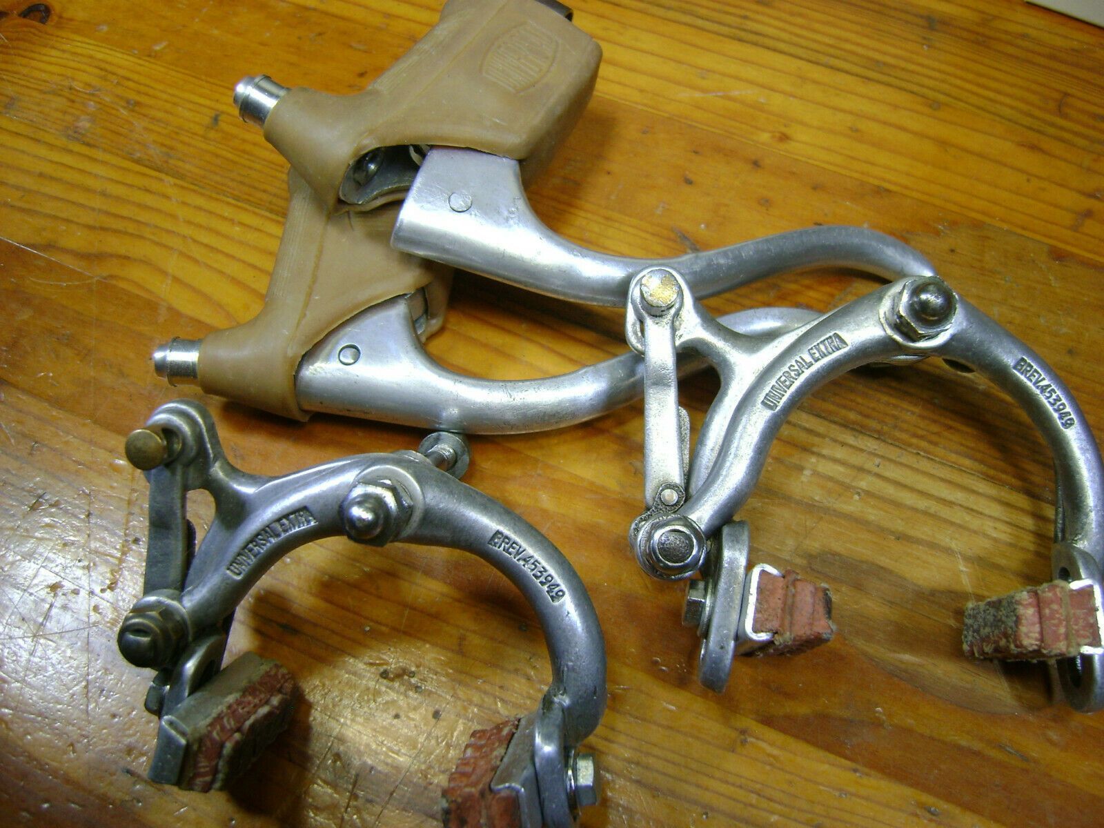

arrestors would have been either Giovanni Galli, S.p.A (Balilla) or Fratelli Pietra (Universal)
you may discover bb spindle to be hollow
the smallest inner c/w which can be fitted to these six-bolt Y-adaptor chainsets is 43T
count yourself fortunate that the Y-adaptors are of steel; they were also produced in alloy which were failure prone
smelling salts may be required when you find just what Frejus marked Gaslos cost... : ^ 0
tubeset is likely to be Falck
shall look forward to following along : ^ ]

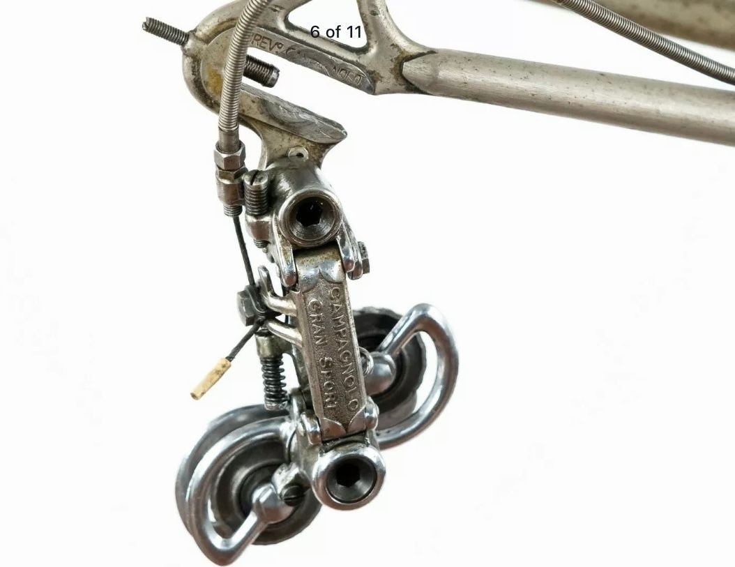

from the latest images it appears she came with a complete drive train
what further fittings may be required for the assembly into a complete machine?
forgot to include above -
likely stem & bar set would have been Ambrosio Champion
for this era stem could be either steel or alloy

I'm curious to hear more about the oiler ports on the BB and head tube. Does this mean the associated bearings are more of an oiled system than packed grease?
I will be breaking everything down when I get it, so will be able to peek inside the bearing races/bearings to see what kind of shape they are in. I'd normally clean then pack with Phil waterproof grease, but the oil fittings seem to imply another approach.
Bozzi continued to manufacture cycles with these fittings until surprisingly late; long after most others in the industry had discontinued their use
six or seven year back we had a Frejus come through with them which was able to date to the mid-1960's, forget now the specific year, a poster was surprised at this date post due to their presence, as the owner explored the cycle more fully it turned out to be on the money.
it is possible that someone at the co. had a strong belief in their use. me speculation has always been that they may have gotten a great deal on shells incorporating the threaded boss for a zerk fitting long before and continued to use them until supplies were exhausted.
consensus holding seems to be that they are a carryover from the track machines of the interwar years where hubs and brackets were oiled rather than greased with the idea that this would make them freer running.
just ignore them and do your usual Phil Wood.

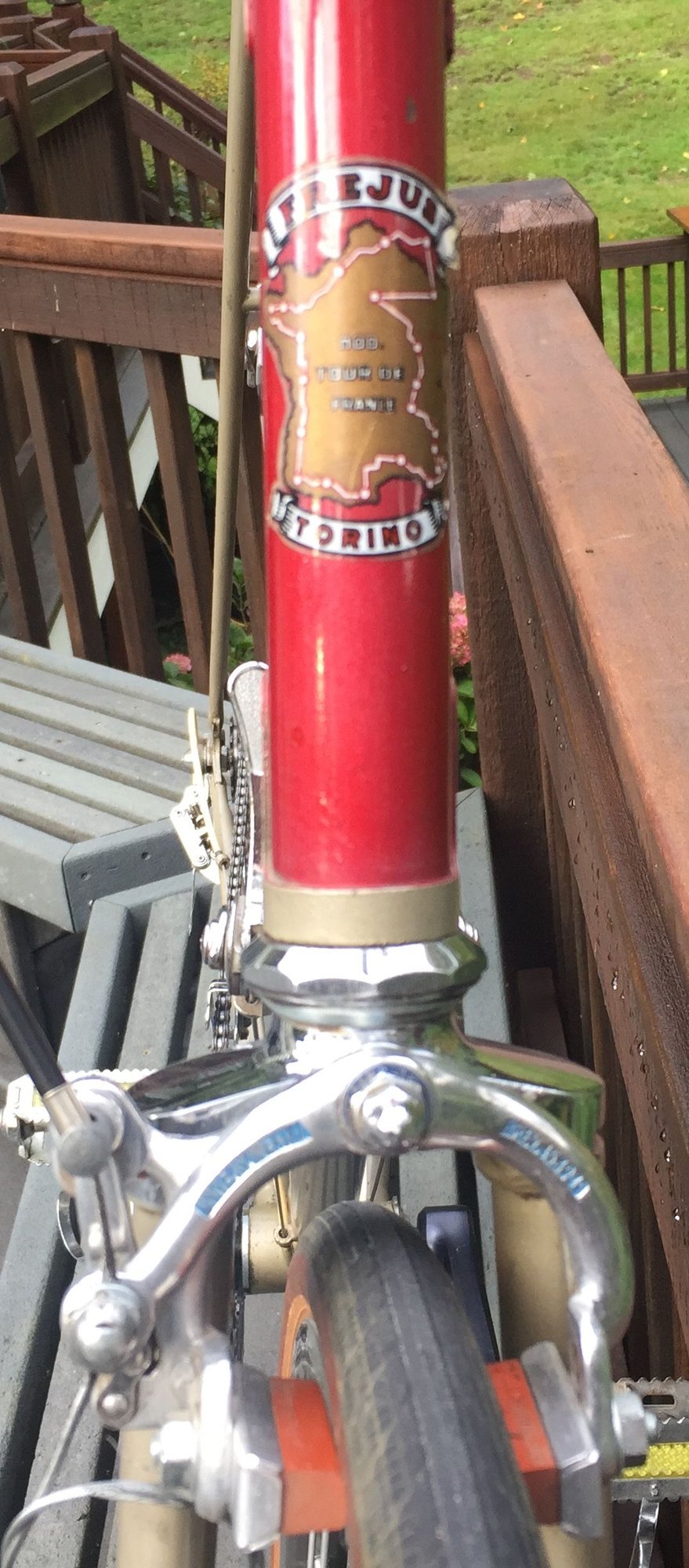

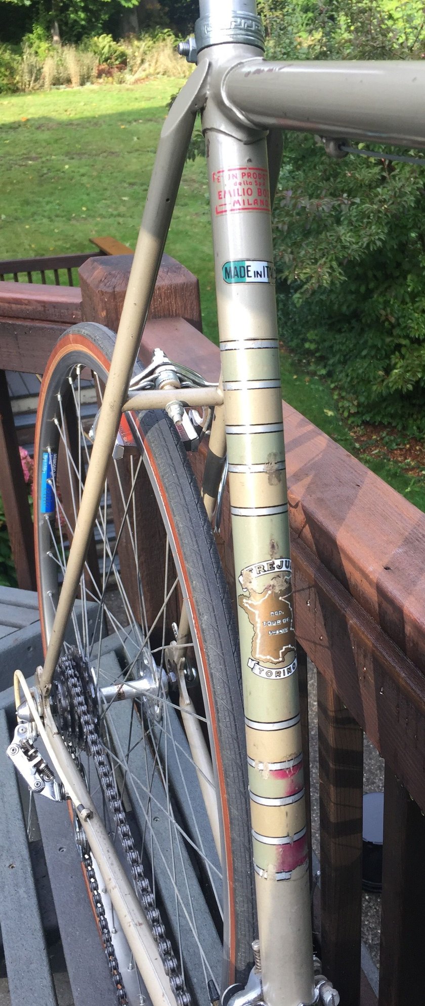

Nice buy! I was tempted by that many times, but held off because I have a 60's Frejus in the basement and I am leaning towards older bikes now. (Be careful, the slope is slippery.)
Apparently, all of my pictures I have of bikes to post are "as- received" when I unpacked them. I've got to get them out for better photos this summer. Maybe I need to get something polished up for the Spring Ride hosted every year by IAB.

According to this, it seems the models (such as this one) with the Campione Del Mondo headbadge are the “Super Corsa” models, and the Campy dropouts designate a “Campimissimo” model.
Cool.
Based on the headbadge on mine, the last year shown is 1953, which points to a ‘54 model (since it seems that subsequent years were included on the headbadge as time passed).
https://lancashirecyclelink.wordpres...11/frejus/amp/
https://condorino.com/2017/07/16/fre...zzi-brand/amp/
Cool.

dates on headplate -
these refer to victories achieved on Frejus branded cycles
the year markings are not all inclusive, nor do they go on forever
your head emblem can be a useful tool in date bracketing the cycle
as you examine the examples available online and here at the forum you can check to see what the next later date is that appears on a Frejus headplate to bracket the date of manufacture of your example

I derived '54 by the same methodology you mention. Specifically, the last date on mine is 1953, and I had found this image of a later model, clearly including '54.
I assume that the prior year's victory would only begin appearing on the subsequent year model. Therefore, since both '53 and '54 are found on the later headbadge, I believe mine to be a '54 since the last date shown is 1953.

I have a full Universal Mod.51 brakeset on its way now.
Next up, hubs and rims...... Looking at Nisi, Ambrosio and Fiamme for rims, and Gran Sport (of course) for hubs. I'd LOVE some input here, as I don't want to end up with something sketchy. I intend to ride this bike. Tubulars, of course
Now, I'm 99.9% sure I'll need to replace those brake pads. Open to suggestions.....
Side note: at least the seller could've flipped the reversed brake pad before the photo shoot

hope you measured frame's brake centres prior to sending off for those Pietra 51's...
their centres are 50.5mm and 64mm
