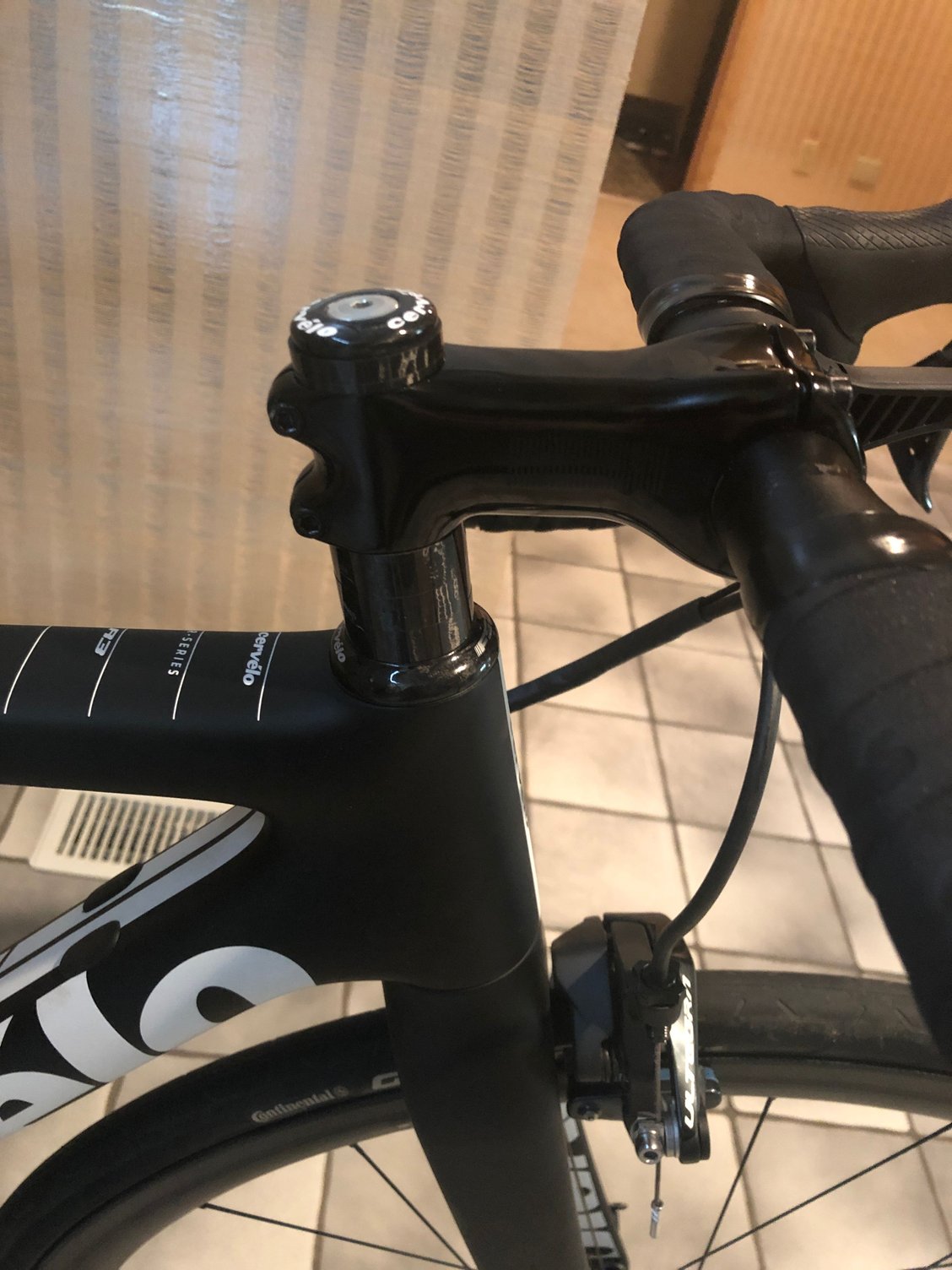

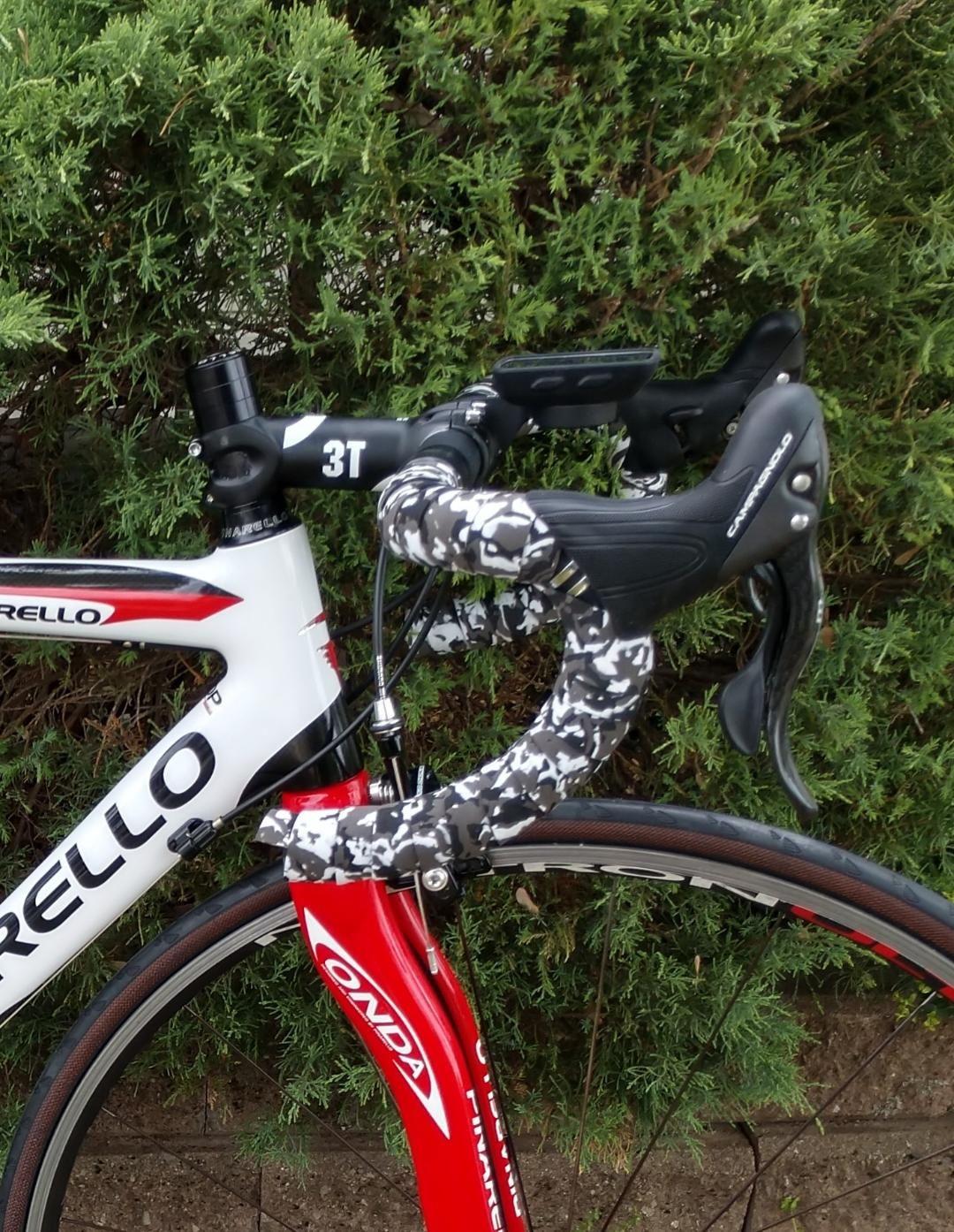

The Pinarello and Cervelo with the tall periscopes? Yeah, those aren't good. With carbon steerers, the compression plug needs to be able to support the steerer where the stem is clamped. Unless you've got an uber-long compression plug, you're not doing your steerer any favors.

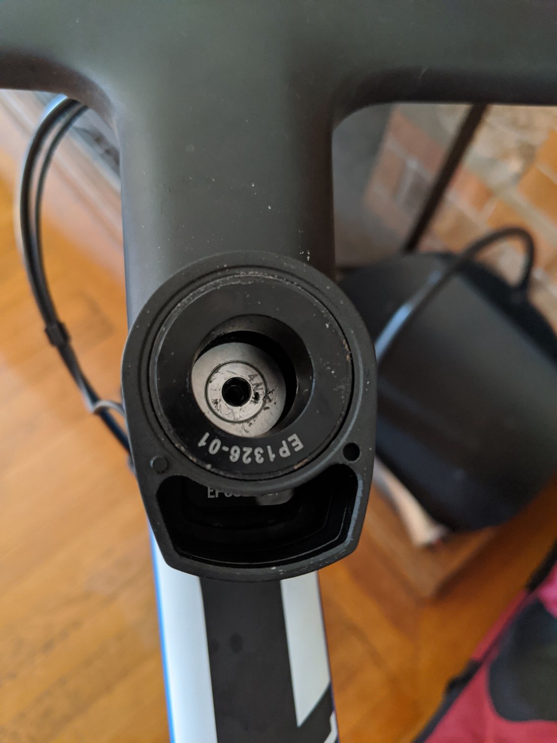

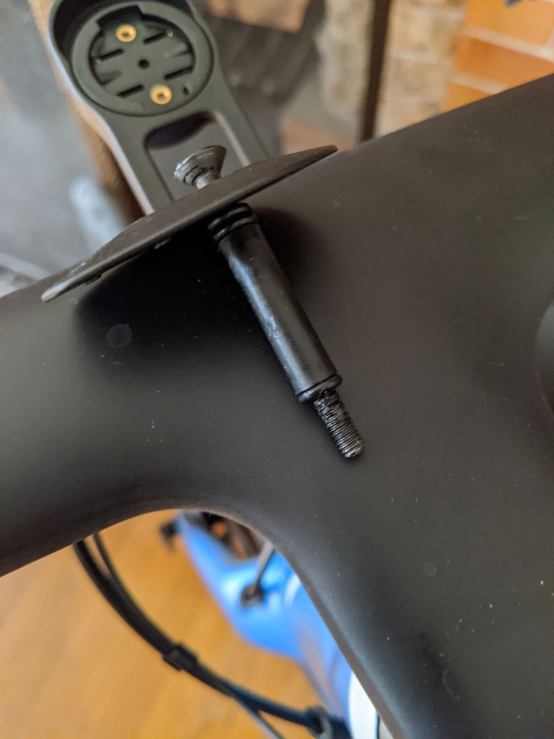

Fortunately not at all a problem on Canyons. I don't know what this type of headset is called (zero stack internal?), but there's a plastic bushing and two rubber O-rings over the screw, and cutting the steerer only requires cutting that bushing to match. The cap itself is just a thin piece of plastic and I can't imagine it has any structural significance.
