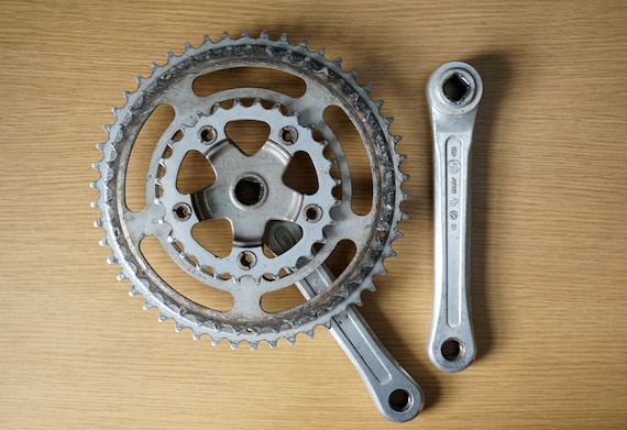

86 bcd crankarms would work. I have a couple of sets at my Lancaster home waiting for me to arrive.
Both Stronglight 80, 99, and 100 crank arms and SR Apex Cranks are 86BCD, they can go as low as 28t

48T (Tioga) 36T (Shimano SG-X) and an Onza stainess steel 24T...on venerable Shimano Deore LX M560 Low profile cranks ('94) with an 11-28 8 speed cassette. That brings back some fond memories of rodie chasing on Sundays many moons ago.

On a 1983 tour one of the people on the tour used a TA 50-28 double.. 13-28t freewheel
Now modern stuff, I think you would get a White Industries VBC crank, SQVBC ? White Industries
Or Rene Herse Cranks https://www.renehersecycles.com/
