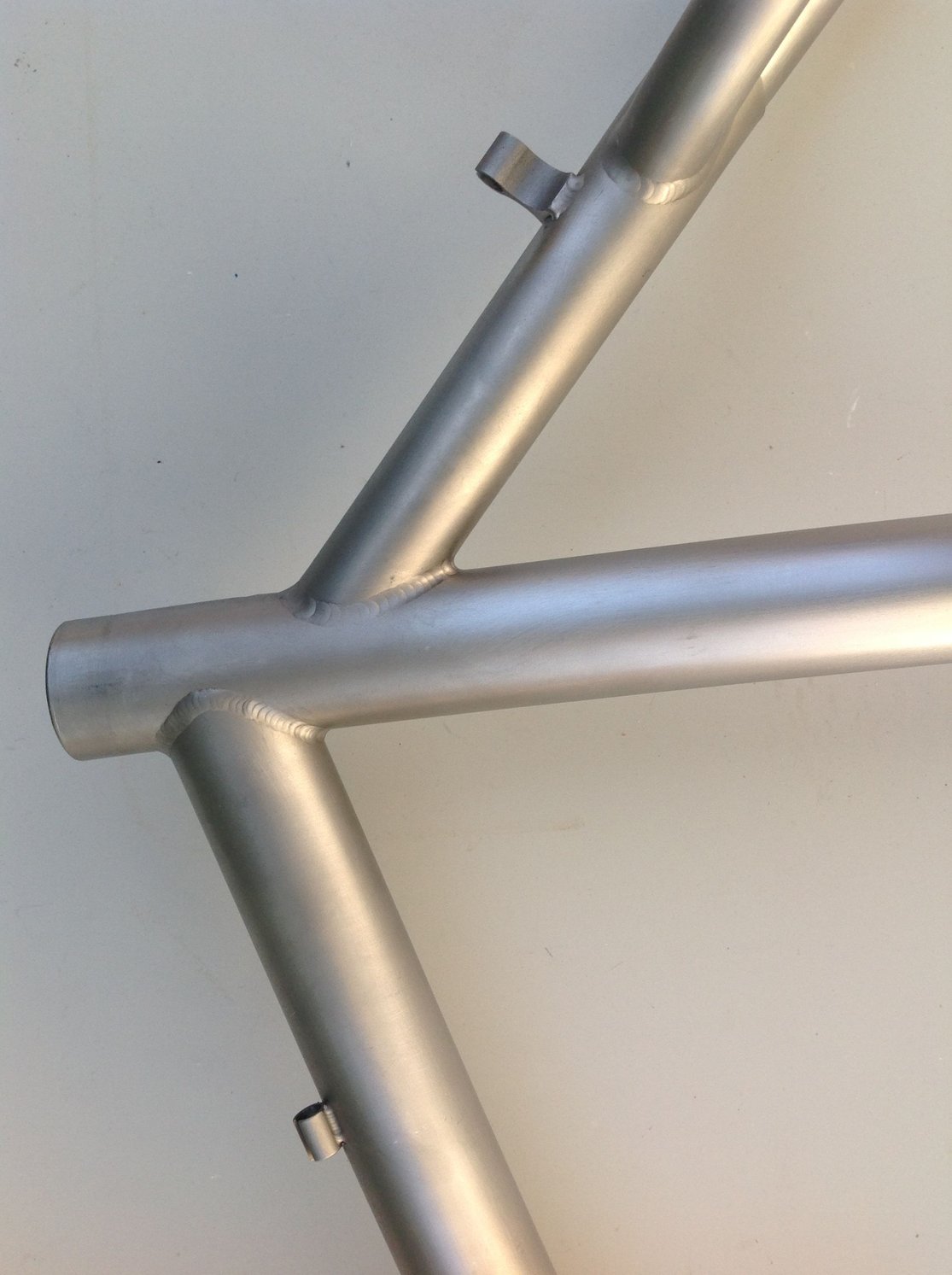

I bought a titanium bike locally for the XTR parts (frame not my size). All the identifying decals have been removed, but the owner told me it was a Performance brand bike. Anyone know what I bought? Is the frame worth anything? If it is the house brand for Performance, where was it made? From the components, it looks like early-mid 90's. The S/N is CTB3A31022. Any help would be appreciated.

An online search should tell you whether Performance manufactured a Ti frame of that design. If so and no cracks, it should be worth $500 (to me). Any cracks would reduce its value by at least 75%.

I sure cannot help with any specifics on the frame. I do know that Performance had a pretty good reputation with the frames that had their name on them. What size is the frame? It looks like my size and I really like the looks. Any thought on moving it?

FWIW, I recently sold a more desirable Litespeed branded Ti MTB frame for quite a bit LESS than the amount above. I was disappointed, but that is where the market is right now. I've owned some nice vintage Performance branded bikes, they never have done as well as the branded stuff.

Older MTBs typically have low value. Older ti typically has lower than you’d expect value. Mystery ti has usually has low value. I’d be shocked if even good
marketing got you near $500. I’d guess $200 tops.
Performance would have had them made by a third party.

There was some ghosting left from decals removed from the top tube identifying the tubes as 3Al-2.5V Ti. I have found that Performance offered Ti bikes from '93-'97 - from the components, the frame is closer to '93 than '97. The bike measures 22" from the ctr of BB to top of collar. I could only find the unique seat stay on Moots' PsycloX, MootoX and Routt... I'm hoping they could be the third party builder.... but I really know nothing about MTBs. No dents, no dings - but some scratches from chain drop.

I don't think Moots built contract frames for anyone else. The company is still around if you want to check the SN with them.

I'm skeptical that a no name TI MTB frame can fetch $200 given that you can buy high end vintages MTBs complete for that price or considerably less.

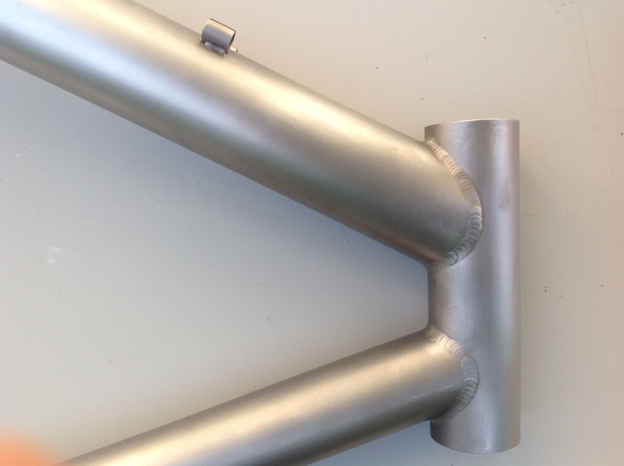

The welds suggest the frame wasn't manufactured by Moots (their welds are impeccable on all the frames I've seen), but the size of the "scallops" and designation suggest (to me) the same Ti formulation as still used by the industry.

Looking at this frame some more I would agree it is not top end. The welds look great on the top side of head tube and top of bb but not so great on every place else which is typical of Tawian produced frames of all levels from the 90's.

All the Ti bikes I have owned (several Litespeeds and a Merlin), the welds were worthy of hanging on the wall as art work, beautiful. This one isn't. Some of the BB shell welding, along with the chain stay bridge, look particularly uninspiring.
None of this should affect the utility of the bike in any way.
