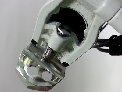

Brompton: Hinge bolts out of Alu
Proper securing of hinges on a folder is pretty critical. Yet manufacturers can come up with something so ridiculous as aluminum bolts securing the hinges. In the case of Brompton I came across such a product (below) sold under Parsche brand. The bolts were additionally thinned at places to add some functionality. The product has since disappeared from the market, but from the description I fear that there are other offerings around with alu bolts for hinge clamps.

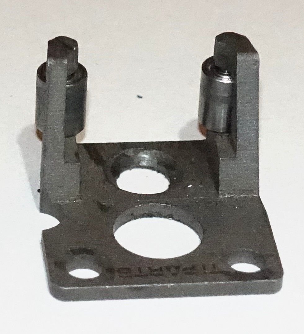

Brompton: Chain pusher with Rollers
Chain pusher on Brompton moves upper tensioner pulley to direct chain on one or another cog. Aftermarket pushers are equipped with rollers there to reduce friction of the pusher claws against the pulley. You can get such pushers out of Ti, alu and carbon. The rollers vary between steel and POM I think.
On a stand the rollers indeed work well ensuring accurate shifting. Unfortunately, the real life situation is dynamic: the chain pushes against the pulley, the tensioner arms flex, chain jumps around. The end of the roller directed towards the pulley presents an edge that the pulley can catch. The chain let loose can push against the other edge of the pulley and escape from the space between the pulley and pusher. In fact after a while I found it impossible to end a ride without the chain escaping and taking the derailleur out of operation. I tried both original Brompton pulleys and aftermarket with the same effect. Complete disaster.
One of the photos shows the situation after a ride, with the chain having escaped the upper pulley. One other illustrates the catching of an edge of a pulley against the roller.
A Ti Pusher with Rollers
The tensioner arm may flex a bit but the shifting pulley axle cannot flex that much, unless one of bolt is loose.
The chain transmits a lot of force - after all it propels the bike. The pulley axle bolt provides quite a bit of leverage. I know that it can be hard to believe, but every time this Ti Parts pusher is put on the bike, the chain will free itself mangling on the way the tensioner pulley. The only question is whether this will happen before the next corner or two more blocks into the ride. I put the pusher on and took it off and swapped the pulleys. I can leave a loose bolt once in a blue moon, but not every time this pusher goes on. The chain never ever freed itself with the original pusher that is now back on the bike - for now everybody lives happily until I try another junky aftermarket part By the way, as may be evident from the photo, the width of the pulley fills in practice completely the space between the rollers. You can only create an opening for the chain to escape by pushing the pulley away, nominally kept put by the tensioner arm.

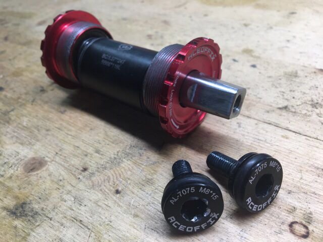

Example of Ti Not Being Titanium

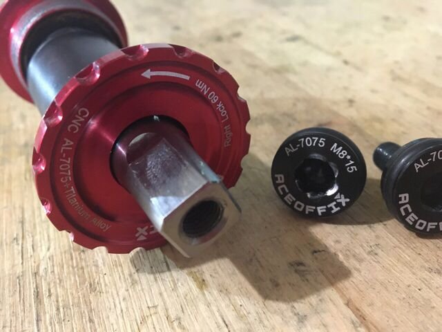

I bought an "Acceoffix" titanium spindle bottom bracket off Chinese Ebay seller. Says comes with "two kinds of TI bolt, black or silver".
Picture shows damage to bolt when my hand slipped while tightening. Um, no, it's definitely not titanium. Aluminum.
To be fair, the ad never said the bolts are titanium, only that they are "TI". Hmmm...
Note damage to "TI" bolt on left.
Spindle is titanium though. This pic is after being installed and then removed.
OTOH, the bottom bracket spindle is Titanium, and it does save about 150 grams. Just use steel bolts...
Aluminium crank bolts are just fine BUT you should fasten the crank using STEEL BOLT FIRST.
And that very bottom bracket is not recommended for heavy riders. I saw a number of failure cases. But I have seen people even ripping Shimano two piece cranks though.

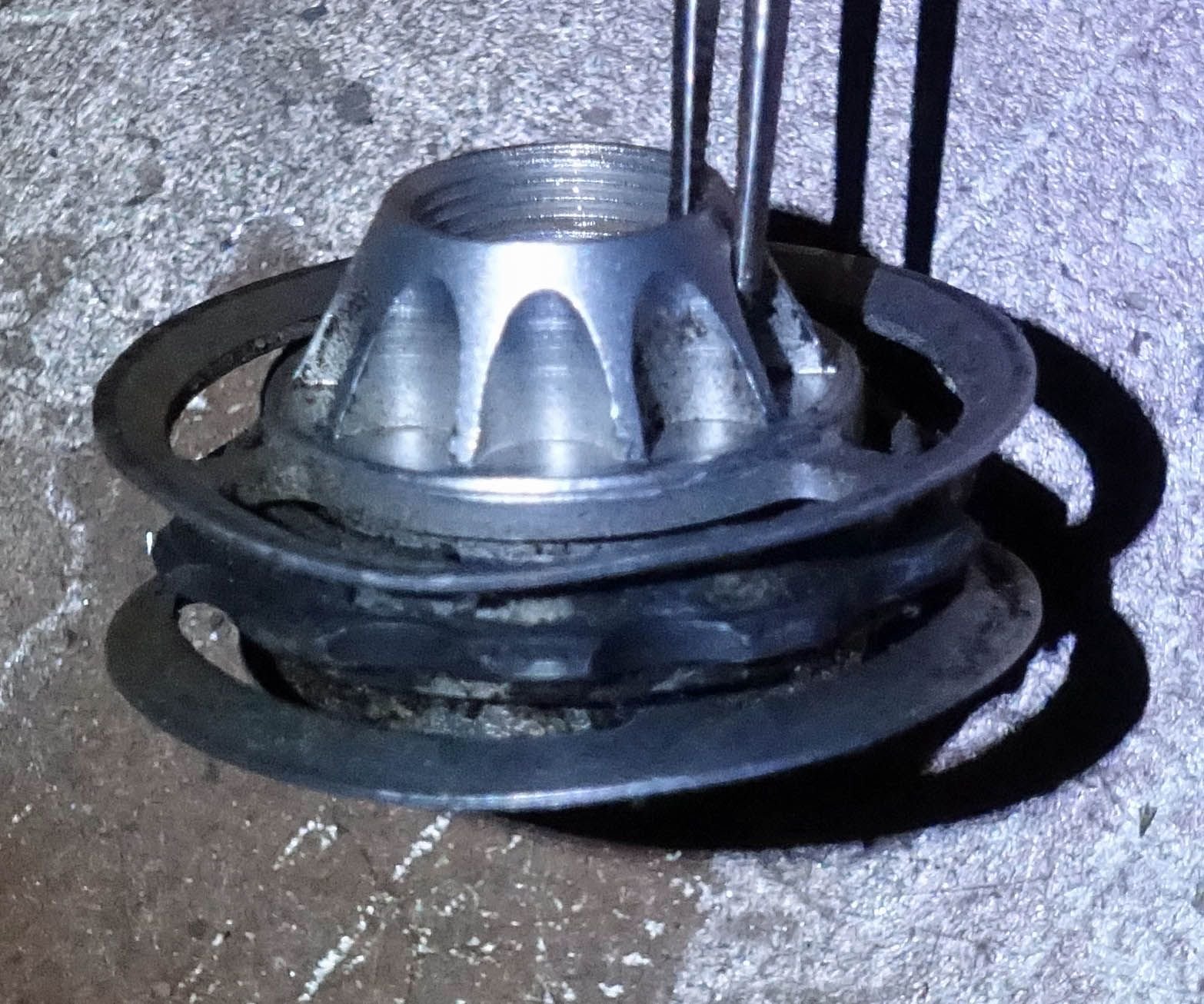

Brompton: Tensioner Pulleys by Best & Others (?)
The upper tensioner pulley in 2/6-speed Brompton is moved by a pusher to make chain move from one sprocket to another. The original pulley is out of one solid piece of plastic which can rub against fingers of the pusher if the system is not tuned perfectly, which shaves over time the sides of the pulley. With this aftermarket alu pulleys where the teethed part of the pulley that engages the chain is separated, and rotates on a bearing, seems like a big improvement. The problem is that the remainder of the pulley with sides that retain the chain can be made very thin, presumably to save weight.
Take the pulleys from Best, possibly sold under other brand names too. The retaining sides are in the form of thin circumference rings supported feebly just at 3 points around the pulley. The chain obviously fights against the retaining rings and the latter get bent. As the pulley sides, here the thin circumference rings, are grabbed by the pusher to switch gears, the shifting goes to hell. To function well, the pulleys must have strong retaining sides.
Marketing Photo of Best
Beat Up Best (?!) Pulley
Shifting Depends on the Angle around the Axle This Pulley Takes

I am thinking about getting this. H&H seems to do nice stuff.
I bought this pusher at some point and resold it without even trying to put it on. The rollers are plastic which for this small diameter is an issue. The rest is out of alu that, in my view, will not hold its ground in any serious glitch.
Thanks for the info.
Its something that I don't really need but thought that having side bearings would better than metal guide.
Myself I went back to the original Brompton pusher. However, in fiddling it became apparent that shifting, particularly for 3 cogs, can be well improved over that with the original Brompton components. I know for sure that it can be achieved with aftermarket pulleys, or even one top pulley, where the teethed middle moves independently on a bearing. In the latter situation the sides quit moving at all, so there is no need for any rollers in the pusher. Still a pusher with rollers may have a potential to be more precise.
The above is from using the Best pulleys at those times when they were straight. I ordered pulleys with seemingly stronger sides than Best, marketed under ACE. They have no holes on one side, for crud dropping out, seemingly to put graphics there, but I can drill such holes mimicking what is on the other side. At this point I am 3 weeks away from my base, though, and I will be able to tell whether the plan pans out only after returning.
2_i is offline
