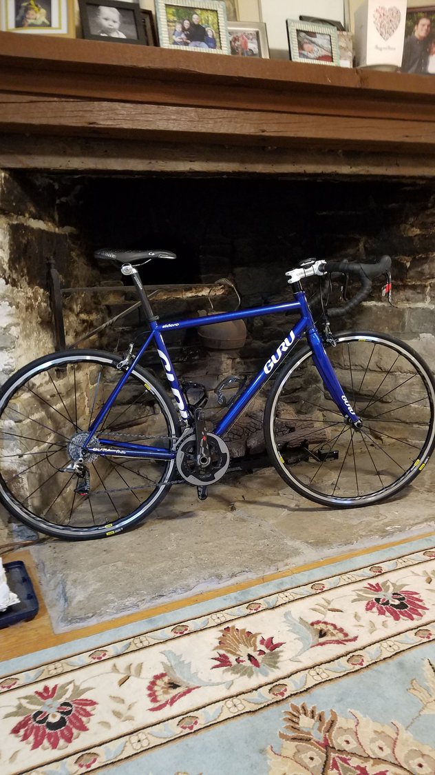

If it's levers and derailleurs, you're going to get the best results from changing them as a package, and using matching parts. That said, there are some miss-matched parts that work just fine together. With pretty much everything else, as long as you pay attention to the sizes that interact with other parts, upgrading individual parts is just fine.
I've owned over a dozen frames in my life. There are only 2 that I bought as complete bikes, and those both evolved with upgrades over time. When I decided to replace the frame, the old parts would be hung on the new frame, and the evolution would continue.
My current ride sat dormant for 15 years before my recent return to riding. Over the past few weeks, I've replaced the wheels, tires, stem, and saddle. The wheels and tires were replaced together, but that was mostly of a matter of them both being delivered on the same day. I have a planned upgrade to levers/derailleurs/cassette/chain that I've been gathering parts for that will will get done all at once because none of the parts are compatible with what is currently on the bike.
