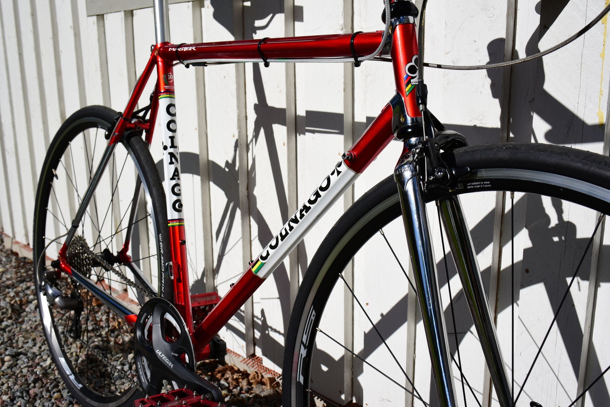

Here is my new good weather commuter. As we all know steel is real. Took me about 5h to assemble it and now its done!
Its a 1x9 with 42 up front. Apex brakes. 130€ shimano wheels. Sora 11-30 cassette. 105 rd. Full length housings. Thomson 40mm stem with reducers down to 1 inch, cane creek levers, xt 9sp shifter. And those with a keen eye will also noticed the stem is slammed lol.
My old commuter had to sacrifice pedals and seatpost/saddle. I'm giving the old one to my dad and he doesn't like those saddles anyway. the old one is an "english 9-speed" except nothing on it is english. Being Ti it rides great. I just hope dad dont motorize it. He has a bad habit of motorizing all his bikes.

Interesting shifter placement.
why full housing...weather? If so, why a steel frame?
I have many different handlebars to try out. 3 days ago the vision bar was on the lynskey (with discs). Took about 45min to adapt it to the colnago. I even reused the cables. Also I'm not sure about some of the components like the brakes. so if these turn out bad its quick and easy to swap in new ones. the brakes seems good enough though.
I grease and oil all cavities of my frames. this takes a long time. But its pretty good at preventing rust. at least 1,5 h yesterday was spent on greasing stuff.
As you all can see this bike is pretty much only built for practicality: 1x with chainguard, regular pedals, cheap cassette/wheels/chainring, able to shift/brake with gloves/mittens and so on. Its also the first rim braked bike I've owned in 20 years and I had no plans on building up a wheelset, trying it out and then find out that rim brakes sucks (and i can't use it). This whole set cost less than 1 good front hub. And i didn't even have to build them myself this time
I have some mavic upen pro ceramics laying around here. But its like a 10h project to measure/order/build these so it has to wait.

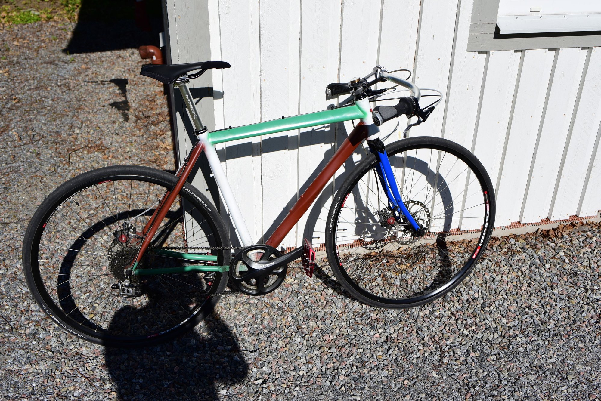

Today it was time for the 10km service I repacked the hubs with molykote and lubed the mech with teflon spray.
Also the headset needed to bed in and be tightened. And that was it.
Ride report:
I'm comparing this frame to my ti bike since i basically had the exact same parts on it drivetrain and cockpitwise.
Also the weight should be within a few 100g.
Brakes:
These are more gradual in nature than the mech discs. The discs starts powerful and then they are linear.
These ones start a bit weaker and then it builds up. I'm surprised of how good these rim brakes are actually.
Not far off the discs.
Comfort:
The ti bike is like a dampened spring. Quite firm, never harsh. Very comfortable
The colnago is very very similar. Maybe the ti bike is 5% or so springier in the rear.
But its very close. I would not be able to tell the difference blindfolded.
Power delivery and speed.
With the Lynskey I get the feeling that when I really mash hard it responds better. It reacts immediately.
However I have a feeling that this is not in any way measurable. It just feels like that.
With the Colnago I dont get this feeling. It feels like I am able to maintain a high speed easier though.
I'm sure they are just the same though.
On the Lynskey I'm running a tk540 out back, 32hole and 3x both sides, the Colnago has a 24 spoke 2x wheel.
This might be why one feels more responsive than the other, just a theory.
Steering and handling:
With the same handlebar but a 5mm longer stem the Colnago (it also has 5mm or so shorter ETT) feels more suitable
for this handlebar, not by much, just a little bit more predictable and precise. It feels like this handlebar is just
a slightly better fit for this frame. However, I could never get the handlebar this low on the Lynskey though
so that might be the only difference. The Lynskey has a surly disc trucker fork because steel is real
Toe overlap:
none
Paint durability:
Not very good it seems.
All in all these 2 frames ride almost identical.
Very comfortable and nice.
I'd say its a tossup which one looks better if the lynskey wasn't disguised.
One more high tech the other classic and cool.
The lynskeys are very good value considering how cheap you usually can get these.

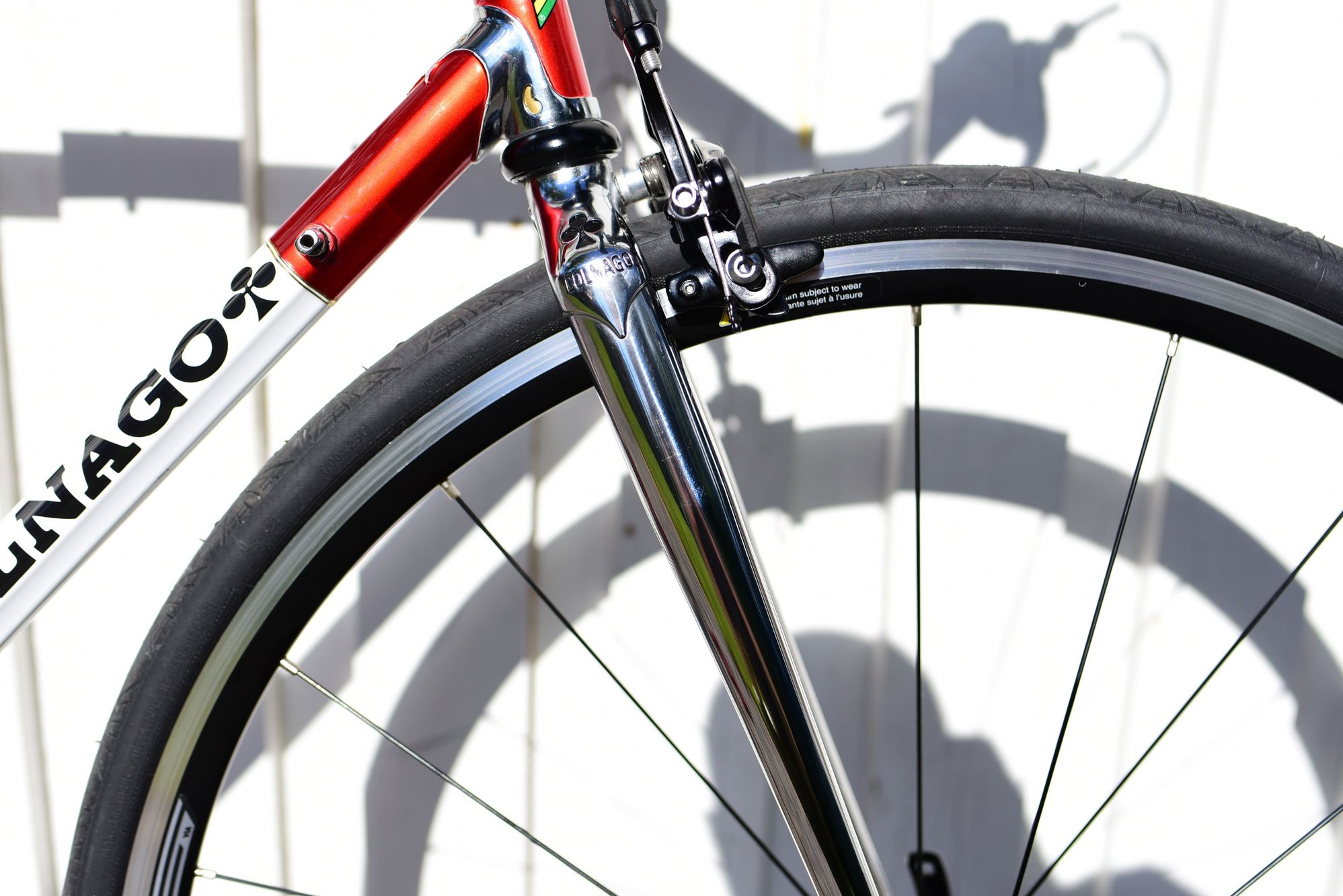

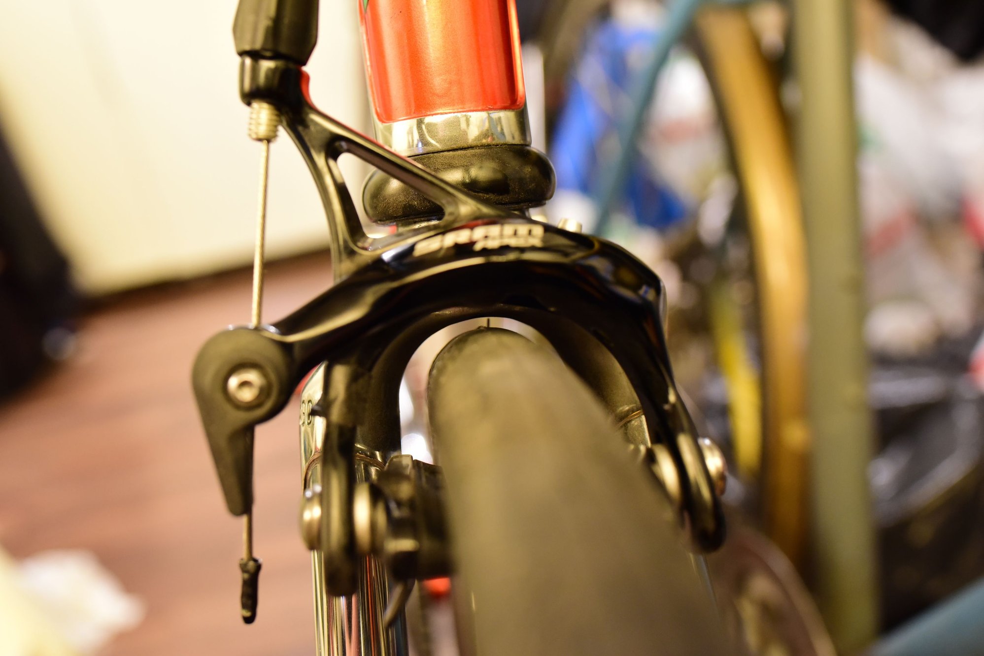

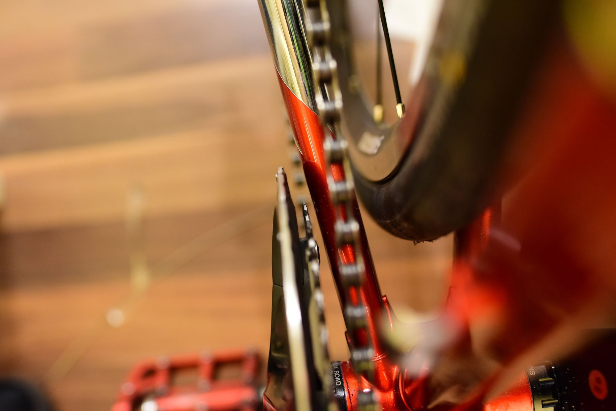

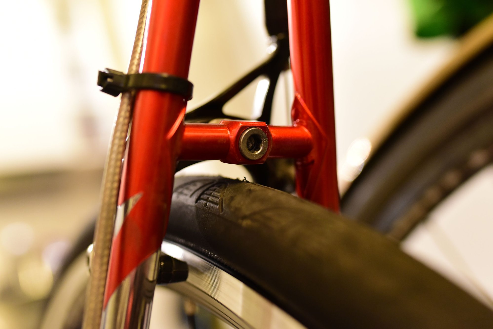

tire clearance colnago master
So I thought I should post some pics of the tire clearance of my colnago master. I'm running conti gp4k 25mm and they measure 26mm. When I was researching a lugged frames I was very interested in knowing what tires would fit. And I guess at least 3-4 more people on this very earth will find this interesting.
The fork has about 3mm clearance with these tires.
The chainstays about 5-6mm on the NDS and 7mm on the DS, and at least 40mm to the bb tube.
The seatstay bridge has 6mm exactly (measured), and a lot on the sides, like 12-15mm or so.
The 42t chainring has a clearance of 3mm. Its mounted on a road double in the inner pos and no spacers were used anywhere on the cranks or on the inside the cups.
I'm guessing a measured 26mm is about as big as you want to go up front.
And maybe a real 28mm out back. the gp4k 28mm is 30-31 though in reality. Might not fit.

shot some pics out in the sun today to try to capture the real color. I'd say these pics are quite realistic.
Because I dont like exposed cables nor downtube routing. So I simply don't do it.
