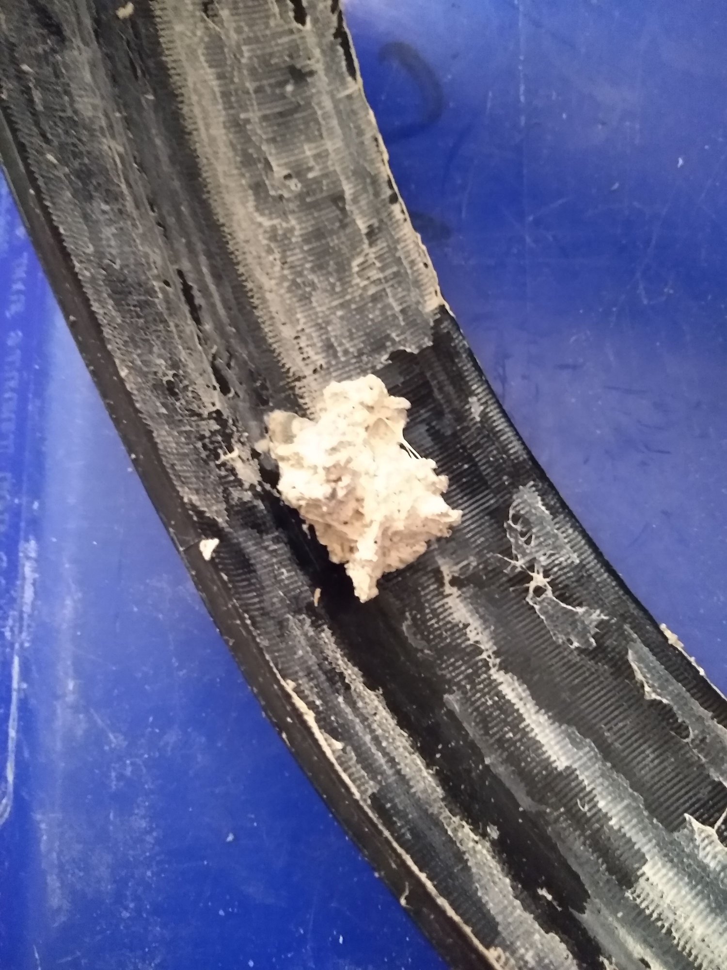

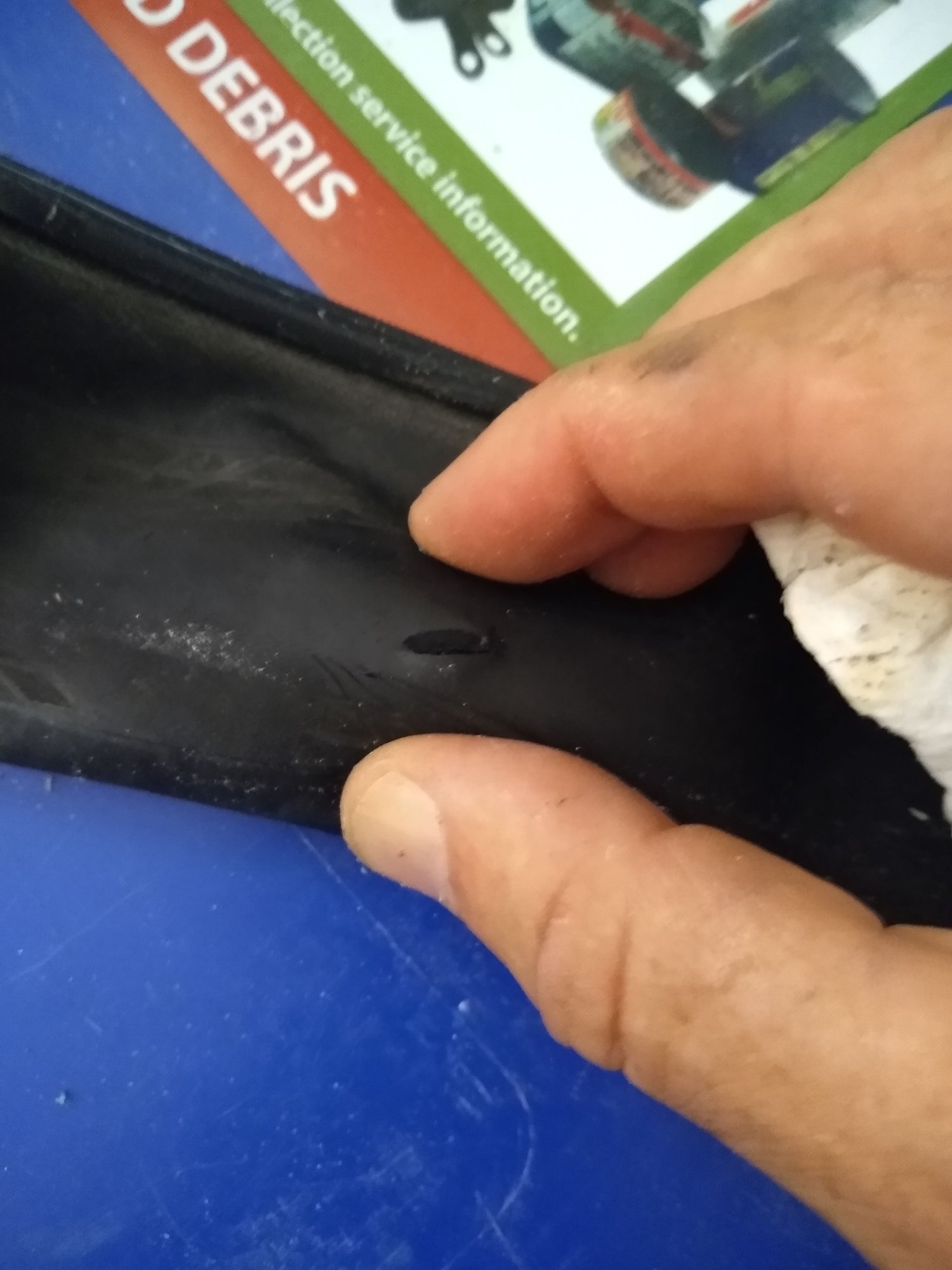

I was 30 miles from the end of a 600k, when i ran over something that put a 1/2" cut in my GP5000, right down the center. Sealant spraying like mad. I rolled the bike until the cut was on the bottom, and sealant just poured out. Plugged it, CO2 , and was rolling just like that.
That was a few weeks ago. Today i finally replaced the tire. I've never needed anything but a floor pump to seat tubeless.
There was one heck of a thing growing inside the tire. Looks like swamp thing.
