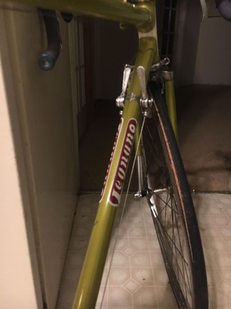

I thought I might post the restoration of my 1972 Legnano Olimpiade Record Specialissima and show the steps it took from purchase to having it receive Best Italian at the 2022 Eroica California Concours.
I've wanted a Legnano in its signature Transparent Green (Lizard Green to aficionados) but catalogs of the time show the smallest frame size made was 55cm. And, since I ride a 52cm frame, I held little hope that I would find one. I found this Legnano at the end of 2020 in Seattle through a post on one of the vintage bike FB pages that I'm on. The photos were grainy, but I could tell from the head tube length that it was closer to my size than any I'd seen. I posted the photos here on the Appraisals forum to get a sense of its value. I thought it was worth a closer look.
I contacted the seller for more photos and info and found it was indeed a 52cm frame. The photos I received showed a bike in pretty good condition, though with a mix of parts as far as I could tell. The most interesting feature is that the frame did not display the typical red lining or decal set seen on almost all other Legnanos that I'd seen. In fact, this one has gold lining and fewer decals. Could this have been an incorrect repaint? More research was needed. I found the Condorino website, which is a treasure trove of all things Legnano. In their list of frame numbers I found frame 1502R, just 39 numbers after mine, displaying the same gold lining and decal set. I'm not sure what the significance is of this difference, but it verified that it is original paint. I decided to buy the bike.

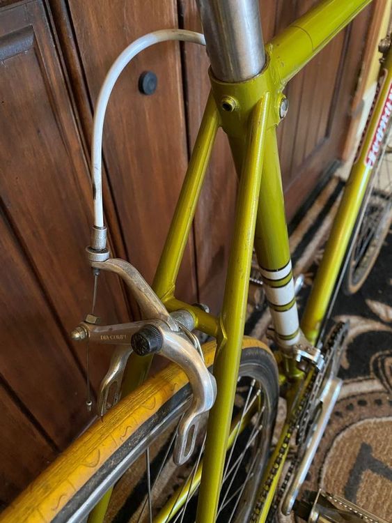

I had already noticed the elusive Universal rear brake cable hanger was missing so the search began as I waited. Surprisingly I found a NOS one on Ebay.it and received it before New Years. It's probably the luckiest thing to happen to me in years.

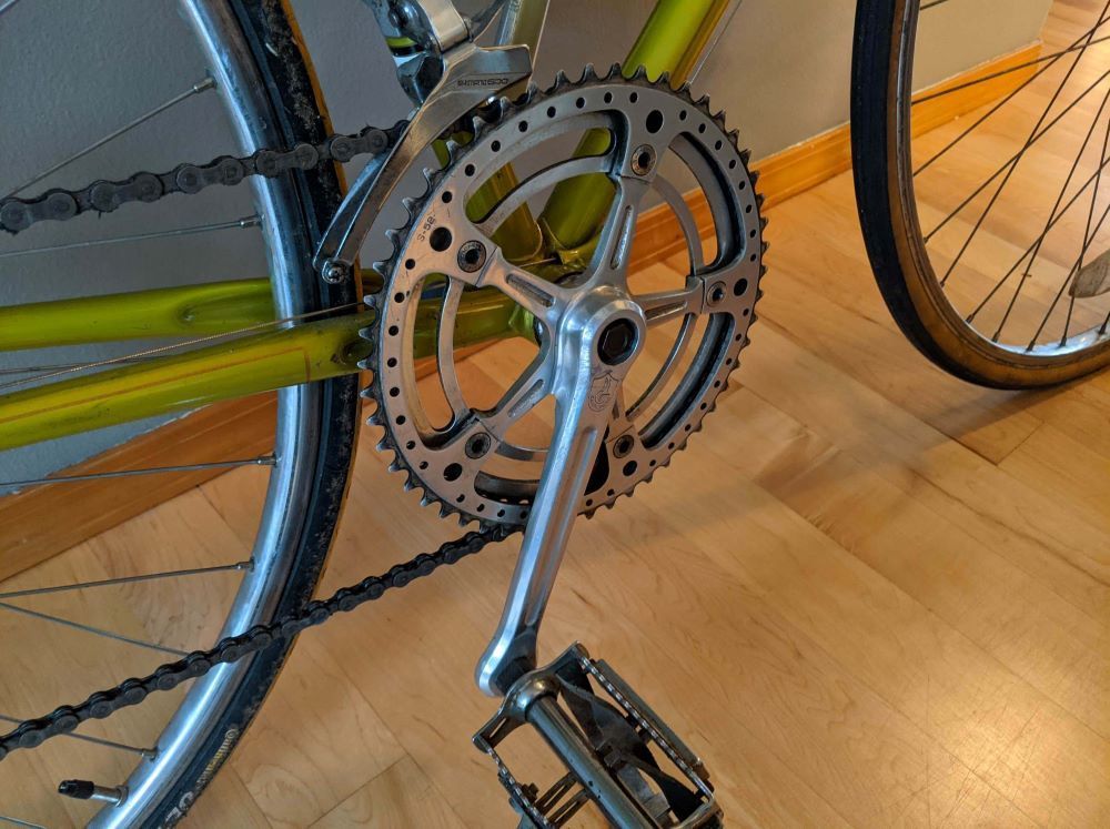

Besides the missing brake cable stop, it had an Avocet Touring W1 saddle, Mathauser pads on the front calipers, a Dia-Compe side-pull rear caliper, Suntour Superbe large chainring, Shimano 600 front derailleur, Shimano cartridge bottom bracket, budget Union pedals, a Mirrycle mirror attached to the left brake lever, a 27" front wheel with a Sunshine hub, and a correct Record large flange rear hub but laced to a Rigida AL 1320 clincher rim. The parts shopping could commence.

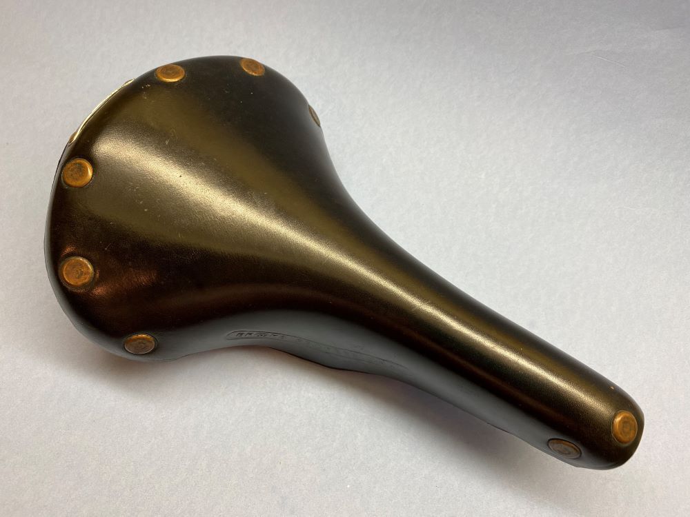

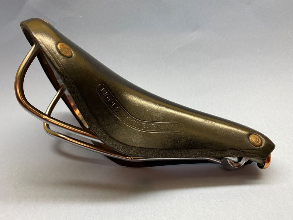

Another lucky find was this NOS Brooks Professional saddle from the 70s. The price tag was still on it. I suspect it was one of many removed from a new bike and swapped for a new, lightweight plastic saddle that was all the rage at the time.

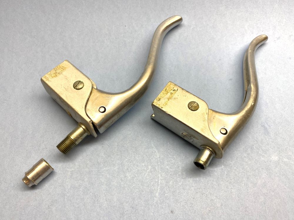

One unfortunate discovery during disassembly was the left brake lever had been ruined when a PO installed the Mirrycle. They cut off the threaded part for the adjuster.
So another set was found. It all works out in the end.

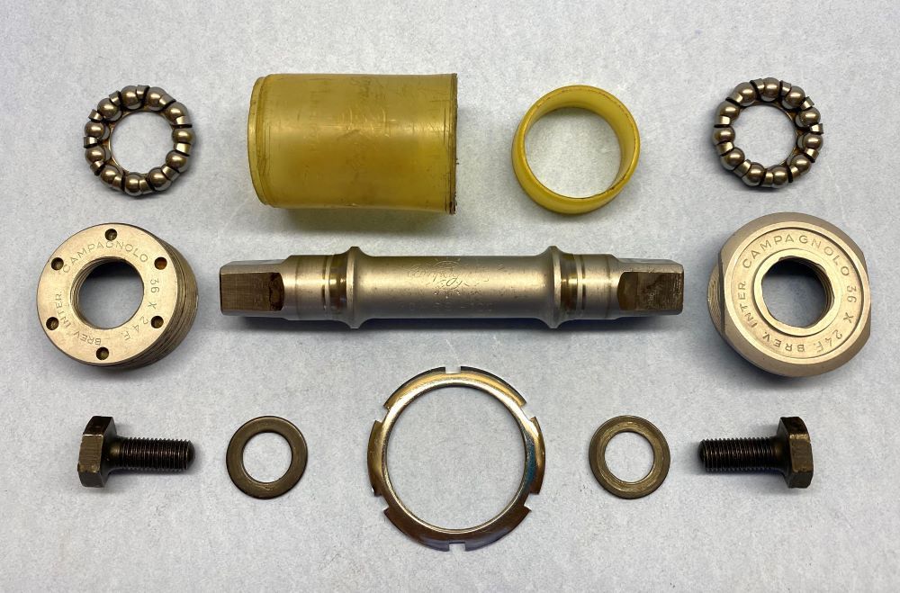

The first parts to be thoroughly cleaned, polished, and installed were, of course, the bottom bracket...

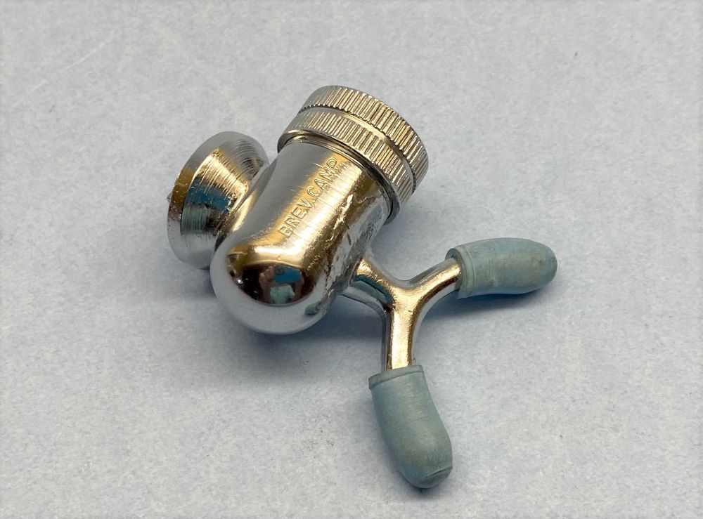

and the rear brake cable stop/release. The lever for the release was extremely close to the seat stay, and rather than risk chipping the paint, I added a spacer behind the bracket. The spacer is simply an axle spacer that I bent around a piece of pipe to get an approximate curve. Then I bolted it together with a Campagnolo toe clip bolt. I did so without the seatpost in place so I could gage how much the bolt needed to be shortened so it wouldn't interfere with the seatpost once fully assembled.
At the same time I was cleaning and polishing other components. Everything gets completely disassembled and cleaned before polishing, assembly, and a final wax to deter oxidation.

question regarding the dating of two replacement pieces -
was trying to recall what date the derailment guard peg came on on R/NR outer chainwheels
the stamping on the Christophe toe clips is the later one, was trying to recall what date it came in
would have guessed it to be too late but obviously am mistaken since the bicycle won the concours prize and the judges are sure to be vastly more knowledgeable than meself...
my Poutrait-Morin knowledge is weak
thanks so much for this wonderful account; am enjoying very much following along

All the brake bits were, as was everything else, completely disassembled, cleaned, polished, waxed, etc. I also repainted the text for a fresher look. When I first started restoring bikes, I would disassemble a part and lay it out in an exploded view so I could keep track of the parts. Then, after they were cleaned, I'd put them back in the same positions so I made sure I had completed all the parts. I've been a draftsman for over 40 years so I really liked the way it looked. I started laying the parts out precisely so I could take photos of these exploded views. I think they look kinda cool.
FYI - I found new straddle cables and replaced them before mounting the brakes on the bike.
The levers got the same treatment as well as new hoods.

chainwheel peg -
thank you very much for the response
have always found it amusing that Verot first began adding this feature in the mid-'60's but it took Tullio & Co. ~eight years to decide it was a good idea and begin doing it as well
61's -
recall an issue of Bicycling! magazine from the mid-1970's where Richard Jow wrote an article about a machine which came with 61's which he had polished to a chrome-like shine
imagine judges would have deducted marks for the colour, opacity and absence of the blue hotstamp on these hoods
1977 was the year the composition changed from the dark translucent material to a lighter opaque one and the blue hotstamp was eliminated
forget now if the vendor for the hoods was Gomma Ambrosiana or Gomma Vittoria
