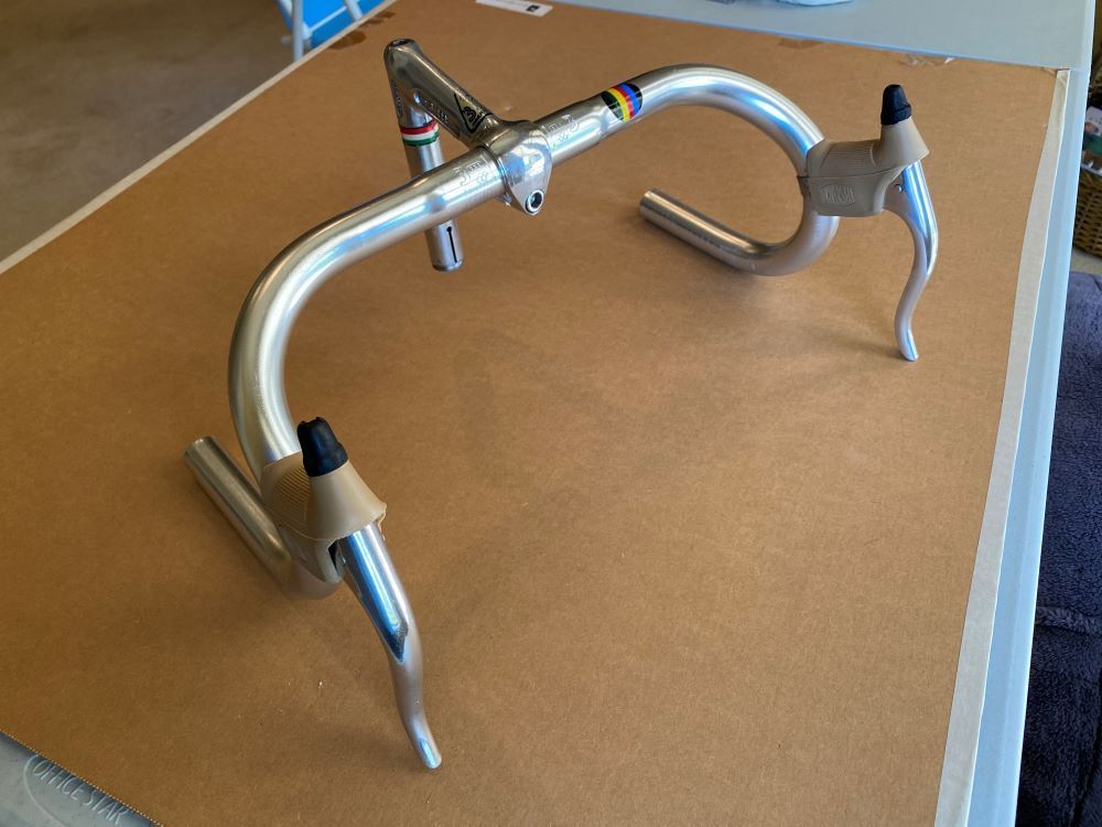

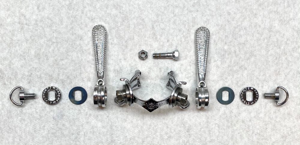

This is my last photo post before heading off for a short vacation through Tuesday.
The shifters cleaned up really well after my typical revamp. It definitely looks good on the bike.

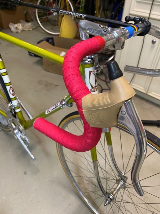

Fratelli Pietra -
the model Nr. 306 brake levers are correct for the date of the cycle
the pivot pins, part nr. 359, were changed ~1968 to these from the previous brass examples
iirc the cable anchor in the lever also changed at this epoch from steel to dural (not illustrated in parts drawing below)
one thing ran into with them is that in some cases the pins are wont to walk out of their billeting with use
when they do so the heads can damage costly hoods
if have occasion to replace hoods or have levers apart for other reason like to place a drop of loctite on the threads to encourage them to remain home
hoods -
there were two models sold under the Vittoria name, separate from the ones done for Pietra
these were termed the Giro d'Italia and the Tour de France
readers may recall member iab making wonderful reproductions of the Giro d'Italia pattern which he documented here on the forum several years back
one pattern can be seen above on brake lever Nr. 303 and part number Nr. 353/Z
other products included gum rubber handlebar plugs bearing a star symbol and slip over sleeve for brake levers

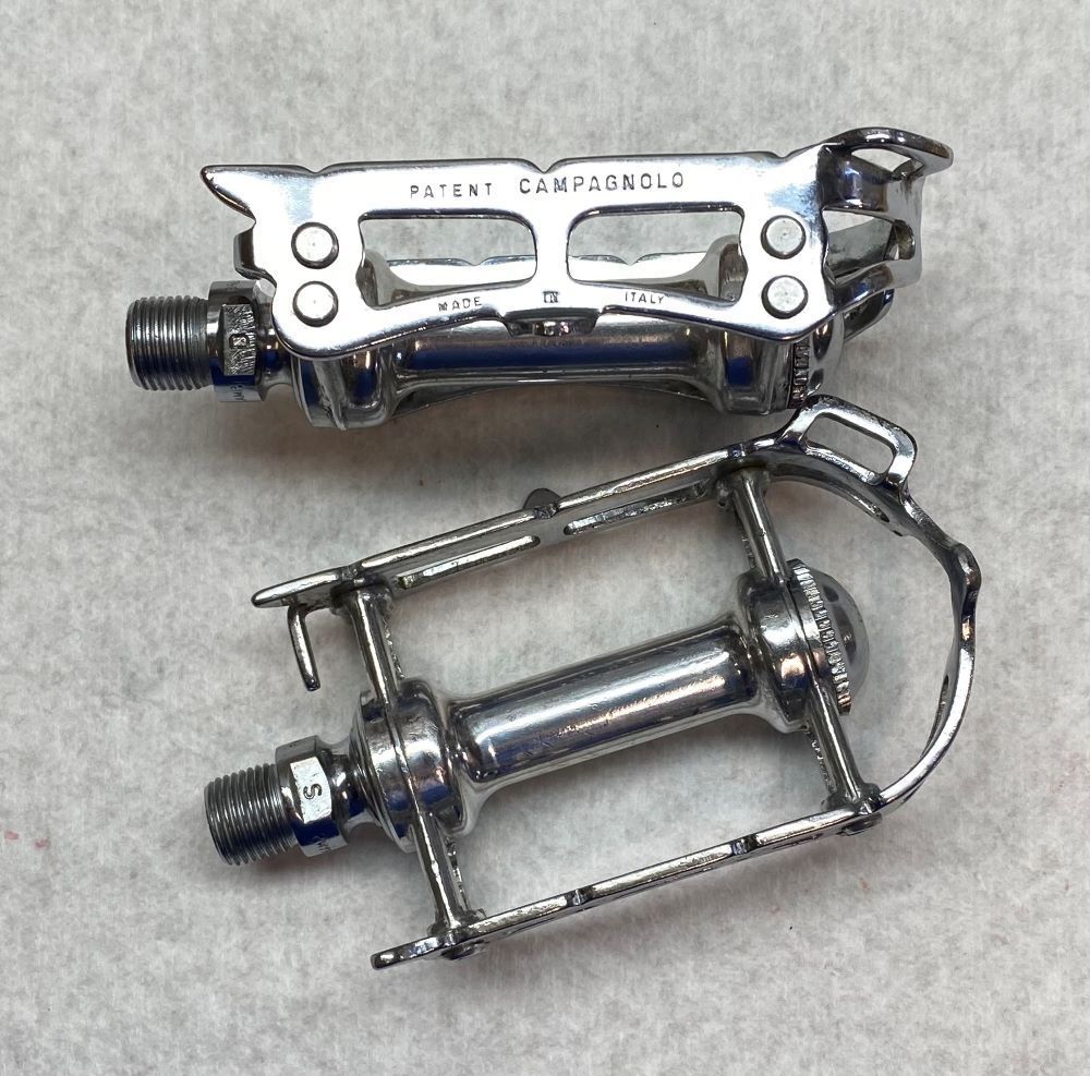

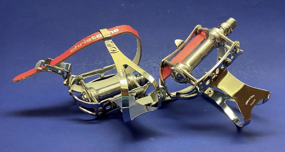

The pedals were treated the same as the other parts.

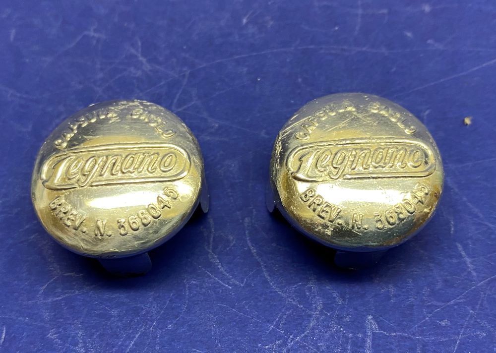

And I located a set of Legnano brand Gaslo end caps for about $40. This is after a good polishing.

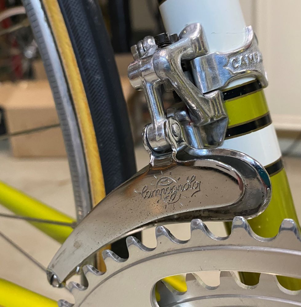

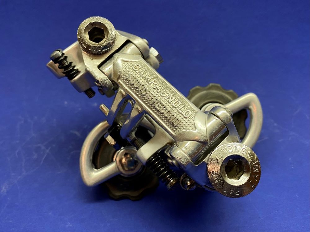

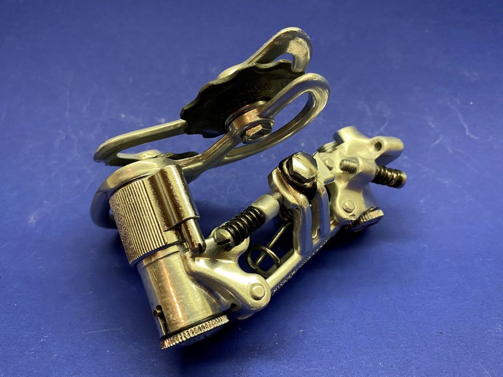

The rear derailleur was in decent enough condition, but was VERY dirty. A bit of TLC and it's good as new.

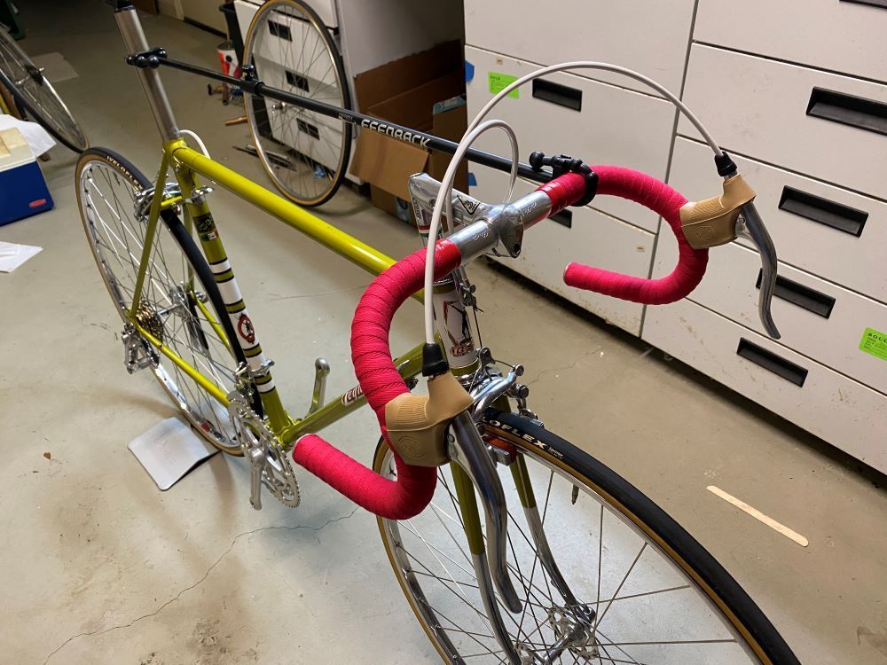

Building the bike can start in earnest. First was to fit the stem and brake levers to the bars, then the assembly to the bike.
Then comes the pump peg, the cranks, and the front and rear derailleurs. All parts that clamp to the tubing have the contact surfaces lined with clear shipping tape and trimmed to the edges to protect the paint.

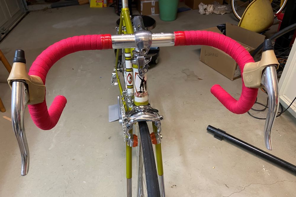

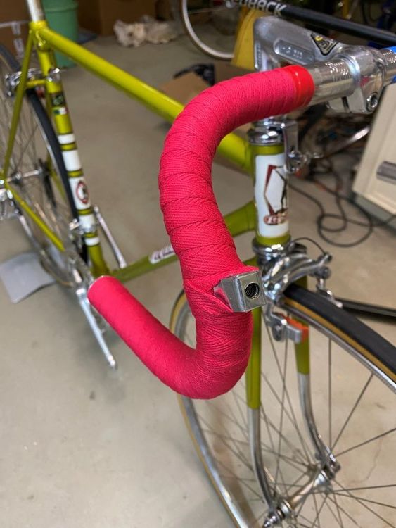

Time to wrap the bars. Of course, I chose red Newbaum's cloth tape. Whether I normally wrap top-down or bottom-up, using the Gaslo end caps necessitates wrapping bottom up as the cap's tangs fit around the outside of the bars and the tape holds them in place. To be sure they stayed in place, I taped two opposing tangs with Scotch tape, then let the bar tape stick to the other tangs. I also Scotch taped the brake lever straps to the bars to hold them in place, then removed the levers before wrapping the bars. Getting the lever's mounting bolt to thread into the strap after wrapping the bars was quite fiddly.
It's really starting to look like a Legnano now.

Sensible but you covered up the bar sticker on the LH side. We would start the tape beyond that.

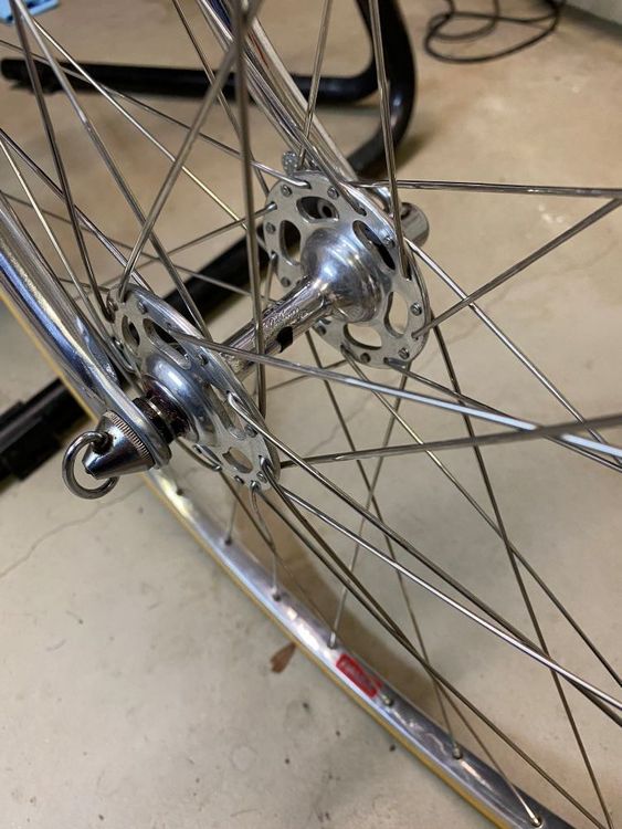

I cheated a bit on this next step. Instead of building a set of wheels for this bike, I took the newly built wheels from my 69 Colnago Super. I "thought" the rectangular Fiamme badge was correct for 1972, but it's not and it cost me a few points at the concours. I'll correct it in the near future. The original freewheel was in excellent condition so it got a thorough service and was reinstalled.
I then installed the brake cables and housings. While most Legnanos you'll see have red or lizard green cable housings, I chose to use white, since this is the color used on Legnano ads from the early 70s.
Add the seatpost, saddle, and shifter cables and it's almost done.
