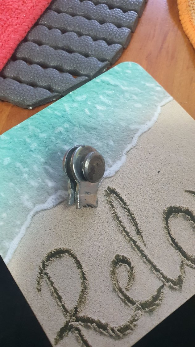

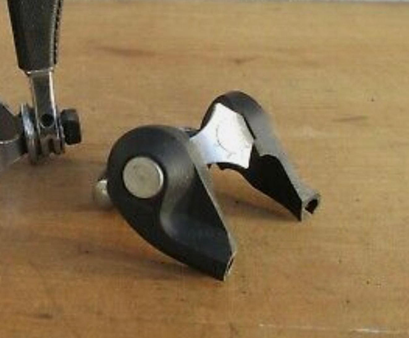

Hei guys,
Can anyone help me and tell what is this for? Seems some cables hanger , but?
For break cable hanger i have these , but what about others? 😅
Thanks!
Thanks!

& the ones marked Mafac are the centerpull straddle-cable hangers.
Wow , thank you! Verry important parts !

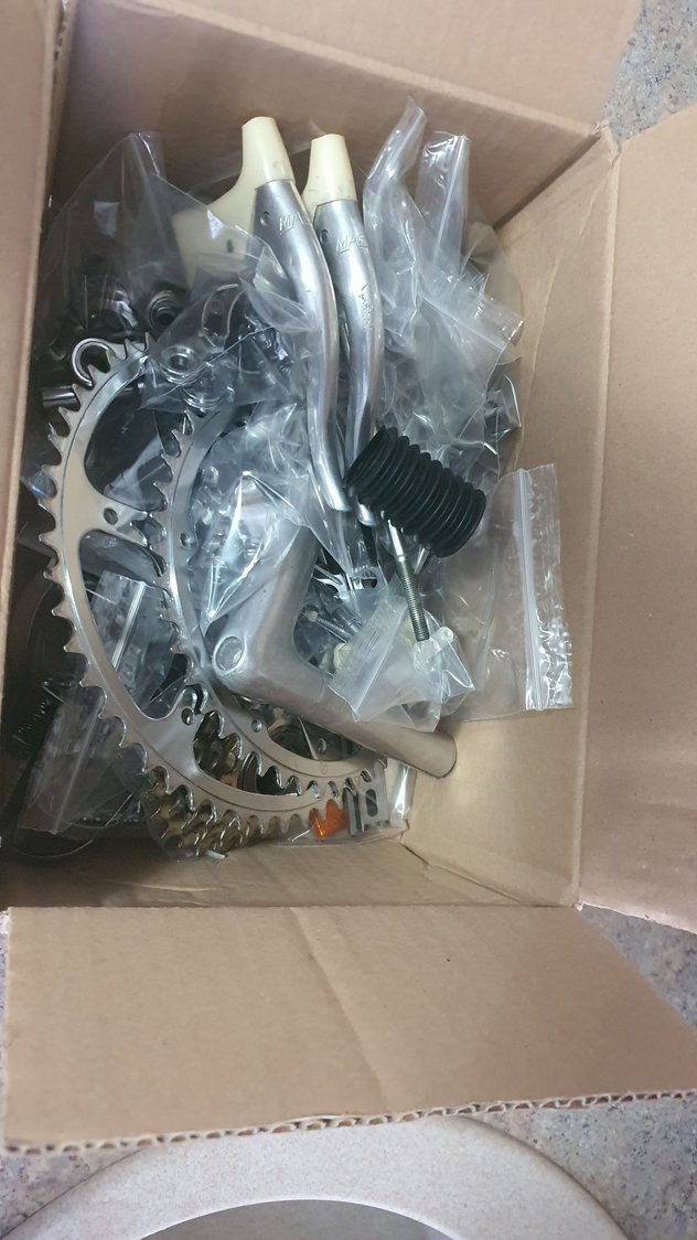

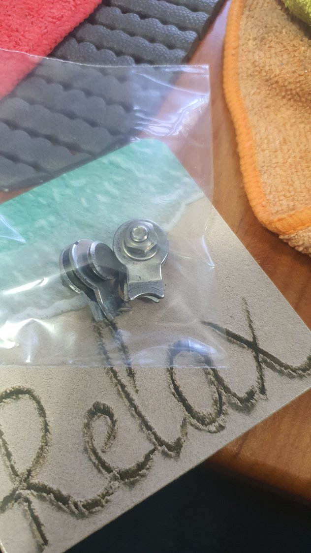

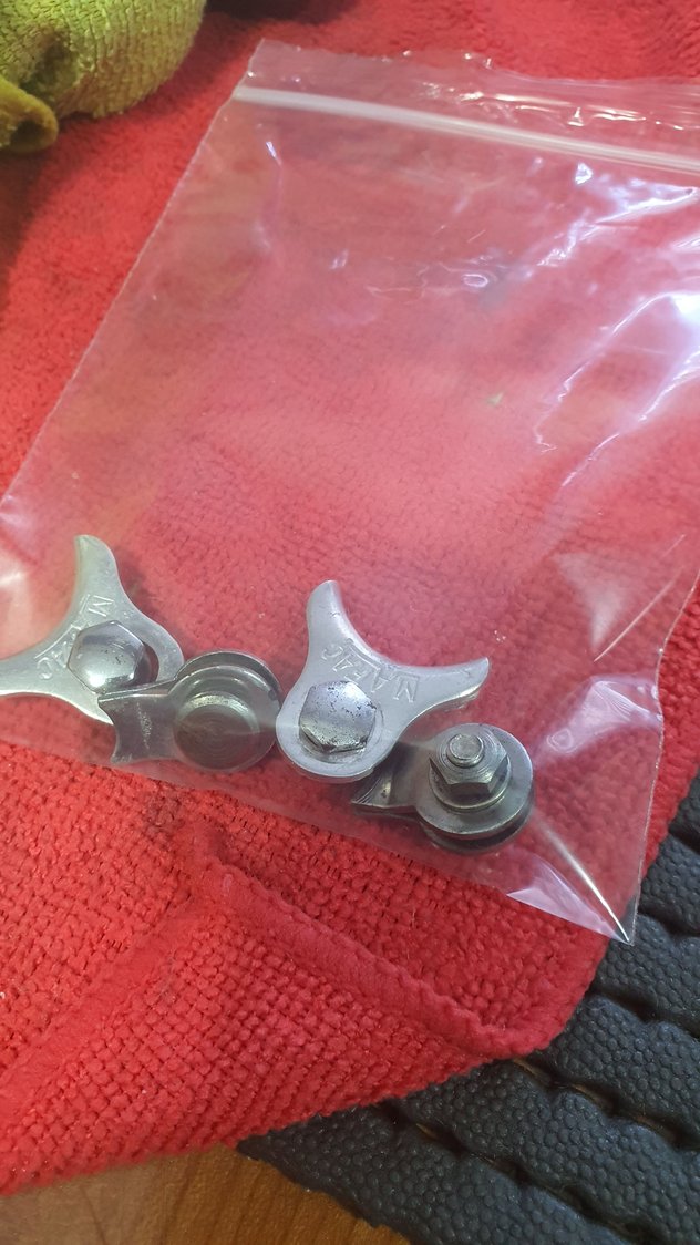

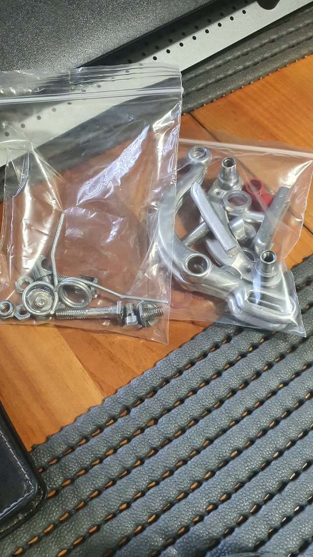

I have finnished clean all the parts and box them :
& weight in grams :
Washers from friction shifters doesn't look too good, metal parts waiting for a citric acid bath toghether with all bolts and nuts ....and all metalic parts that have some surface rust. I miss 2nd pcs from the right top corner 😓. I found it in France with all the parts from the photo , NOS ....like 40$ all of them 🤦
Break has come really well , except the fact i miss 2 break pad holders from the back . As for pads will go with KoolStop .
Next days i hope to finnish with frame and fork cleaning then order some clay bar and polish compound to see how they come. Cheers!

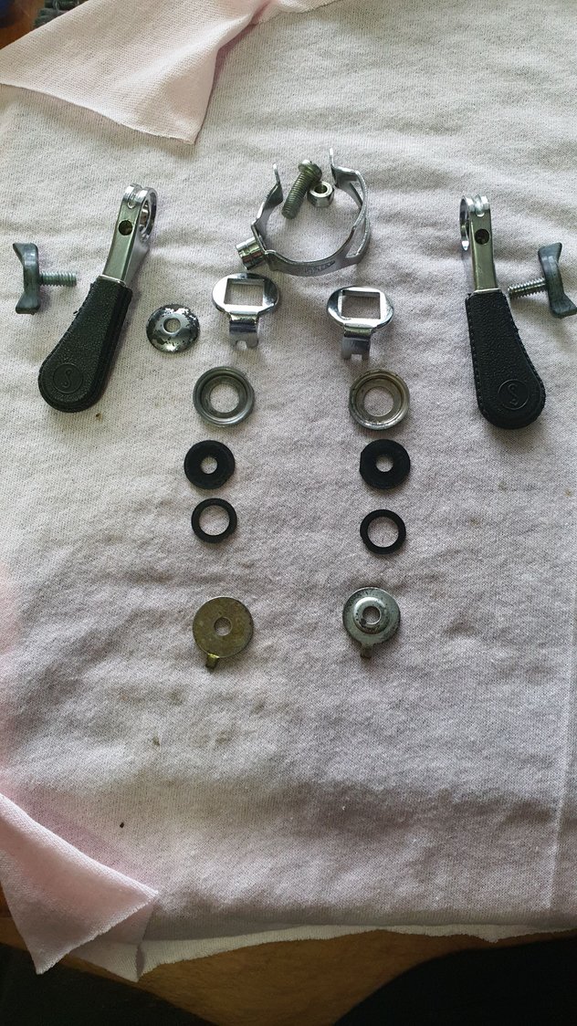

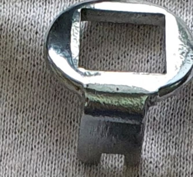

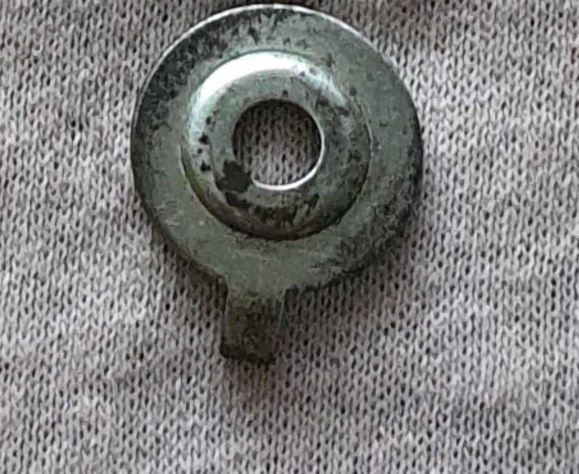

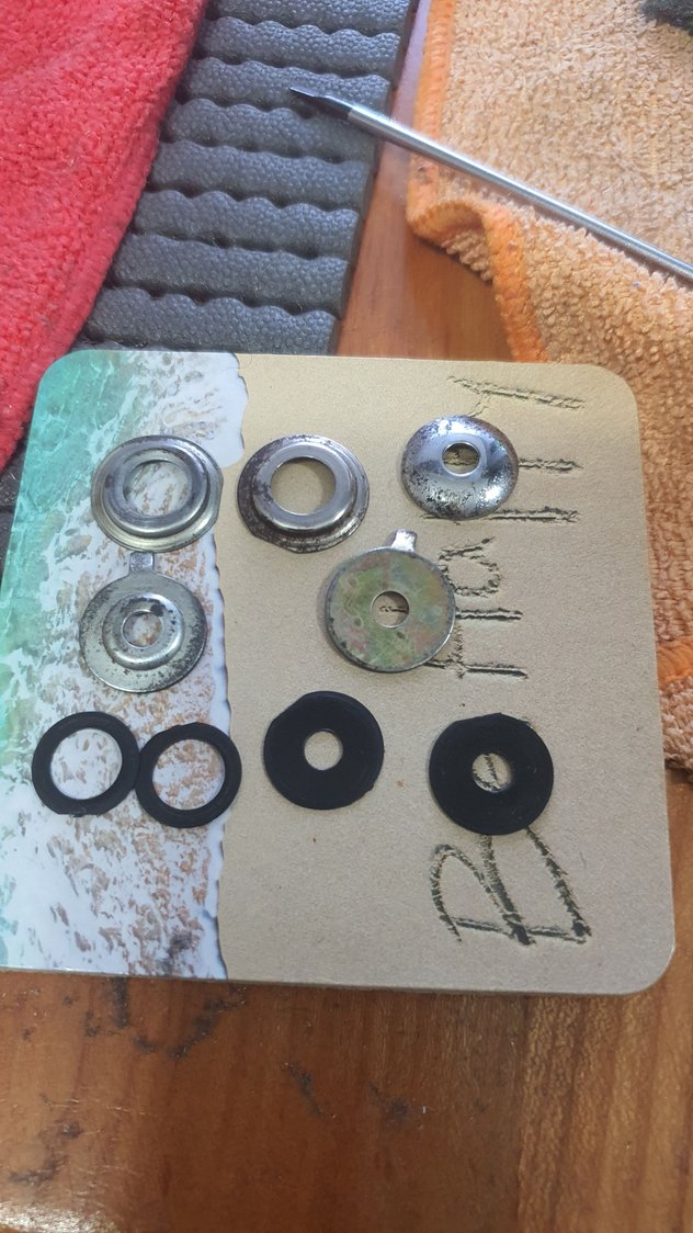

Hello guys, another question, if you can help : - about friction shifters :
This is all i have :
Seems last metal washers are not the same ...so maybe this is the reason i miss the 2nd pcs of rounded metal chromed washer who came right after the wingnut. I have studied some diagram of this shifters and seems i have all parts but 1 . Can anyone confirm please ? And i have seen some models with some cable hangers like this :
I don't have this one at all...it is mandatory? It depends on the frame? Thank you in advance!

It looks like the shifter clamp you have is for a 1x setup (ie, a 5-speed with no front derailleur...)- you'll need a clamp with studs for 2 levers, and the domed washer. Your best bet is probably to just find another set of Criterium shifters, rather than trying to find just the clamp and the missing domed washer. Here's one on ebay.fr, with the down-tube cable guide.... Though you may have luck finding one at a bike shop that's been around a while- the sort of shop that has drawers of random old stuff. These shifters came on 100,000's of bikes.
As far as the DT cable guide, unless your frame has brazed-on guides, you will need one. The Delrin one pictured I believe was standard with the Delrin derailleurs- there is also a chrome Simplex one, too, that may have usually come with the 'all-metal' Simplex mechs. Either will work.
Noo, the other one is on the frame 😅. If you look to some diagrams you will see there are different clamps. About the cable giude i think i don't need it cause i don't see any marks on the frame, but who knows...i asked just to be sure. Cheers!

Look here to see the correct layout of the shift levers. It looks like you are missing the second "domed" piece, and perhaps there is a mix of parts in there but everything should work if you get that last missing piece.....
https://www.disraeligears.co.uk/site...le_scan_2.html
(I know you have the nicer levers but I had a set and all the other pieces were identical to the crappy plastic wrapped with metal levers).....
Here's an even better diagram of your levers.....

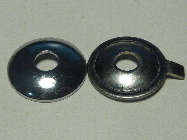

markk900 i have found all the pieces on Ebay.fr , but instead 2324 seller have 3781L :
: https://www.ebay.de/itm/284326348698...&segname=11051 .
He send me a picture :
Mine is this one:
I think 3781L can work for me only if can fit here :
Need to check this and then i can order them .
Mine is this one:

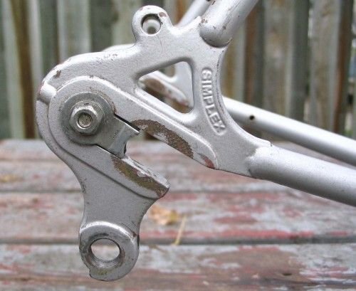

I am not an expert, but I believe the only part you need is 2284 (the domed cap on the left of your first picture); I *think* the flat vs indented keyed washer (2324) keyed washer won't matter. You can check by assembling one side of your shifter with all the parts for one side (start with the flat keyed washer) plus 2284, and see if the shifter moves smoothly. Then assemble the other side with the indented keyed washer you already have plus 2284 and see if that side works well. If both work you only need 2284.
Edit: I found a diagram that shows that simplex may have simplified the arrangement later: combining 2284 and 2324 into the single part 3781....and the one you already have may be an earlier version of that. You could try assembling the shifters with the parts you have - the indented part of the piece you already have goes to the outside it seems.
