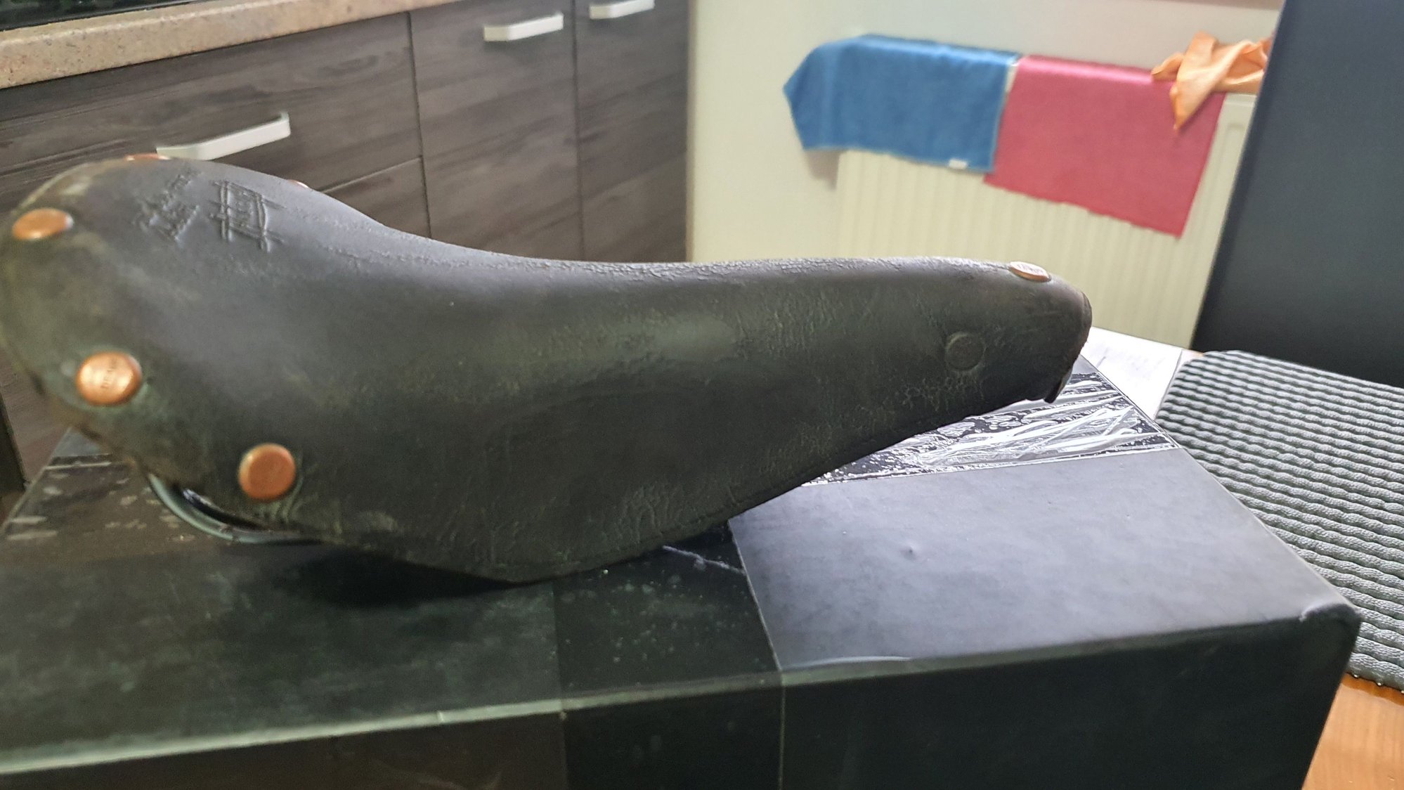

Another small update : today i have snatch an Ideale90TB , Daniel Rebour , saddle for my project :
Seems verry dry , but it was good prize and Ideale , France reply to my email and said it is still in good condition and will give some nice rides , worth restoring . Also want to thank you to pastorbobnlnh who recomand me to please rhm , maybe he can help with he's valuable oppinions about how to not ruin this in the process of restoring.
Those are the seller pictures , in about 2 days i will have the chance to look closely.
Little by little ...

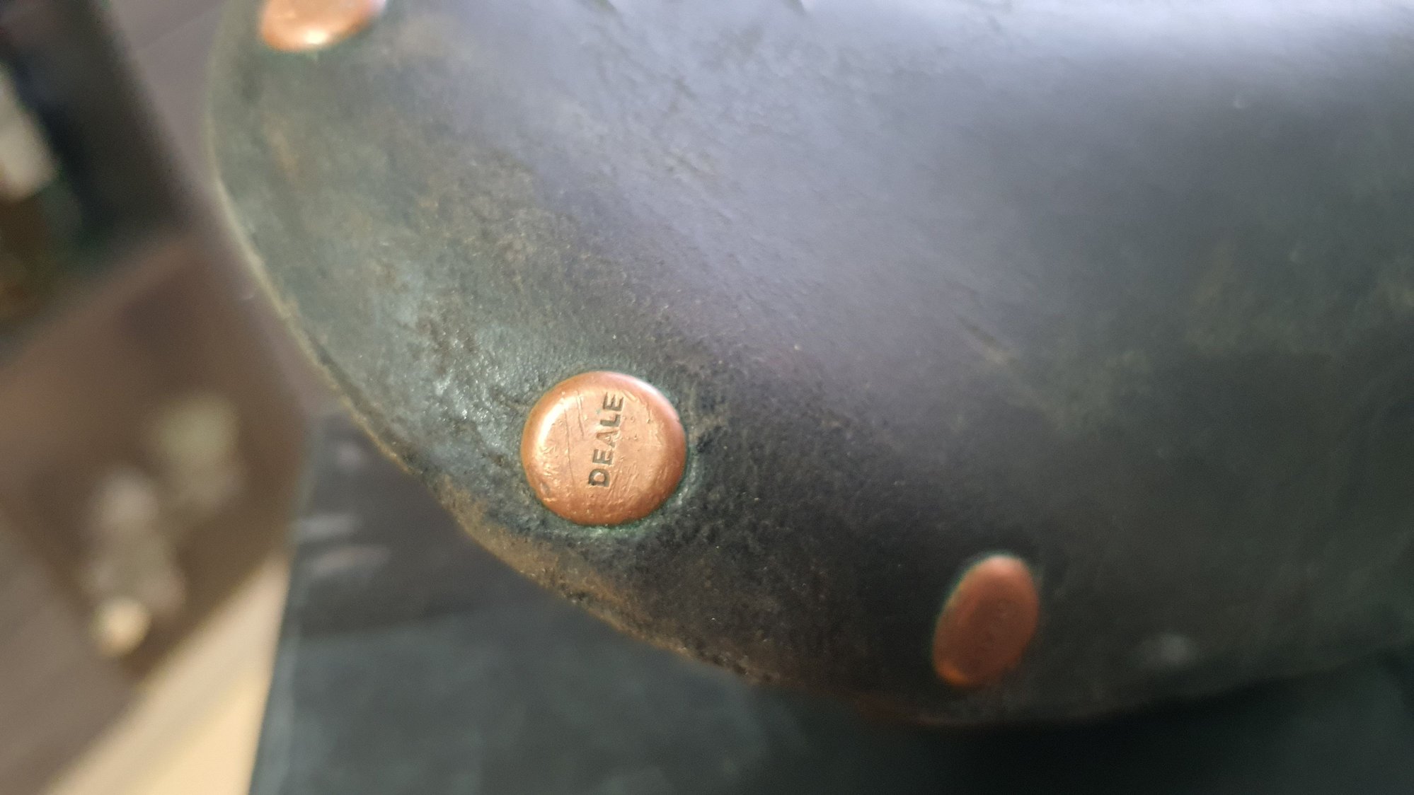

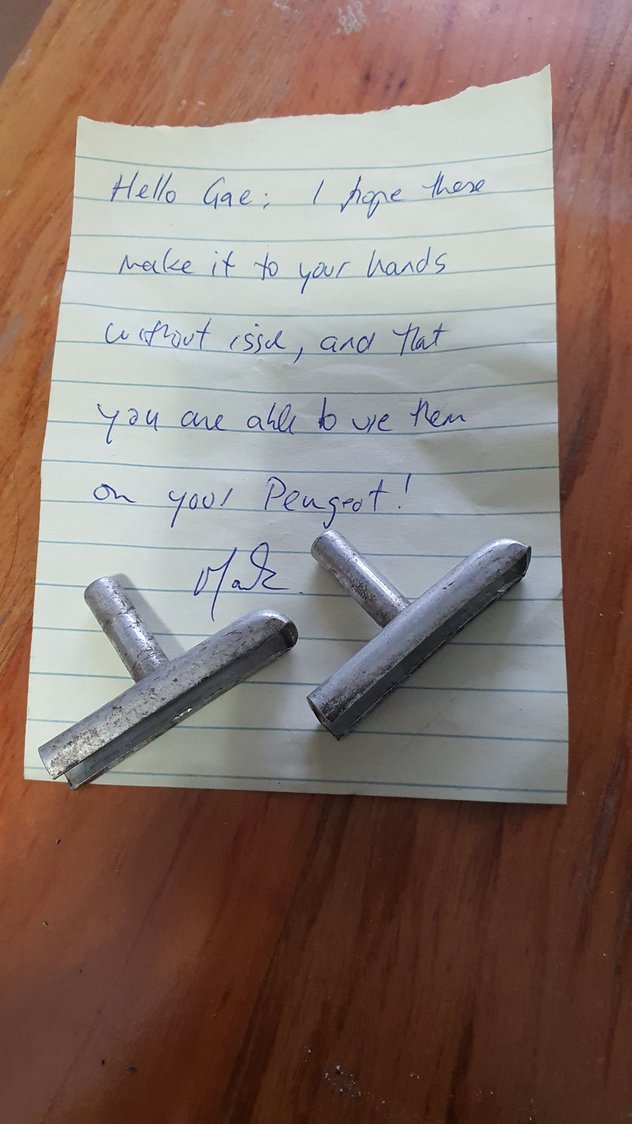

Update : Today , the missing Mafac break pads holder have reach me. I can say i don't have enough words to thanks markk900 for these little 2 pcs :

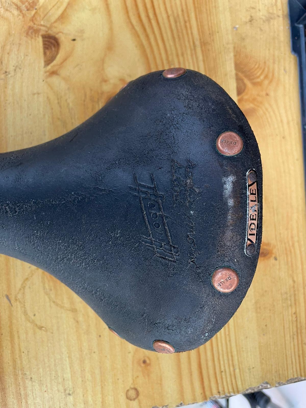

Also this Ideale reach me today :
No quality control in ' 70 - "I" is missing from all rivets 😅, maybe this thing make it more rare item .
Overall is not in bad contition , leather is hard but for sure with proper restoring process can be saved . No deep cracks , barrely my nail stop on them , and also the tension bolt seems untouch.
Maybe some imput about the process of restoring this beauty will be verry helpfull.

Sorin So glad they arrived safely.....cheapest parcel post has no tracking so I worried they would get lost. And ironically I had just logged into BF to send you a message to see if you got them yet.
They will polish up nicely!
Lovely saddle too.....count me jealous.

#55
Eh, Mark, about paint...i will do some high missing spots but not the scratches ...in the end i am pleased about it but few.
About the saddle i was lucky i guess , i was found it locally with just 45$ shipped . After some restoring work and with Ideale saddle clamp, i think it will be more valuable in therms of $$ than the entire bike . I have ordered 2 Continental Giro , and i am verry please with the bar tape i have found : https://www.rosebikes.de/velox-guido..._shape=schwarz
- is cotton , the same was used in '75 , maybe is not confortable to ride but i use gloves alot of time . Also ordered a KMC X8 chain and i think the only parts i miss now is cables and housing for break and shifters. I hope it can be ready to ride in about 3-4 weeks. Keep update !

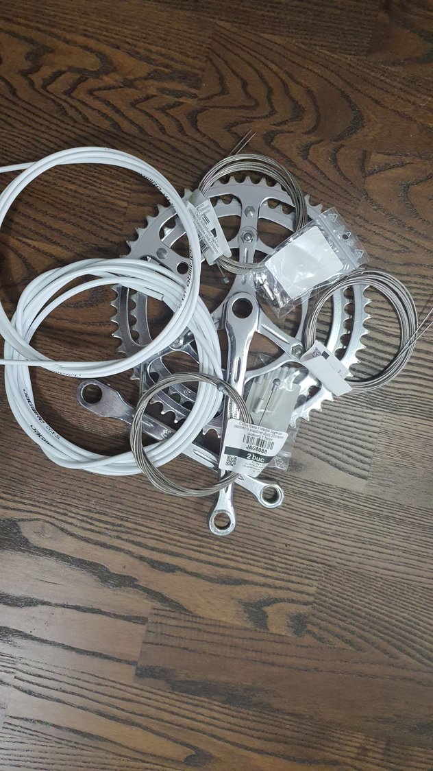

Small update for restoration process : after reading some about leather, how to revive an old piece...how to clean, how to ..and how to not ..i have decided that best for me is to make my own balm with some ingredients . In my history when i was bearded i had make my own balms so i have some experience with ratios and all process.
I have order beeswax , then some butters : cocoa and shea, then some oils : almonds , avocado and coconut , and at last lanolin and carnauba wax ( if needed) . One more ingredient i am looking for but need to make it myself is tallow . I want to make 2 batches of balms - one with tallow and lanolin for 1st part of the restoration process and let the saddle to absorb new natural oils and 2nd batch with vegetables oil which will add more protection for long run. Best ready to buy for me was something from Effax ( made in Germany) which is quite popular between horse riders who maintain their saddles but in the end i had decided to make my own cause it don't have that tallow which i really want to use is . In a few days will have all ingredients and after making those balms will start to clean and put some balm on the Ideale saddle.
I have order from France an Ideale saddle clamp , a seatpost binder ...2 cotter pins, waiting for delivery.
Last pieces i miss is just cables and housings for break and shifters which i will order this week , then the assembly can start.

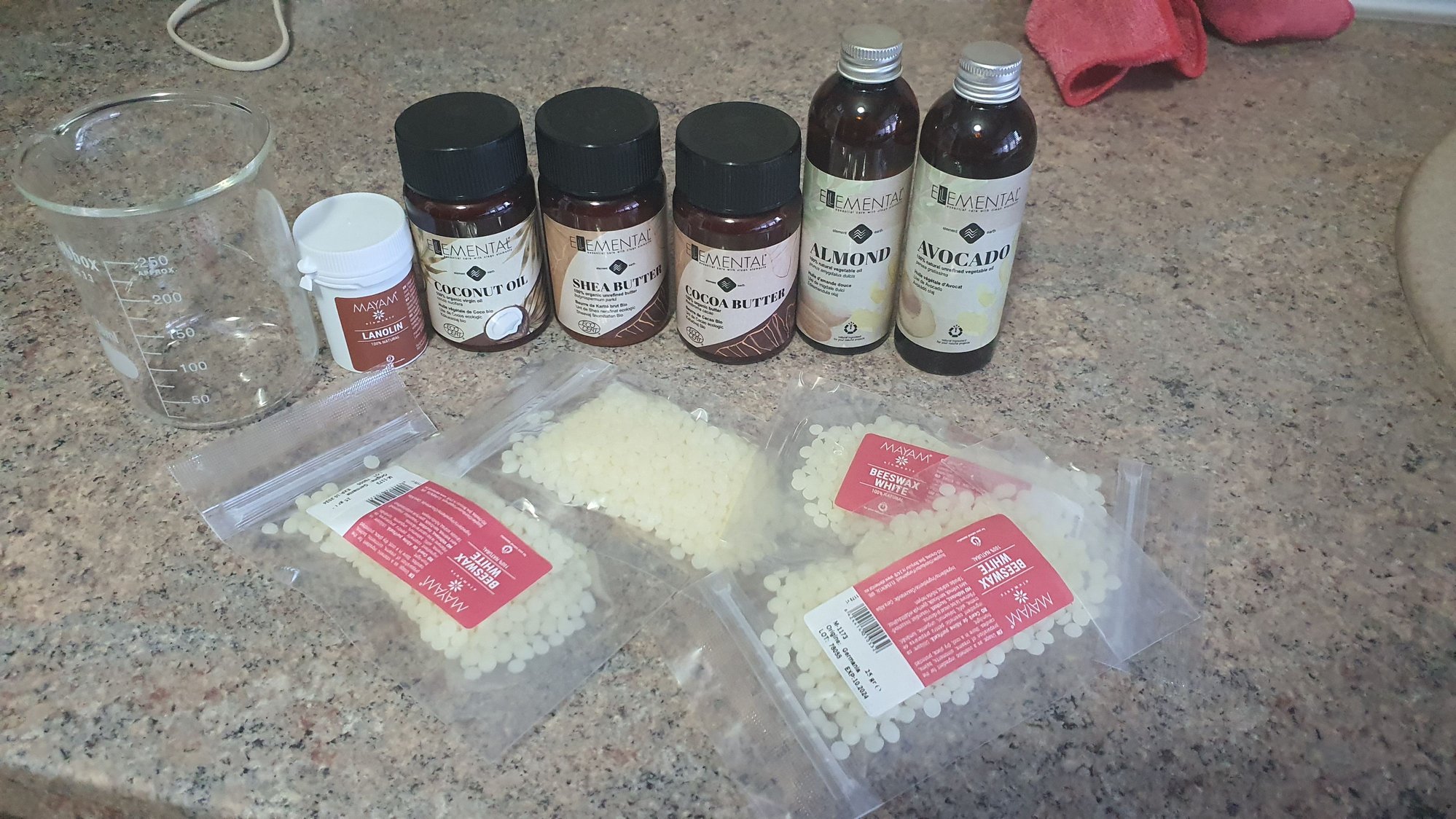

Small update about saddle restoration :
- goodies arrived today in the mail : lanolin, cocoa%shea butter, coconut, avocado & almond oil and beeswax.
I have mixed all the ingredients in to a double boiled pot as:
beeswax -butter-oil - lanolin : 1:1:2:0.5 and added at the end few drops of Vitamin E.
I had clean the saddle with hot water & mild glycerin soap and let it dry for about 24h . Previous i have remove tension screw and clean all the rust then put it back but not tension yet.
And today i have apply a small coat of resulting balm then buff with a rag. Result is awsome in my oppinion :
You can see in the picture how much i have apply on both parts for the first time. Leather still feel hard but i guess it should be like that as i don't have any experience with tensioned leather saddles. At the end i will tension back the nut and ride , hopping the leather will not crack. Let's go baby !
More updates later!
L.E : My hands feel awsome now as some balm remain on my skin😅😅.

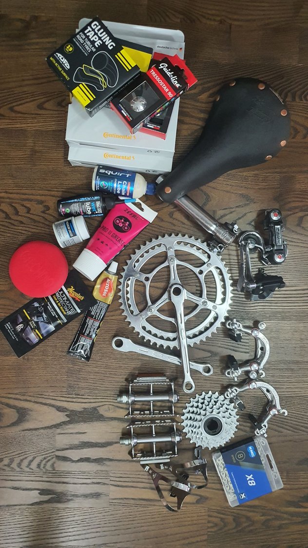

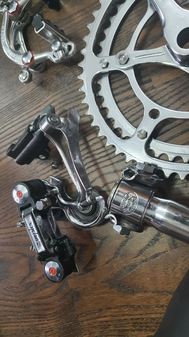

Verry last few update before final assembly :
- parts start came back toghether :
And some details - front & rear derraileur Simplex Prestige
-Ideale TB saddle with Ideale saddle clamp and steel seat post
- Mafac Racer break with new Koolstop pads
- Suntour New Winner 6 speed 14-26 freewheel and KMC X8 chain - silver
-Lyottard pedals and Hristophe rat traps
-Stronglight steel cottered crankset - 52-45
-Continental Giro 22m tubulars with Tufo Gluing tape
-Veloflex Tressostar 90 guidoline
& some products i have used for cleaning -assembly
I forgot about cables & housings :
- CGX - SL break housing
- LEX- SL shifter housing
- Jagwire stainless slick shifter cables - Campagnolo ends
- Jagwire stainless slick break cables - Shimano/SRAM ends
- Jagwire stainless 1.5mm shifter cables - will use those 2 as a straddle cable for Mafac breaks.

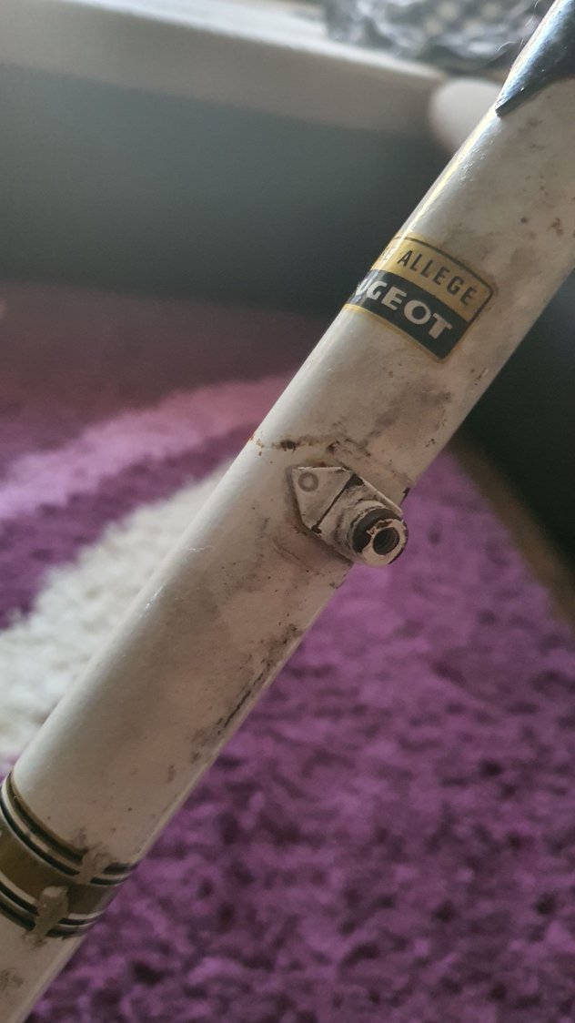

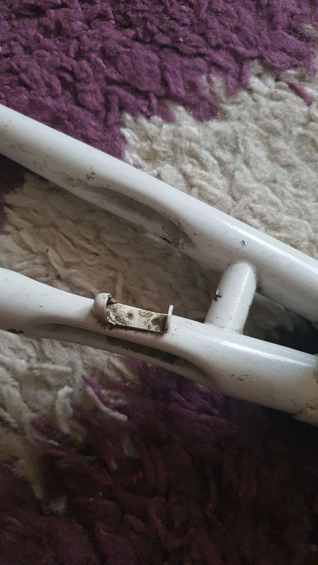

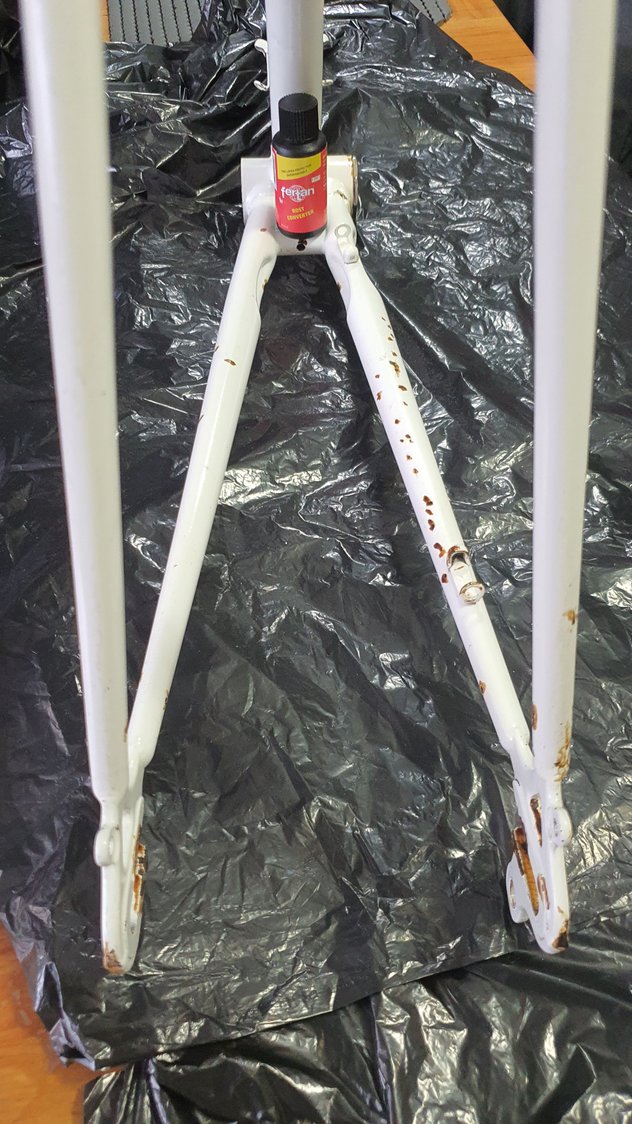

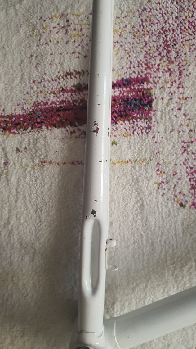

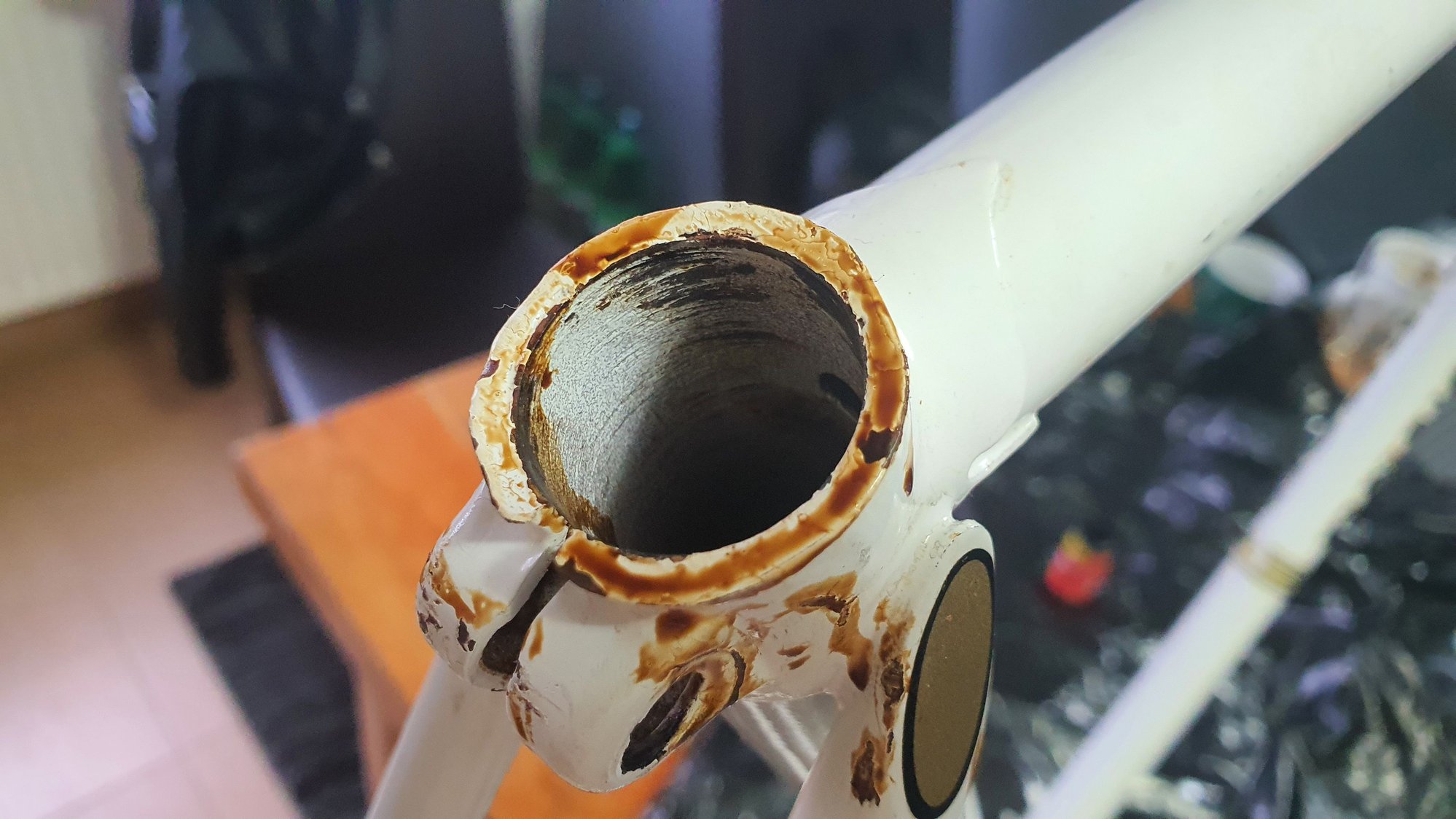

Last stage working on frame :
- i have buy Fertan rust converter to treat all the rusty parts
- and custom made Glasurit paint and hardener - for this i was taking my frame to the shop and try from dozens of collors catallogue and choose from the closest match.
This is the 2nd layer of Fertan - after 1st one let it sit for 24h and then clean with some 1/10 APC
Fertan is a tanic acid based product .
Tommorow , my wife will do the job and touch up with paint all the critical areas , i have told you i have no talent on this job 😅😅
All inside tubes are clean from what i see , including head tube and no visible rust is present.
I have 1 tube of pressurized wax and i am still thinking if i will apply it inside all tubes for more rust protection, what do you think?
Last treatment for the frame is decontamination with claybar and 3in1 polish from Mezerna .
As for the AVA stern and drop bar also need some little more attention when polish them .

Home made balm was doing a great job restoring saddle
Autosol leave such a nice finnish on chrome and aluminium parts.
Doing this for the 1st time i can say that it cost at least 5 times more than i estimated and involved alot of work.
Parts was verry hard to find and shipping is verry expensive compared to the value of items i have need . Couldn't find all in one place and have to make like 7-8 orders to bring back them toghether.

New bearings arrived, finally i can continue my work ...huh. I will post number needed and size later trough progress .
Cheers!
Cheers!

Thanks for your imput ! 1st , locally for me is Romania and can't find many options here and 2nd , bulk is not an option for me as i don't have a bike shop

I have a French saddle of similar vintage and condition (I mean before your treatment), would you be willing to share the details of what you did? Thanks.
-Will
-Will
Likes For Random Tandem:
#74
Old Bike Craphound
Agreed. When I first read the post some posts were missing. Obviously, I suspect operator error. Thanks for all the info!
