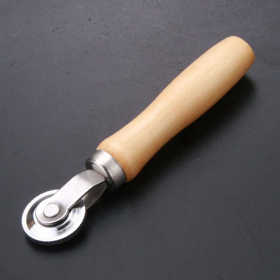

the wheel is now with a inner tube that had a puncture repaired and unfortunately i only figured out that the patch is best applied after you take the plastic cover off from it by bending it several times and using something to cut the plastic thin tape in the center and carefully getting it off and then apply the patch in such a manner as to stretch it properly to take the best shape and have smooth transitions. any curvature on a patched tube is to be smoothed out and that is not possible with the plastic tape still on; also the drying up of the solvent is faster this way.
i thought to point this puncture repairing tip as not many people figure this out on their own easily and it's a very useful thing to do. i read about this just now, right before mounting the tire, after so many years..
https://www.bikeforums.net/8994869-post32.html
...I'm not sure what that linked post says, but you leave the plastic film on the patch. Even when you put the patched tube back in the tyre, the plastic stays in place. The simplest tool for burnishing the patch is something like this one, but most people don't have them. With patience, you can do a similar job with the patch and tube on a flat, firm surface using a coin with a serrate edge, going back and forth in a couple of directions. It's usually called a "stitching" tool, and you see them used now by people repairing punctures in tubeless car tyres using an internal patch.
I know you're on a budget, but if you really, really hate to remove the wheel and repair a flat, given the minimal cost for new tubes online at places like Ribble and Wiggle, it makes very little sense for you to put a patched tube back in there. Even with the best technique, a certain percentage of patches fail. I have excellent technique, and I still have a faiure rate of maybe 20% over time.
