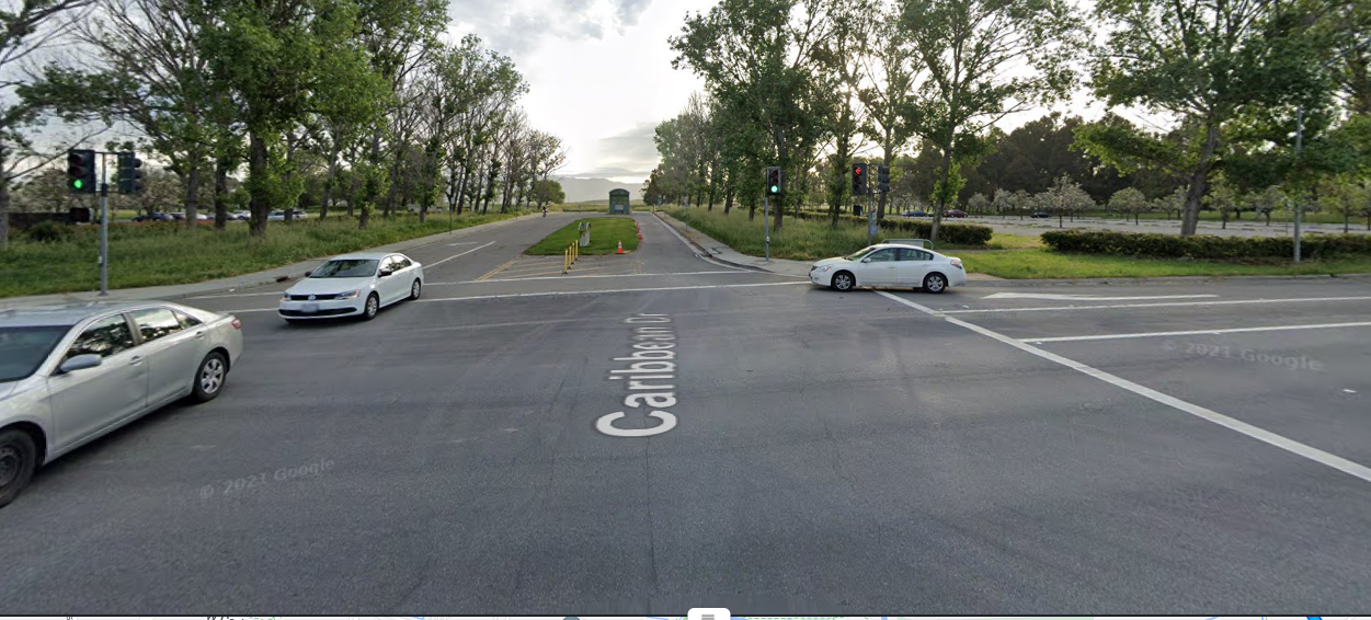

There is a traffic light on a very broad cross section in my commute route. Cars are fast coming off the freeway and going into the freeway.
On the other side is a trail/park where I want to get to. But in the early morning, there are no cars going to the other side. Last time I waited for like 5 minutes and ran the red light when no cars are around.
Can I activate the green light somehow on a bike?

If your bike's frame is metal, I've usually been able to trigger the sensor by leaning my bike way over to one side.
Failing that, go to the side and push one of the pedestrian buttons. This will usually trigger a full cycle of all the lights.

Looks like you could turn right at the stoplight, then left into that parking lot. Make your way from there back onto the street you wanted to continue on. If you had to, of course.

Although your picture seems a bit weird (the loop is on the wrong side of the road), you should probably try to ride your bike directly over the middle of the X (red arrow). If you can see the cuts in the road for a detection loop…sometimes a big “if”…ride over the center leg if it is a figure 8 type or over one of the long legs if it is a single loop. It doesn’t matter if your wheels are aluminum. The induction loop works when it is disturbed by a conductor moving through the field. Carbon wheels can even work but, with any bicycle wheel, you have to be directly over the wires and preferable over the most sensitive part of the loop.
A lot of detection today is made by motion detection. Look for a camera…usually white and round…on top of the traffic signal arm. This is a low resolution camera and is often set to ignore small targets like head on bicycles. For those waving your arms around or turning the bicycle sideways can work. If it doesn’t follow the malfunctioning signal law and proceed with caution.

Looking specifically at the intersection posted by the OP...There are pedestrian buttons. Roll up the ramp, hit the button, roll down the ramp, and cross when the light turns green. If that doesn't work, run the red when it's clear to do so.

Oh, I didn't even see those cuts until you pointed them out. I was thinking the bicycle sign is where I should place my wheel, just like the youtube video was saying. I'll try them out next time. Thanks!
