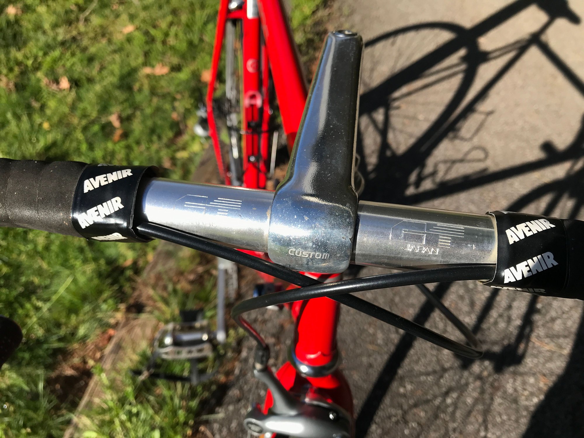

The BB on this Schwinn is really high like a Ridley CX bike. I’ve been thinking of racing again. Anyone interested in a Clunker CX Challenge?
I did a few SSCX races on this about 12 years ago.
I can't say I'd recommend it, but it was fun.
BTW, if you need the kind of brake cable hanger that clamps onto a 1-1/8" steerer, I can send you one. I've got a couple on the shelf that I expect never to use again. I guess you'd need a shim (?), but after that adapter, it would be an easy problem to solve.

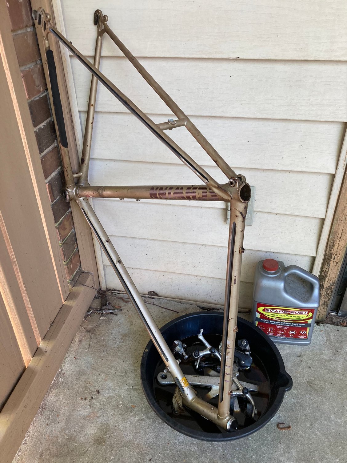

Commencing de-rusting procedures
All of the rusty steel bits are now submerged in the last 3/4 gallon of Evapo-Rust I started using in 2017 when my entry was the '72 Liberia. Consider this a test of how many times ER can be re-used! All of the inner headset surfaces are excellent, but the exteriors are ghastly - I'll have a better sense of their serviceability when I check later tonight.
I DO hope that the front derailleur cage is something other than solid rust red when I am done, and perhaps the steel small chainring.

Originally Posted by rustystrings61
All of the rusty steel bits are now submerged in the last 3/4 gallon of Evapo-Rust I started using in 2017 when my entry was the ‘72 Liberia. Consider this a test of how many times ER can be re-used!
Answer...a lot. Longer answer: until the rust only turns red-black.

The Mummy!
Hey, if it worked for Tutenakhen ...
Tonight when I returned from the Easter celebrations I pulled the parts from their ER bath. They're good enough but will win no prizes. Then I tore long strips from a ruined bedsheet and soaked them in ER and wrapped the front triangle and the fork. We'll see how they do overnight …
Holy Boris Karloff, Batman!
Mine (from 2016) is nearly black liquid now when I pour it. It still seems to work, but I think I might get a fresh jug this year.
I separate mine into different holding containers. Once it becomes nearly black, I put it into a "stage 1: holy rust Batman" container for the really rusty pieces including chains. Then I replace that with gently used ER from another container, and replace that container with new. It cycles through over time.
