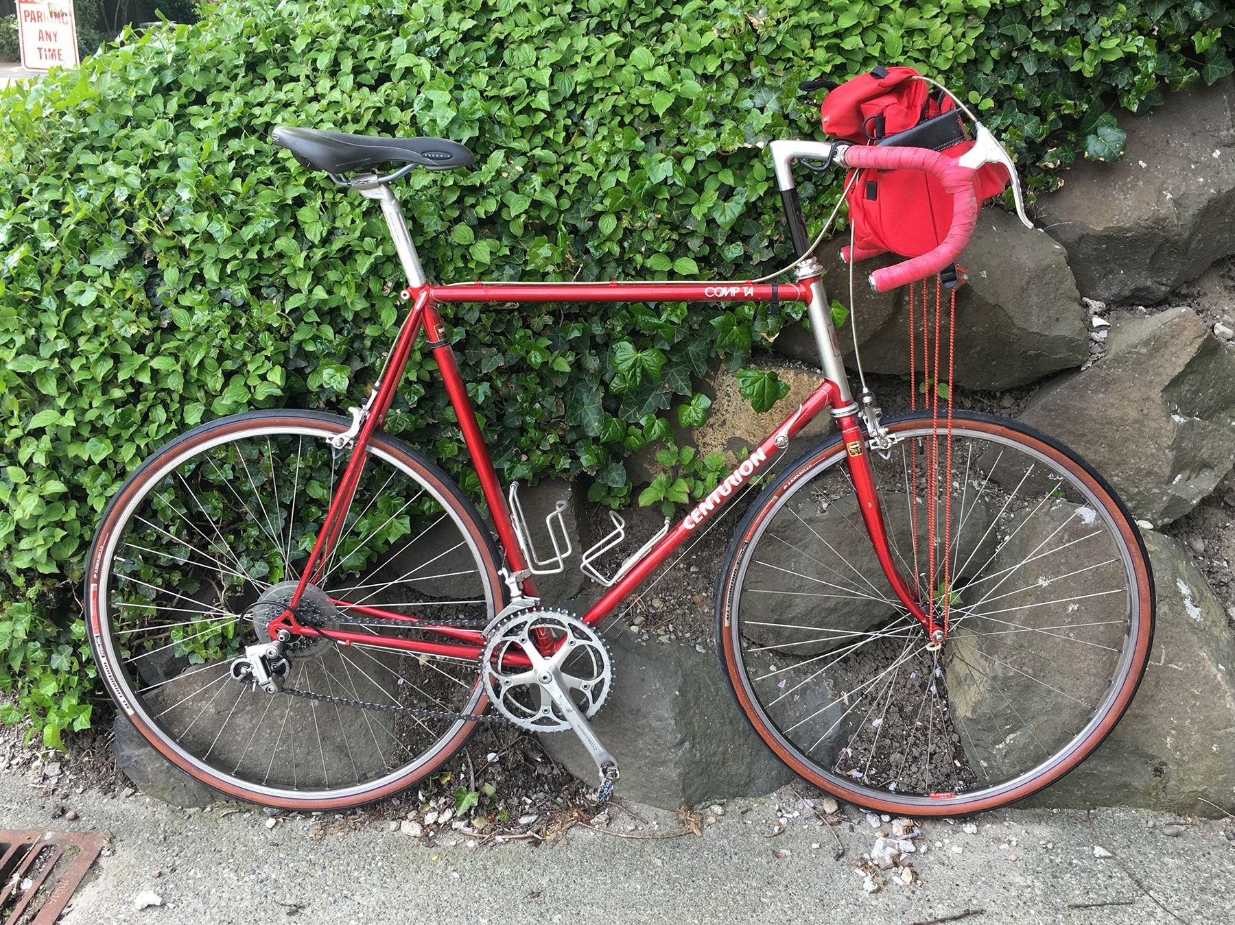

Let's see if I can make this work this year. Last year's super classy Fuji S12-S LTD needed chain, cables and housings at the very least to make it actually functional, but I was already at $100 for the buy.
This year we have the same size (25") frame, but a one-year-only Centurion Comp TA in the secondary red-with-silver-headtube color. Beautiful red! Buy price: $60 off of Craigslist.
As bought weight (with everything pictured): 12.5 kg / 27.5 lbs. Without all that extra stuff, but still in "running shape" (bottle cages, pedals): 11.5 kg / 25.3 lbs. Centurion claims, without specifying size and pedals/cages on/off, that these Comp TAs supposedly weigh 22.7 lbs. 10/10 bamboozled.
All cables run pretty smoothly. One brake lever hood is gone, and the other is cracked in half (doomed). Front brake calipers seem to have their pad slots drilled down a bit more...no need to, though. Weird. Twin bottle cage braze-ons, DT shift braze-ons, under-BB-shell shift cable routing, and recessed brake caliper mounts. Champion #2 tubing. Stock other than the saddle and probably the tires. Tires are old Specialized Armadillo 700x28s that actually measure 27.5mm. Good job, Previous Specialized. Chain stretch is right at 0.75, so it's pretty well done. 175mm crank arms!
Q-factor is 150mm, which makes it a little wide for me, and by me I mean my left knee. I have a budget to work with, and part of that will be going to putting on SPD-SL pedals (bought in a groupset buy late last year for a great deal, so they'll be cheap here). Maybe I'll find a slight shorter BB spindle--there's room for the small chain ring to move in on the drive side. I have new Can Creek brake hoods to use if I so choose ($5), but I have the world's worst EVA tap, Cinelli, to try and reuse, which means I'll need new/new-to-me tape if I go down that route. New chain if this roasted one skips. Tires look serviceable, but I'll have to look more closely. I do have cheap used ones I know are much newer and also a bit nicer. Well, two sets. I definitely want to clean and shine this up and overhaul hubs and things. Total dust bucket!
It's been hanging like this for years. Headset spins perfectly.
Home safe and sound!

Got out for a test ride after setting the Comp TA up for me. Saddle to bar drop is a bit more than I normally run, but it ended up not being the worst. Neither did the slightly wider Q-factor. I put on the SPD-SL pedals (5700 generation 105), so as I said above, killer package deal. $70 total at present. 4.0 miles covered so far. Chain needs lubrication at the very least. Squeaked like crazy. Low gear is a 42-24, so getting up the hill to my place will be a bear. Going down will merely be concerning as the brakes, well, the brakes are mounted to the bike and minorly modulate speed very well.
Handling and out-of-saddle character are good though, even with 38cm bars (at the hoods, 41cm in the drops). 28mm Armadillos at 72F/80R pressures also did well.
Thicker tires, saddle-to-bar rake, and overall angles/proportions give this bike a definite presence. I dig it!

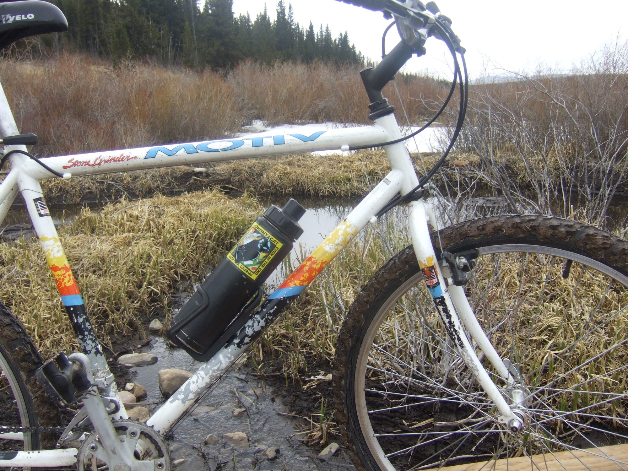

Got the Motive Stone Grinder fully complete and working good with gears and brakes on budget say 107 or so FMV in parts all salvage thaI paid $0 for only paid 22 cents for a washer out of pocket. Pretty boring final build MTB hard frame old school Thumbies and simple 2x7 compact gearing it doe6s ride good and actually curbs at a respectable just under 26lbs. Took it on a nice long ride up to Pike forest 20 miles or so round trip to complete the 100 for the clunketer challenge with no issues troubles only one bad clunky miss shift which I will attribute to user error.
Had to have at least one unofficial sponsor promo sticker on the bike being a competition. So I went with Johny Cat Even in the End on the bottle which actually goes pretty with the bike.
