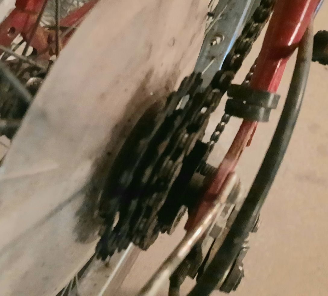

Today I replaced the chain and rear derailleur cable on a 72 Schwinn Suburban. Everything works good, however the cable seems to be a little taunt and tight on the large sprockets but on the small sprockets it seems good or just a little loose. My question is how tight is that cable supposed to be? I'm trying to go off my memory of 45 years ago when I owned another Schwinn. Thank you

Is there an issue? The cable gains tension, or is shortened, rather, as you shift up the cassette which enables you to shift gears, that's why you move the gear lever...

With friction shift levers how tight the cable is is less important then with current indexed stuff. As long as the lever pulls enough cable for the der (ft or rr) to move enough for the cogs/rings on the bike all else is preference. Personally I liked the lever to start pulling cable right away, others didn't mind a bit of lever travel that only took up cable slack before shifting. Your choice. Andy

Thanks Andy this makes a lot of sense to me, I don't think I'll be worried about it anymore

Progressively tighter on all of the cogs or does it just seem too tight on the biggest one? If it's the latter, my guess is that a 1/4 turn on the low limit screw will fix it.

It seems like it's only on the biggest COG, so I will try the quarter turn thank you very much.

imo the cable should be quite tight, with no slack at any point. I call it “guitar string tight”, although that’s a slight exaggeration

Okay thank you I think I'll make one more adjustment on it see if I can get it tight on the small sprockets

It is possible that you have a bit of binding or excess friction somewhere in the path of that cable, either from worn housing/liner, a funny bend or a cable guide. If the cable isn’t pulling freely, you can get a bit too much tension. Difficult to tell without seeing the bike.

Be careful there, if you back off the limit screw a bit too much the chain could derail, jam between the cog and the spokes and cause major damage.

You do know that backing out that limit screw will send the derailleur into the spokes if you turn it just a hair too far, right? This sounds to me like a case of, “It ain’t broke, but I’m gonna keep fixin’ it until something does break.” If the chain goes onto the biggest sprocket promptly without extra-hard pulling on the shift lever to get it to go and doesn’t rattle, and doesn’t drop onto the next sprocket, the derailer stop screw is fine. Don’t touch it until you know more about what you are doing. The cable has to become more taut as it goes to lower gears because it is pulling against the derailer ‘s return spring. The farther you pull it, the more tension.

It ain't broke but I'm going to keep fixing, love that quote. At first I was going to try and adjust the derailer screw, but I'm going to leave it alone for now. Thanks
