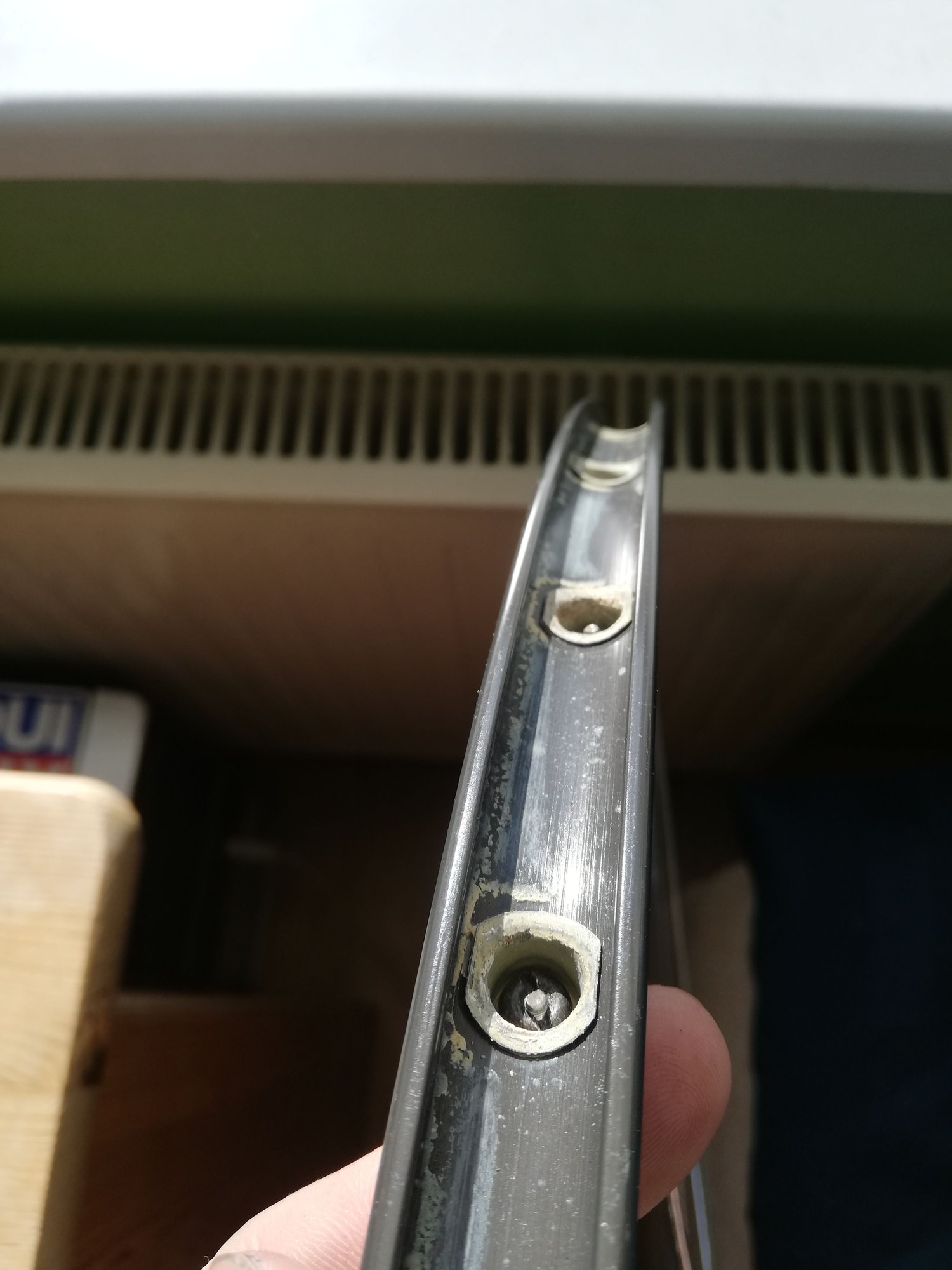

Just built my first wheel with some spokes that i had laying around, they ended up a bit long, these should be changed/ground down right?
#55
Join Date: Feb 2020
Posts: 2,820
Mentioned: 49 Post(s)
Quoted: 1106 Post(s)
Liked 1,328 Times
784 Posts
Grinding them down in situ would be challenging.
Yes they should be changed - you need the practice.

Pretty good results for spokes you just had lying around. Well done.
Just be careful: The rim strip will deform slightly into the grommets when the tube is inflated. (With a cloth rim tape you can see the persisting dimpling when you remove the tube.). Sometimes the tube can herniate just far enough into the dimple to contact the spoke end. Even through the interposed rim strip this can puncture the tube if you hit a bump just right. It can be an infuriatingly obscure cause of punctures.
Suggest you use a cloth rim strip for better padding if you have any doubt about how much clearance you have in there. If you have to use plastic strip to get the tire to go on, consider this cause if you get punctures on the rim side of the tube over a spoke hole. A fix would be to place nipple washers under each nipple to bring the head of the nipple up to the end of the spoke. I’ve never had to do this but I imagine it’s easier and cheaper than relacing the wheel with new, shorter spokes.
Do this only if you get punctures. It’s probably fine.
Likes For conspiratemus1:
#58
Join Date: Feb 2020
Posts: 2,820
Liked 1,328 Times
784 Posts
a) he'd need 3 or more washers each to get the nipples far enough away to hide the spoke ends;
b) normal nipple washers won't fit in the eyelet socket; and
c) taking each spoke off to get the washers on the nipple and putting the whole fiddly arangement back would be more work than just taking each spoke off and replacing it with a shorter one.
